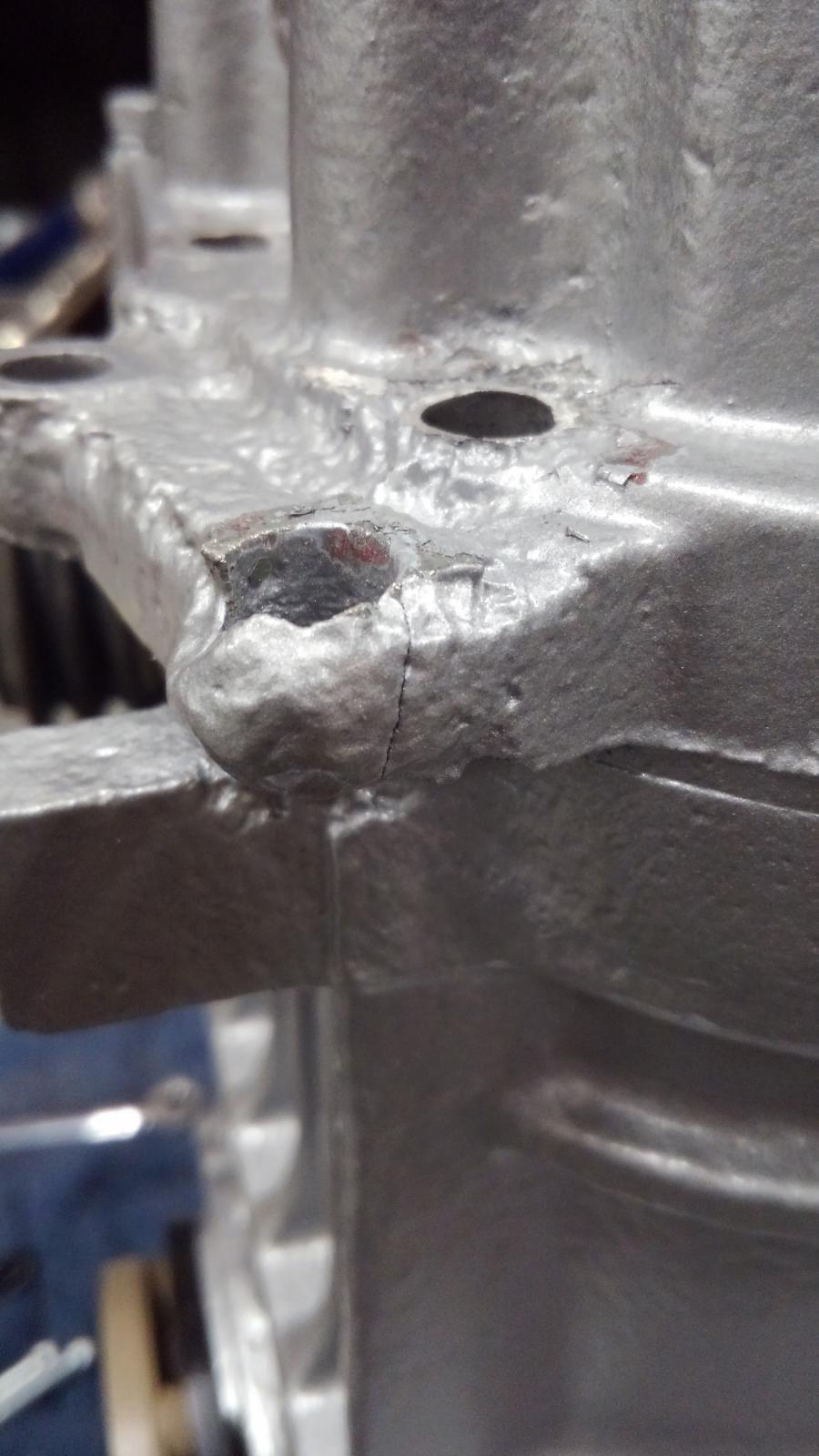

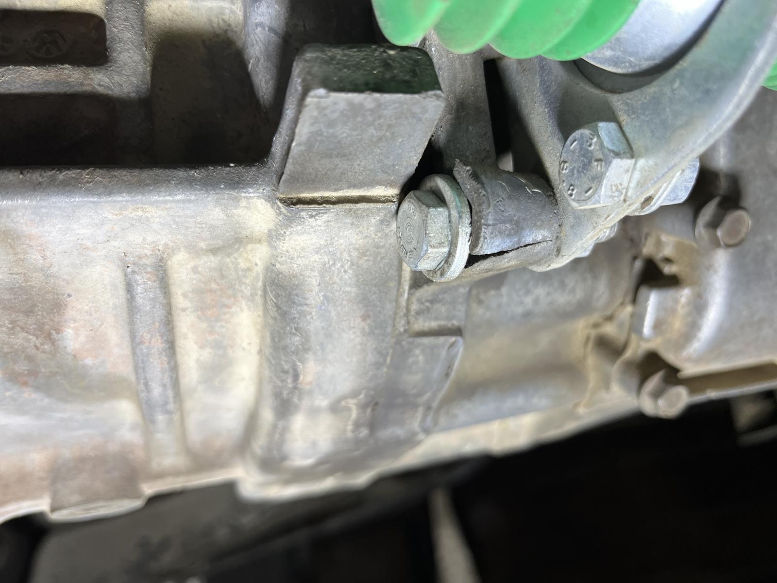

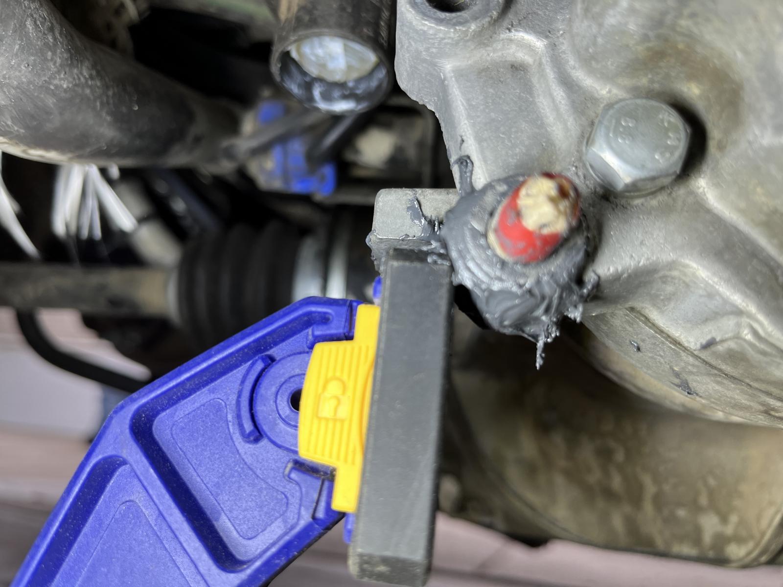

Maybe check your shift ball and socket at the transmission, it’s an easy check. You will want to drop the elbow so you can inspect it for wear, it can get wallowed out.
Also the shift tabs wear and need maintenance. The kit isn’t too pricey and is easy. I’d start with the easily accessed and serviceable parts first.
On my 85’ the shift ball and socket were worn and causing similar issues. I used JB weld to fill in the worn out socket and it’s been loads better ever since. One day I’ll replace it.

Hi all, thanks for the suggestions. The van has about 186k miles, so lots of things are pretty worn on it.
I have tried the bracket adjustment, and it had no effect, but I can try a bit more. Also, I have replaced the shifter tabs (forgot to mention that), and that also had no effect.
I’ll try pushing down on the shifter a little when I’m experiencing the issue and see if that helps. I’ll also check out the shifter ball and socket, which is definitely something I have not looked at.
