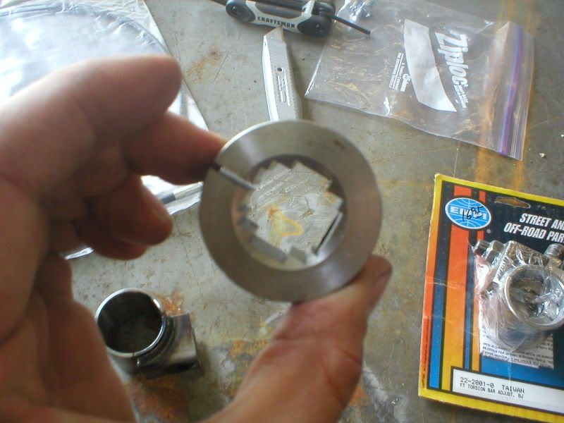

for starters this is the adjuster

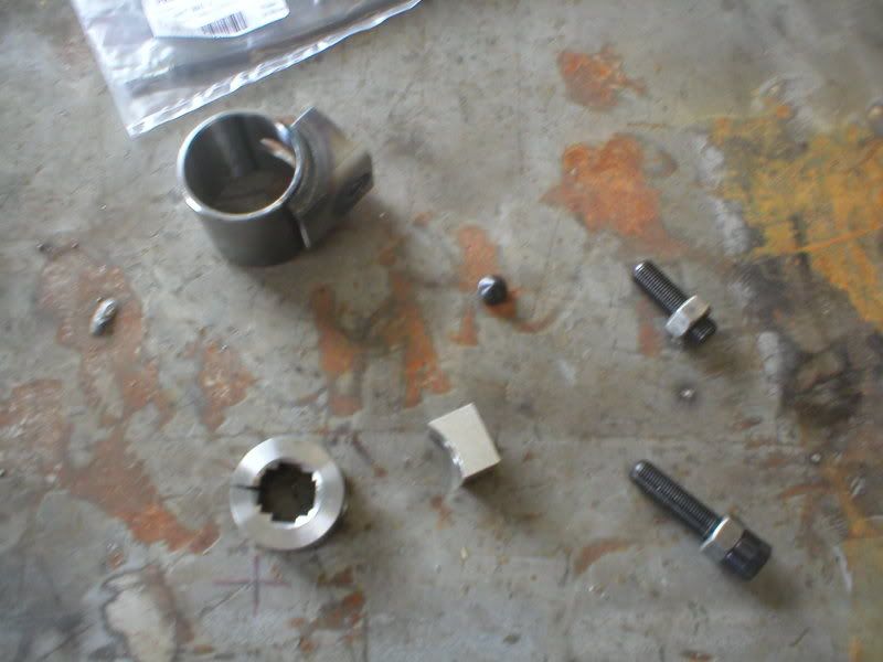

this is the main piece that you will be welding into the beam, its just a new center section thats clearanced to allow for movement.
this is the aluminum clamp thats one of 2 pieces that work to hold the torsions in place while your off roding
this is the center piece that pivots in the center piece, its what changes the angle of the torsions.
this bolt is to clamp the pivot point to the torsions and to hold the nut that tightens down onto the aluminum clamp.
and this is the final piece, the actual adjustment screw that you use to keep the pre-load from just moving that clamp all the way down. and so you can turn the front end up even with weight on it.

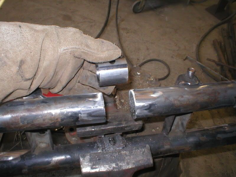

now at this point im going to assume you have your beam off and broken down to just the bare beam. at this point i recommend cleaning it up a little bit. these things tend to pick up a lot of road tar and dirt and fluids from old steering boxes and brakes and what not, so a good wire brush on a grinder will take most of it off. and a hand wire brush will get in the cracks and smaller areas you cant reach. i also took off some thick tar with a paddle wheel, i then used the same paddle wheel to clean the area i would be welding on better and i used it to get a nice clean welding area along the shock tower seams.
now the first thing i would do at this point (because its clean and because you've got the welder out) is to trigger weld the seams all the way around the shock towers, this is not necessary but its a good thing to do if you plan on any heavy off roding, these have a tendency to split and i myself would rather weld them now while the metal is bare and all the stuff is out.
you don't need a big weld just decent penetration to make sure that you get it together.
don't worry if the welds are kind of bubblegumed and not perfect its a hard place to weld, you can grind these down a little bit to clean it up.
now at this point you can start on the adjusters or do what i did and weld in gussets to the towers for some more beam prep.
Adjusters:
when starting the adjusters you want to only do one at a time to make sure the beam stays aligned. so you can do this on a table, the floor or in a vice like i did, just get the beam accessible and then hold up the main adjuster piece and line up the middle with where the grub nut is on the beam and mark either side. with a sharpie and then cut.
for cutting i would recommend a pipe cutter it will work the best but i dident have one so i used a sawz-all and you could also use a chop saw or grinder with a cutting wheel (just make sure you cut "inside" your marks) remember that its better to have to much than to little, you can always take more off if the adjust dosent fit the first time. but you just want a tiny bit of space on both sides for the weld.

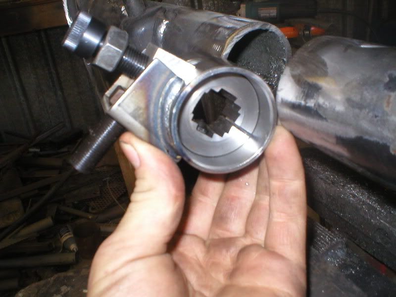

now this is the part ive sensed people having a problem with. the angle of installation.
here in this picture if you look inside the main body of the adjuster you can see the pivot point. on the pivot point on the bottom is a grub nut that will hold the piece on the torsions when you install them into the beam with it on them. you want this to be at almost the same placement as the factory grub nut which is almost on the bottom of the beam. because being put there will allow the torsions when installed to give the trailing arms factory angle so you have a starting point to either lower or raise the front end.
its kind of hard to see, bottom left sticking out of the aluminum pivot point.
no to raise you want that grub nut in the stock place and you want to unscrew the adjusting bolt all the way out and move it up to where it meets the bolt that holds the pivot point insertion in place
like this
this allows for the front end to start at stock and you to utilize all 3inches of possible lift/ pre-load.
now if you were to install the adjusters to lower the car you would do this
the adjusting bolt turned all the way in and the grub nut in the stock position and the main body moved up to it, so it starts at stock and instead of screwing in to adjust you would screw out so that it would start at stock and work its way down.

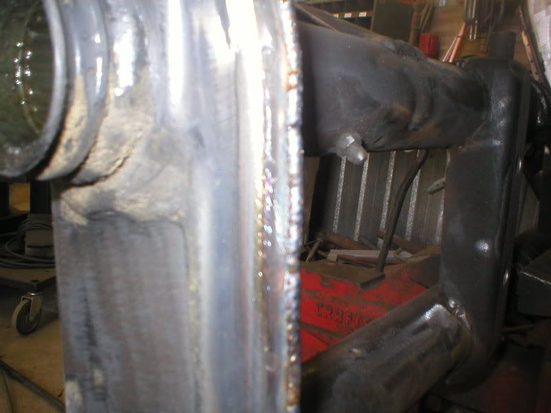

now once your sure of where it goes hold it in place and mark it with a sharpie. just a line on each side going from beam over the gap to the adjuster so you have a reference. then dismantle the adjuster so that you just have the main body, put it in the gap and line it up with your marks and weld it in. start with just a tack on one side so you can make sure it will line up then tack the other side and then do the same on the back side a few times, then finish the weld
now once that one is welded in and cooled down a little bit flip the beam over and repeat on the other tube. and the only thing you have to do this time is just make sure that you get it at the same angle that you installed the first one.
and your finished!

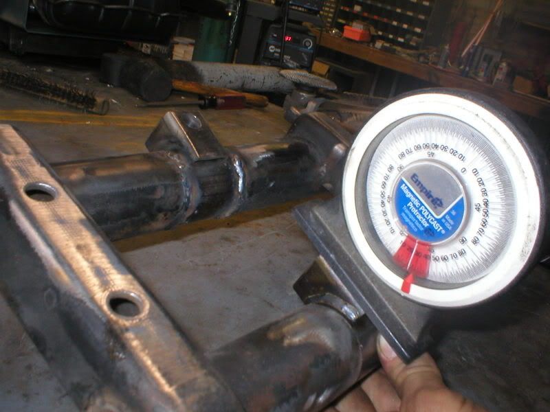

On a ball joint beam they are not installed at the same angle as in this picture.

right. if you were to look at a fully assembled stock beam, you would notice that the arms are not parallel. if they were, then yes, you would install the adjusters at the same angle to eachother. However, turning the lower adjuster screw just a little bit further than the upper adjuster will accomplish the same thing.
another note i would like to add, is that since the adjuster bodies are made out of a standard steel tubing with that weld going down the inside, i always take the time with a small grinder to clean up the inside and make sure that aluminum pivot piece rotates freely.
Also, do not forget to clean the metal shavings out of your beam once the center is removed add more grease to the beam once you've finished your installation.

One point and maybe I just did not see it in tutorial is to scribe a line along beam (horizontally) at center of grub screw (before cut) .... It is simply a line of reference so you can orient grub screw (in adjuster) to same location as "stock" grub screw.... this will also assist in determining if you are getting a lower position ( most of oval opening in adjuster tube below line) or a raised position (most of oval opening in adjuster tube above line). This only works for K&L front end....
