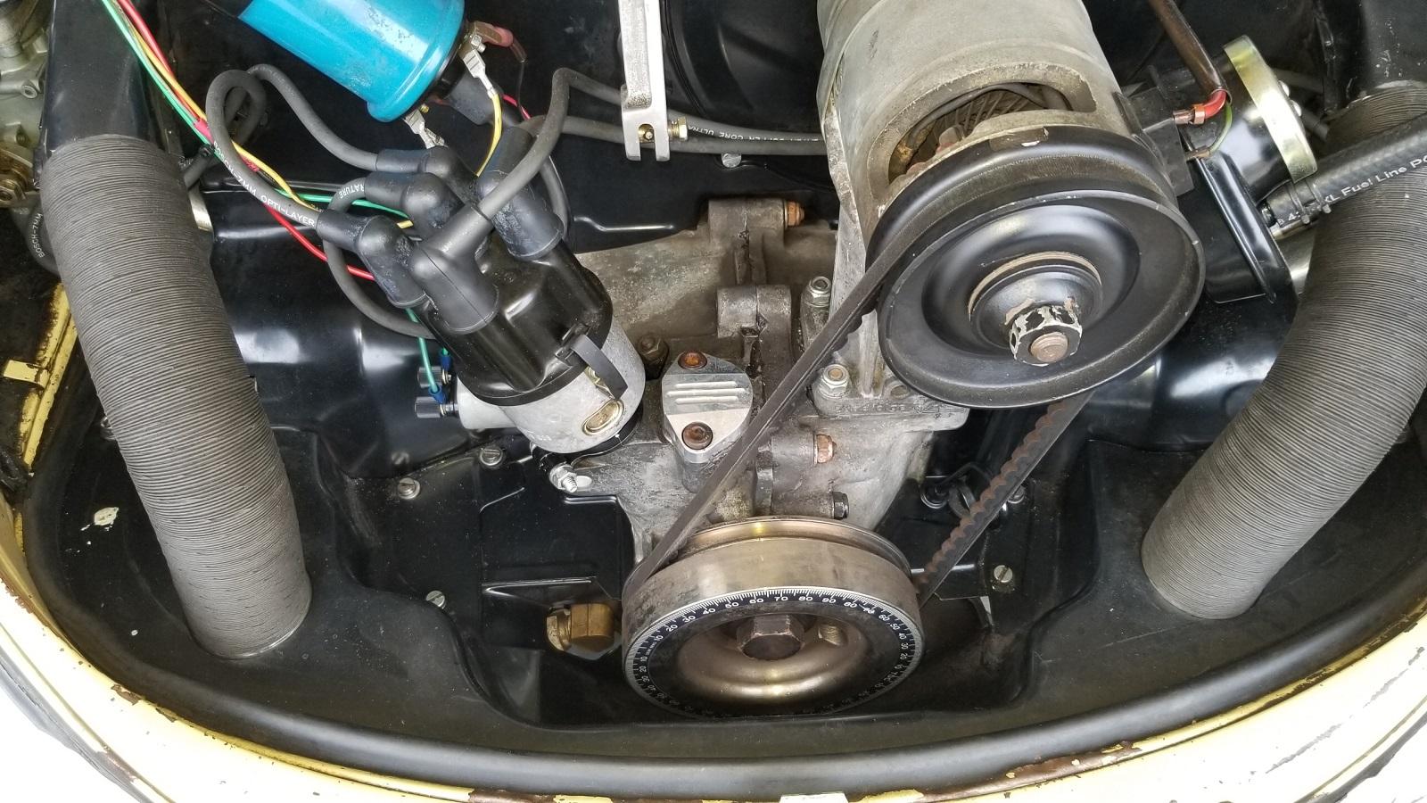

dennismcd707 Premium Member
Joined: October 09, 2017
Posts: 551
Location: Burbs of Detroit
dennismcd707 is offline
PostPosted: Thu Feb 27, 2025 6:01 am    Post subject: Re: Berg Achiever/Equilizer pulleys Reply with quote
The previous owner of my 71 SB built the 1776 engine that powers it. Among the many changes he made to the stock configuration, was using the Bene Berg Equalizer pulley. I can't speak to any "before and after" improvements, but it looks nice, even after 20 years. This engine is capable of some higher than normal RPM's, so maybe his choice of pulleys has something to do with that.
1971 Super Beetle, 1776, dual Weber's, roller crank, modified large valve heads on match ported intakes, 9.2 to 1 compression, close ratio trans, lowered suspension, 4 wheel disc brakes, truss bar and other goodies. Car has over 370,000 actual miles, and counting. (RIP 1970 Beetle/Baja, 1986 GTI, 1999 Jetta, 2002 Jetta)
