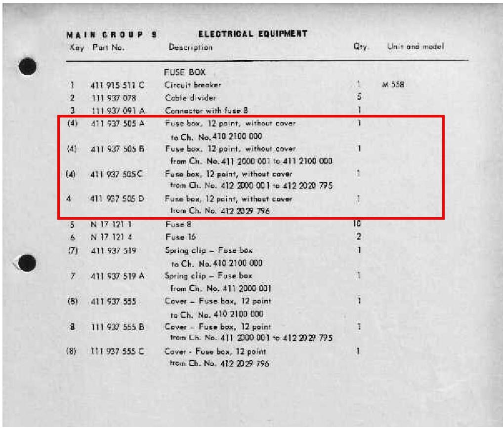

Here are the fuse box numbers and what they fit:
Each year has a different suffix letter:
70 bus = 411 937 505 A
71 bus = 411 937 505 B
72 bus = 411 937 505 C
and if you are wondering about D and E:
73 411 = 411 937 505 D
74 412 = 411 937 505 E

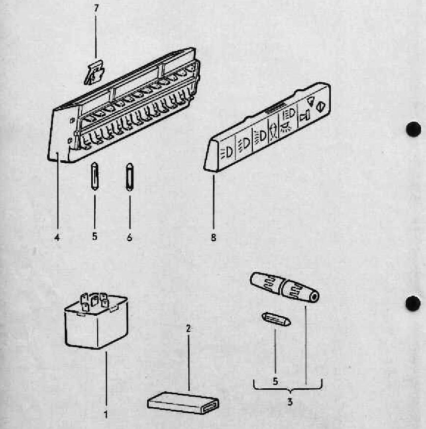

By the way for those looking for this part....if you have good local salvage yards with a selection of VW's....this was ORIGINALLY a VW 411 and 412 part...hence the 411 part # prefix. You could scrounge one from a 411 most probably.
They were in use from 1968. A few year before the bay bus existed.
There are four versions of it, most of which have subtle differences in pin placing for earlier and later relay body types. Most later versions could be made to work pretty easily. They were used from 1968 to 1975 in 411 and 412 cars
There are two 411 937 505 D on Ebay right now
https://www.ebay.com/itm/403249412322?chn=ps&n...qIQAvD_BwE
https://www.ebay.com/itm/403244424322?chn=ps&n...ikQAvD_BwE
There is a 411 937 505 C on ebay right now
https://www.ebay.com/itm/403041487525?chn=ps&n...CsQAvD_BwE
This is good post about the differences in each year and where they were used on the original vehicles.
http://www.type2.com/library/electrip/fusebox.htm
I like that the person who posted this makes note of the material changes. The early ones were nylon 6 which had issues with age and moisture absorption (the yellowish looking plastic) and the later ones were Nylon 6.6,,,the whiter looking plastic.
