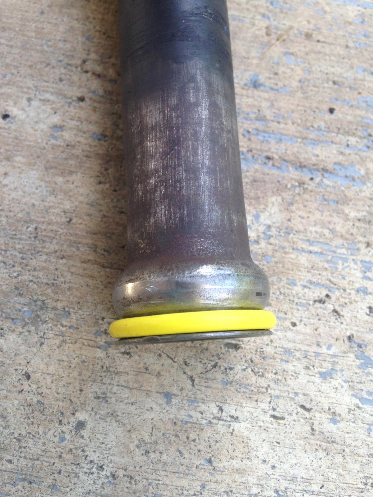

My original was yellow and I just picked one up locally for $1.80 and its yellow too. The black one sounds bogus. Good luck. Part # N.028.225.2

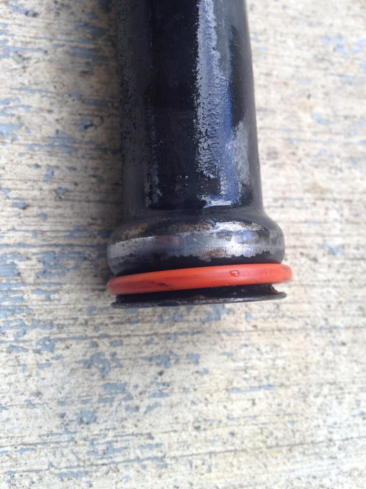

So when I replaced my yellow o ring yesterday I noticed a couple things. First the coolant cross over tube came out way to easy. I removed only the two allen bolts and pulled and guided the tube out. This is an orange o ring that came with a seal kit or I sourced locally when I did the rebuild a couple years ago. I made a mistake. It is sloppy and loose now after 2 years.
This is the new one large and tight.Go with the Part # N.028.225.2
