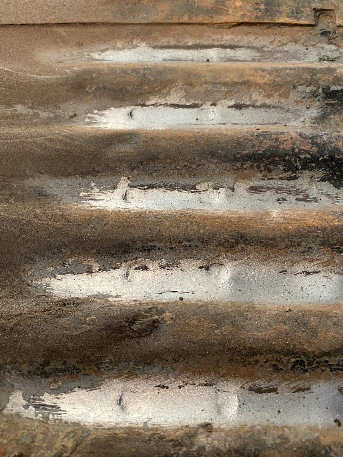

Figured I might as well document my process and hopefully be the thread I wish I could have found in my searches! On another note, it'll likely serve as some kind of motivational accountability for me to keep the project moving along...
Floor has some significant holes in each corner that are equally reflective of the condition of the outriggers and jack points under each hole. While one could argue I could just patch the corners, I figured I might as well replace the whole thing. Additionally, I suspect this will make replacement of the structure under the floor a little easier.
I've opted to drill out as many spot welds as I can locate and go from there, versus air chisel. My only real rationale being that localized work on each spot weld will likely have less collateral damage on the associated surfaces as I move along. Might change my mind later, depending on my patience...
Decided to start with one of the cross members as it would seem a pretty straight forward line of spot welds to address as I wrapped my brain around the actual process.
First step was the location of the welds themselves. A little bit of time with a wire wheel on a drill motor seemed to work nicely.
Next, I dimpled each spot weld with a hammer and punch. These served as a starting point for drilling shallow divots that would serve as pilot holes for the spot weld removal bit.
Let the weld drilling begin! Using the Harbor Freight bits at $4.99 each. The learning curve was not nice to these bits, and my first 70 or so welds cost me 3 bits. $15.00 in lessons learned should pay dividends as I move forward. A drop of oil on each weld and patience should go a long way.
Took me a little more than an hour to do the length of one cross member. 4 or 5 more of those to go, I think. Towards the end of the line, I got to where I could sense the tone of the drill motor change as I got through the floor metal. Addionally, often I would see the color of the steel shavings change as I got to the underside of the floor/cross member connection as some dirt/rust would start to surface.
Guess that's it for now. Will keep working the remaining cross members, and then start moving on to the vertical "tabs" that attach the floor to the sides, bulkhead, cargo door threshold, etc... I suspect they'll present a bit more of a challenge than the cross members, but we'll see.
For the record, my goal is to do as little body work to the bus as possible, in order to preserve the patina'd look. It's still in the original colors the original owner ordered it in, and I absolutely love the way her appearance tells her stories. All the new metal I'll be putting in will realistically be unseen, but I want a strong floor/under floor structure as I plan on building a camper interior.
More to follow! Comments, encouragement and advice/tips more than welcome!

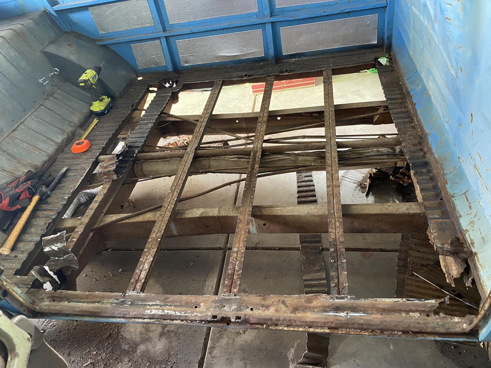

Pretty much no going back now. Gave up on the individual spot weld drilling technique as it was apparent that it would take a very very long time. Per inputs above, I’m cutting out the sections between the cross members, then chiseling/prying the spot welds apart. Working pretty well. Work done in the pic took about an hour and a half.
Wasn’t planning on doing rockers, as I actually like the way she looks, rusty rockers and all, but it seems apparent that when I start replacing outriggers and jack points, I’ll need something solid to weld them to. Guess we’ll see how things look when disassembly is complete and I start building my metal list.
Really appreciate all the inputs so far!

PostPosted: Sun Jan 15, 2023 8:19 am    Post subject: Re: ‘60 Kombi Cargo Floor Removal Reply with quote
Slow progress is still progress…
More of the floor cut out. I’m about at the point where I need to figure out how to get the 4” out along the outer perimeter. Spot welds along the bulkhead and long rocker have me a little perplexed. Also, I’m a little unsure of how the floor/bulkhead/top hat all come together. Need to figure how it all fits together before I can dive into that area to finish the floor removal.
Any pointer from those that have been there/done that are more than welcome!

PostPosted: Sun Jan 15, 2023 9:28 am    Post subject: Re: ‘60 Kombi Cargo Floor Removal Reply with quote
this is the tool I use for buzzing out spot welds quickly and efficiently. I use 60 grit Cubitron belts, be careful as you can grind into the base material very quickly.
not sure if you're on instagram, but if you want to see how to do bus metalwork, check out my work @sledvw
drive your split.

PostPosted: Mon Jan 16, 2023 7:17 pm    Post subject: Re: ‘60 Kombi Cargo Floor Removal Reply with quote
That 1/2” belt sander is my new favorite tool! A small learning curve to avoid going too far too fast, and easily made quick work of the remaining spot welds on the middle top hat. Another afternoon or two and the entire floor should be out!

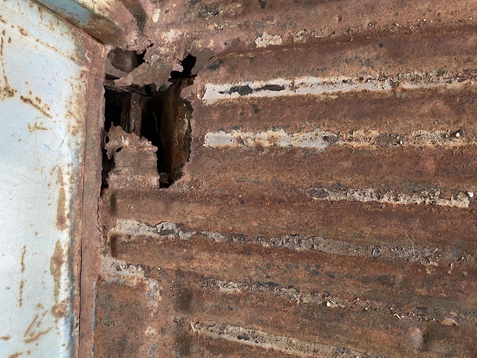

PostPosted: Sun Feb 05, 2023 4:25 pm    Post subject: Re: ‘60 Kombi Cargo Floor Removal Reply with quote
Floor removal is about done and I’ve started my shopping list for metal. Outriggers, top hats, jack points, etc…. Another question for those that have gone down this road before.
I’ve got this rust behind both front wheels.
Is there a replacement part that addresses this area? I’m guessing it’s a commonly addressed area of repair, but couldn’t find a part like the replacement outriggers or rockers to replace this area. I’ve ordered the outrigger, top hat and jack point for this area, but I’m guessing there’s more needed.
Bus is a non-walk through, if it matters.

PostPosted: Mon Feb 06, 2023 2:06 pm    Post subject: Re: ‘60 Kombi Cargo Floor Removal Reply with quote
You should contact Gerson and inquire with him. After all they produce all the sheet metal to make a full bus body.
