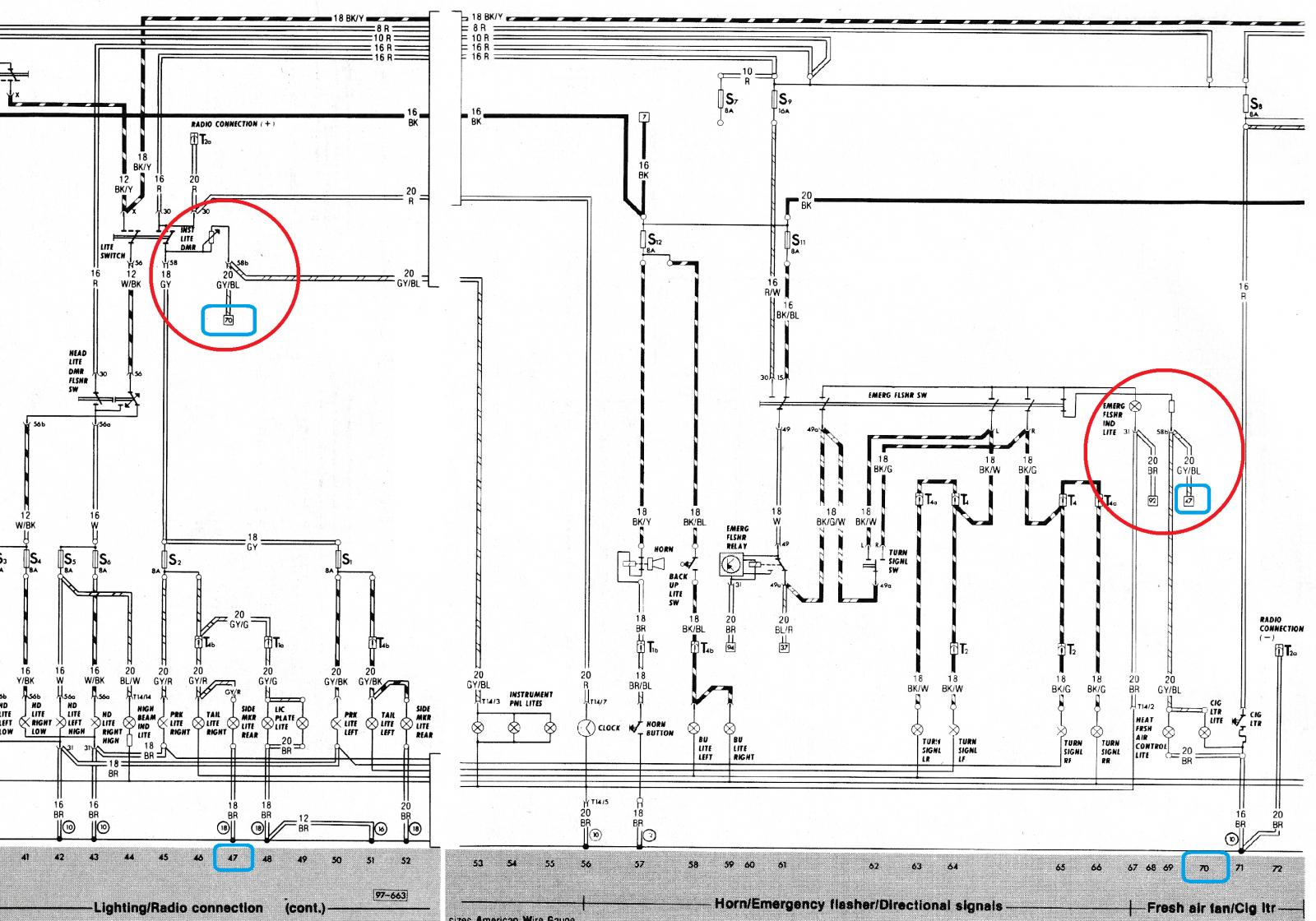

The light switch/instrument panel light resistor has three Grey/Blue wires. One orginates from the #58 spot and it has a grey wire along with it. The grey wire goes to S2 on the fuse panel
The other two grey/blue wire orginates from the 58b location.
In the Bentley it looks like 58 goes through the resistor to 58b. Then it looks like one of those grey/blue wires should go from 58b in the Inst Panel Light Resitor to the T14 connector at the number 3 spot (T14/3). Then there is a grey/blue wires should that goes to track 80.
Track 80 goes to the Emergency flasher warning light to 58b location. However there is no wire in the white connector for a wire to go:

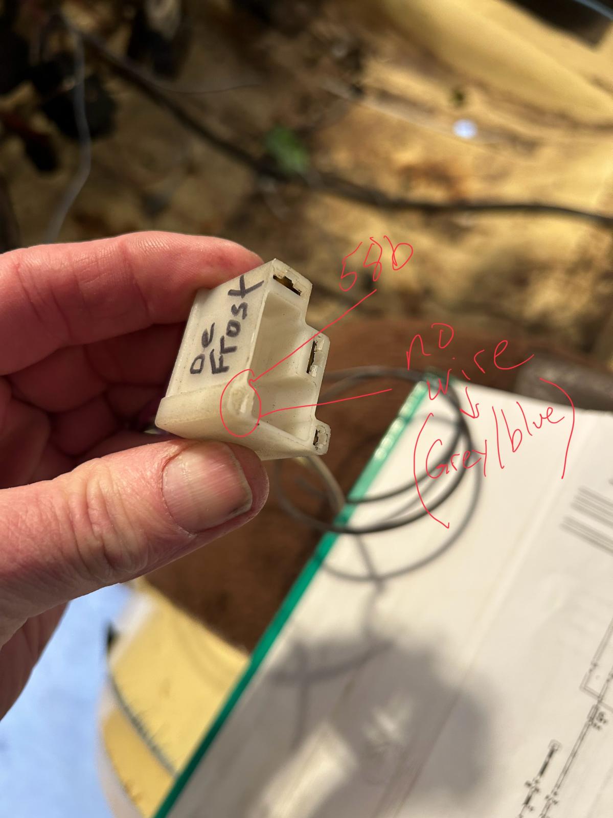

Also the Bentley shows a grey/blue wires to 58b to the rear defog switch however there is no wire in the white connector.
In the Bentley track 80 and 47 are both part of the 58b on the resistors.
The three grey/blue wires that either terminate or initiate at the Inst panel resistor in the first picture is what I have a question on.
How are those wired together with either 58 or 58b track?

The diagram with the 3 leds connected together has a labeling problem.
The words " side marker light-R" should have an arrow pointing up to the left.
Those words apply to the led in circuit track 52 and not to any of the 3 connected leds.
The words wouldn't fit in the empty space they belong in so they were put in a near space instead but the pointing arrow was left out so the result is misleading.

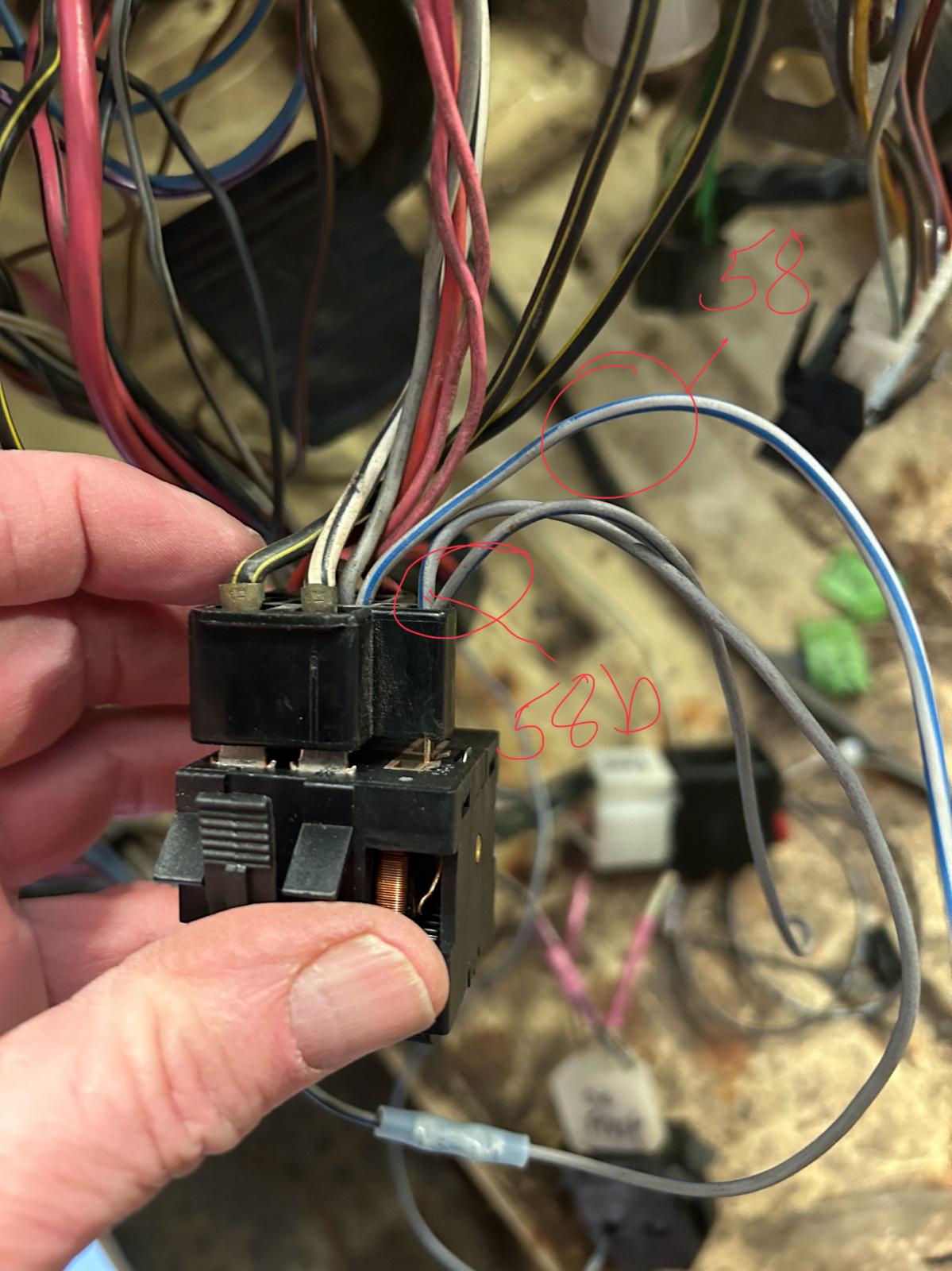

So one of my pictures didn't upload.
Here are the three unconnected wires, all grey/blue, that I am not sure where they should be connected.
It looks like the 58 location should be connected to T14/2 however the other 58b wires I am not sure.

It looks like the one wire you have circled is White/Blue and is not part of the 58b circuit.
The 58 circuit feeds power to the resister that supplies the 58b circuit but otherwise is independent of it.
None of these have anything to do with the emergency flasher lite, when two wires cross in the diagram they are not connected unless there is a dot at the intersection.
I am not sure what the one little gap in the one drawing means????

trihartsfield wrote:
The other two grey/blue wire originates from the 58b location.
The gray/blue wires (58b circuit) are for dash bulbs: Instrument cluster lighting, HVAC fan switch/controls lighting, emergency flasher switch light, rear defroster switch light, auto trans console light(s), cig lighter socket light, etc. These are fed via the dimmer switch-side (aka resistor) of the headlight switch.
Do your rear defrost and flasher switches have bulbs in them? If not, perhaps the early vans came that way from the factory, hence no gray/blue wires at those switches?
I know for sure the emergency switch does and I think the rear defrost does.
So those two wires, grey/blue, do originate from the dimmer that is part of the light switch. They are currently not connected to anything. Where should they be connected? There is a grey/blue wire that is not connected to anything also at the T14/3 position. Is there where they should be connected?
So I know that the Bentley can be wrong however the way I trace those wires the white/blue (grey/blue) wire that is connected along with the grey wire at position 58 looks like the Bentley indicates it is a grey/blue wire. If it is white, and I agree in the picture it does look white/grey, where is it supposed to be attached?
I am not sure what gap in the drawing you are referencing. Could you add the picture/drawing so I can see what you are talking about? Thanks

I know for sure the emergency switch does [have bulbs] and I think the rear defrost does.
Completely overlooked that there are gray/blue wires currently disconnected. Yes; those loose gray/blue wires would slide into the switch sockets (corresponding to the bulbs) using locking spade disconnects, as well as into the 14-pin instrument cluster connector.

The switch pin 58 wire you need is the grey one that turns on the tail lights and running lights when headlight switch is on.
It feeds to the fuse panel for the 2 fuses for left side and right side lights.
The switch pin 58b grey/blue wires are for the dimming adjustable back lighting of the various dash stuff.
I don't know what the second wire, white/blue on your pin 58 is meant for, perhaps unused or added by someone to bypass a burned out dimming rheostat on headlight switch in the past.
Be warned that your year has NO FUSE for the 58b wires and also that white/blue is connect to pin 58 before any fuse and should be treated with extra caution for that reason.

Ok so the defrost switch and the instrument light resistor each have a slot that is labeled 58b (the white plug) do not have a wire/connector. Is that where the each of the blue wires should be attached?
Or do they both get connected to T14/3 connector?
If they get connected to the individual switch then where does the T14/3 wire get connected.

The headlight switch is the power source for the 58b circuit.
All of the gray/blue wires fan out from there to various light bulbs in the dash.
Since there is no fuse it became a known problem in early vans to have melted wires and melted headlight switches if a short to ground occurred on one of the lights.
Starting in 85 Vanagons VW added a fuse to the end of the fuse panel and fed that fuse from headlight switch 58b and then all the wires fan out from the fuse to the various bulbs.
In 86+ vanagons the fuse was mounted to the top of the later fuse panel.
Chris
Chris
The 58 and 58b circuits are not the same even though they are fed by the same contacts in the headlight switch. The 58 circuit DOES NOT go through the dimmer resister, while the 58b circuit does. Unless something is wrong with the marker lights or tail lights don't mess with the wires of the #58 circuit, except to possibly tape off the end of the White/Blue wire if you find it is not being used. The bulb for the emergency flashers is NOT on the dash illumination circuit, the wires just cross on the schematic without being connected electrically.
The gap shows to the left of the emergency flasher bulb in the schematic you posted, I think someone goofed when they drew up the schematic as the switch to the left of the bulb makes no sense as drawn.
Check out the wiring for a 1985 model in the technical section, page #9, current track #43. Maybe print out the page and use a colored pen to separate the 58 and 58b circuits visually to cut down on confusion. There is a weird little place at the switch above the resister where it looks like the #30 and #58b circuits come together, but they do not:
www.thesamba.com/vw/archives/manuals/1985_86_wiring_vanagon/1985_86_Vanagon_Wiring_Diagrams.pdf
Once I get this completely figured out would it be good to either add an inline fuse or send them to a separate fuse panel (which I plan on adding behind the glove box)?
I think that may have been one of the problems. I found several burned wires to include the ground that goes to the emergency flasher switch light ground wire.
Any recommendations would be appreciated.

Post some closeups of the cluster for ID.
Yes, adding an inline fuse to the output of headlight switch pin 58b is a good idea.
Like it shows on the 85 diagram.
(note: 85 diagram is close to what you have except for the T14 pins which may be nearly all wrong numbers if your T14 is still wired for an 82 cluster)
Mark
How would I determine which cluster it has?
As you can probably tell I have the dash out and the cluster in a box.
So if I understand this correctly the best way to wire this would be to send the 58b wires to those extra fuse(s) and then wire from there to the instrument cluster, is that correct?
Chris
The flasher switch bulb?

The circled flasher switch wiring shows the bulb IS connected to the dash illumination circuit coming from headlight switch 58b.
There is a resistor shown to reduce the bulb voltage, then passing through a "normally closed" contact of the switch and on to the bulb to dimly light it.
When the flasher switch is turned on that 58b connection is removed and the bulb instead gets direct full power from the flasher circuit to blink it brightly.
Mark
