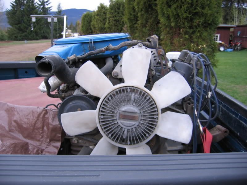

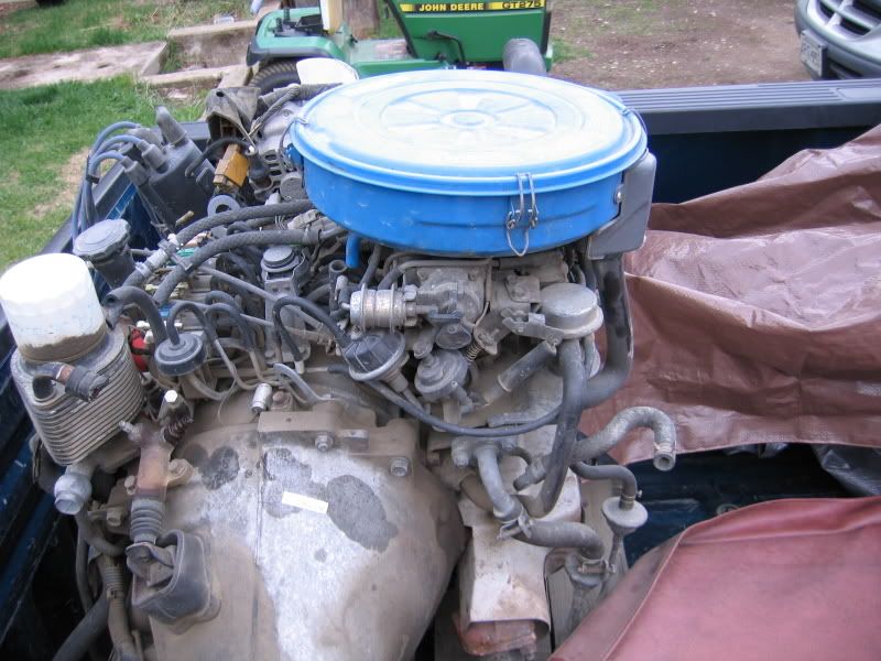

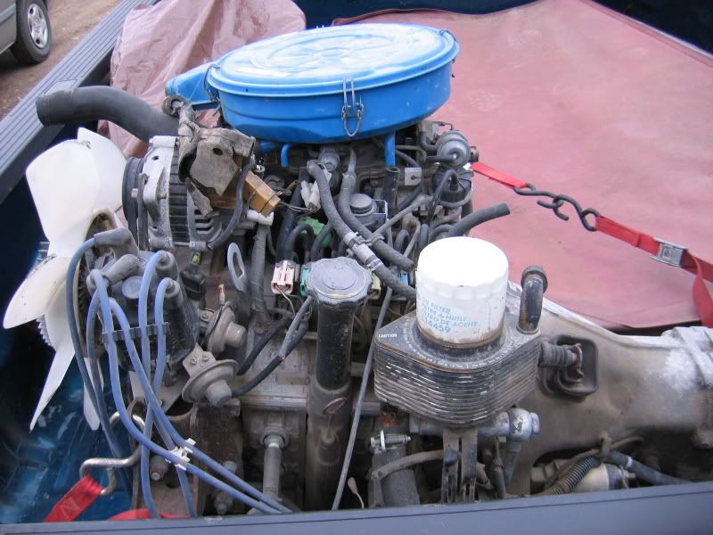

Today marks the start of my Rotary conversion. Went into town and picked up a mazda 12a engine from a wrecker. Guy said that it ran great and it is all complete. I went with the 12a because its carbed and only a couple wires to run.

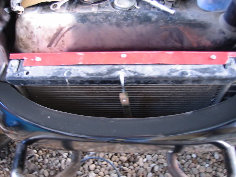

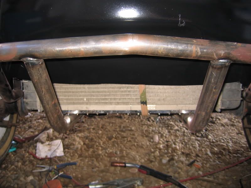

Im not sure my rad will cool the engine though, i guess theres only one way to find out. I will need an oil cooler will I not? Any ways i've still yet to order an adapter but theres still work to be done before im ready for th engine. And a custom exhaust is going to have to be built because i dont want the stock air pump or the thermal reactor.

You've been mislead by the wrecker guy. It looks like an '83-'85 12A. How to tell? It has a beehive oil cooler thing under the oil filter, the distributor is the '81-'85 type with the ignitors on the dizzy housing. It has an exhaust manifold. None of these were on an '80 engine.
Rejoice! You actually have a better engine sitting there. If it is indeed an '83-'85, it has the lightest 12A rotors Mazda produced for the 1st gen RX-7, the distributor is more compact and works better in my opinion, you already HAVE an oil cooler sitting right on the engine. I'd suggest using it because it can turn out better for baja use than an air oil cooler since there will be no need for small electric fans (they're always inadequate), no need to find a good location for it, no need to run custom oil lines; saving money and time, no chance of them getting ripped off while offroading etc. My friend's baja switched from air to a beehive and it works a lot better. I plan to use a beehive on my baja project as well.
I suggest keeping the stock carb and doing a rat's nest removal. Also remove the shutter valve (flapper valve) in the manifold. You'll get the best torque a 12A has to offer. Much better than an aftermarket carb. It's basically free too (just takes time and a little patience, which I'm sure you're full of taking on a project like this hehe). Especially since you don't plan on tearing the engine down for a port job any time soon.
You can either:
A. leave the carb and manifold stock and just remove the rat's nest
B. take the manifold off the engine, seperate the carb from it (much easier off the engine), remove all emissions from the carb, simplify the choke (or remove it completely in your case), swap in a couple slightly larger primary fuel jets (suggest 95 for stock ports), increase accel pump shot and duration, remove shutter valve from manifold, cut channel to mimic other side, remove ACV and replace with a block off plate, block off some of the nipple on the carb spacer while keeping one or two open for PCV (positive crankcase ventilation) and possibly distributor vacuum advance.
I suggest B. Smile For details, read these:

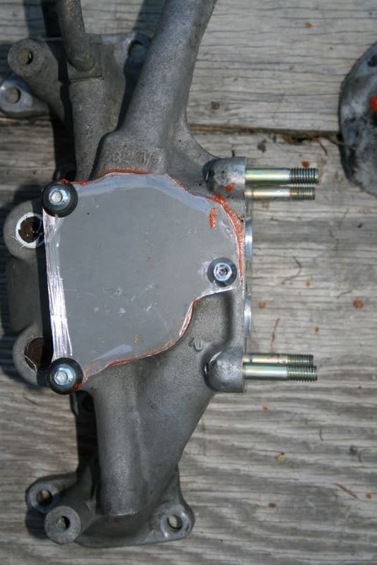

Another rotary tip is to remove the oil injector system, it's inadequate for off road or racing abuse. You will need to make a block off plate for the case, plug the fittings on the carb, and run 2 stroke oil in your fuel. Your seals will last longer this way.

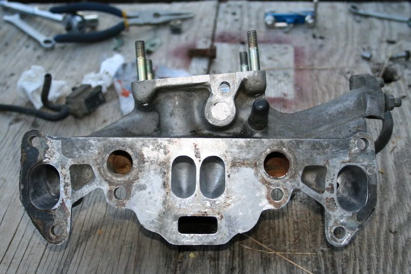

Well the manifold is done! and I cant find my camera to show you guys, damn Mad
Gave the intake a bit of a polish and the block off plate is on. Time to move on to the carb.

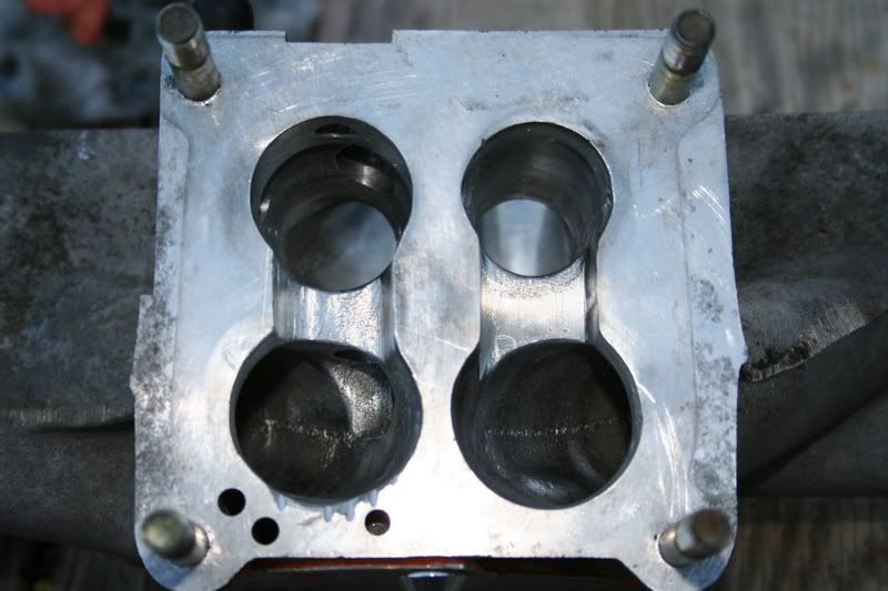

PostPosted: Sun Apr 29, 2007 8:23 pm    Post subject: Reply with quote
Manifold mod done, looks about even.

PostPosted: Mon Apr 30, 2007 10:50 am    Post subject: Reply with quote
That channel looks pretty good! Be sure to leave the runners a little rough. Don't try to smooth the stock sandcasting finish. The little bit of roughness is to help with laminar flow and prevent fuel wetting during quick stabs of the throttle. I hope you didn't try to open up the ends of the runners where they flow into the engine. The slight mismatch is to help with reversion.
The carbs are interesting. Lots of complicated mess on them stock. Be sure to read up on the accelerator pump mod and mechanical secondaries. Those two mods are well worth the effort!
