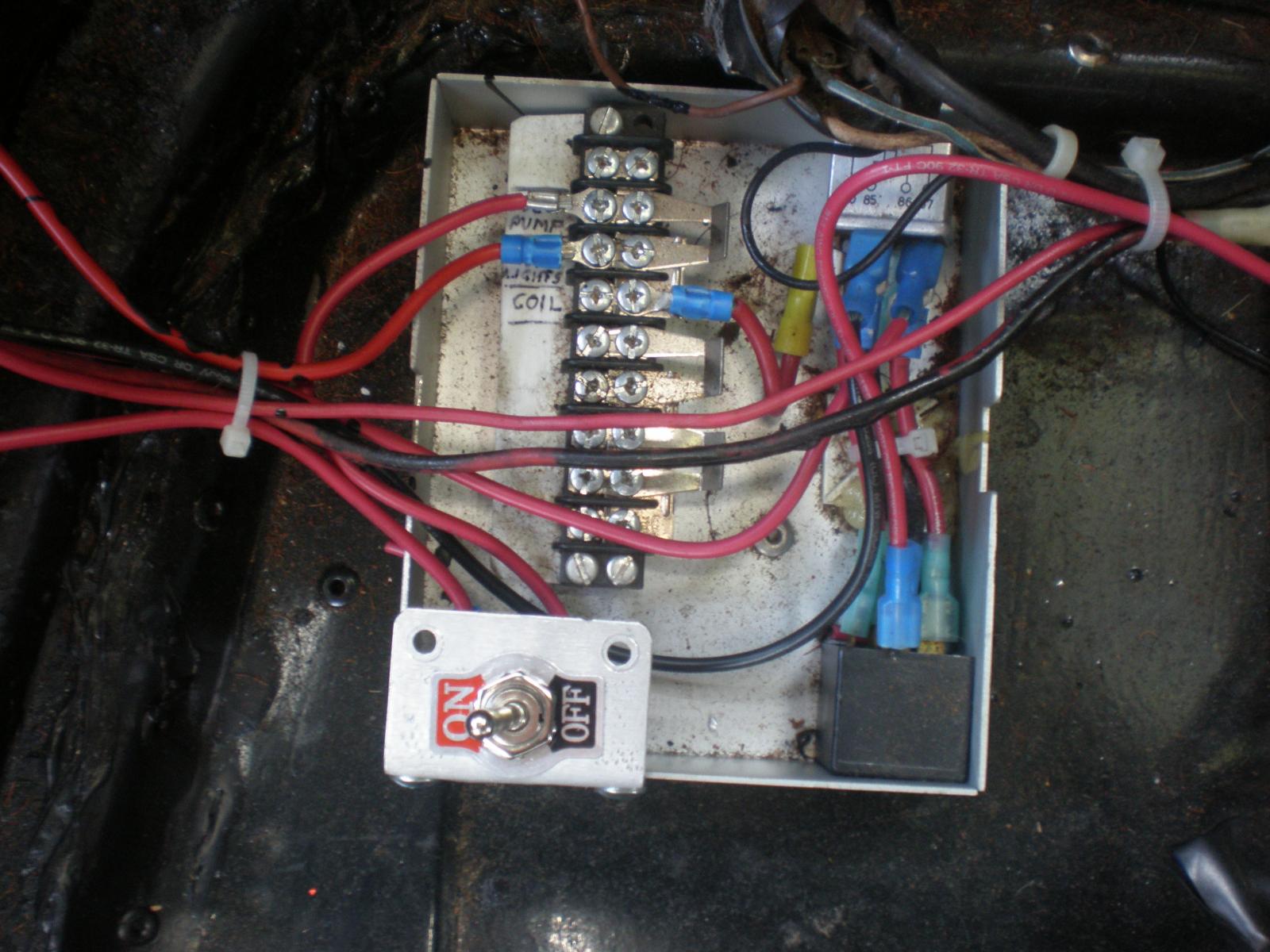

Went through so many carb and and gas lines that and running like crap.
Rich Hunt the carb guy, said Joe put in a steel line and fuel toggle switch cut off.
That was years ago steel gas line in side cabin
If I am not going to run my bug for more then a day I shut the switch and run the engine till it dies , a few minutes
No more problems, also prevents some one stealing the bug.
