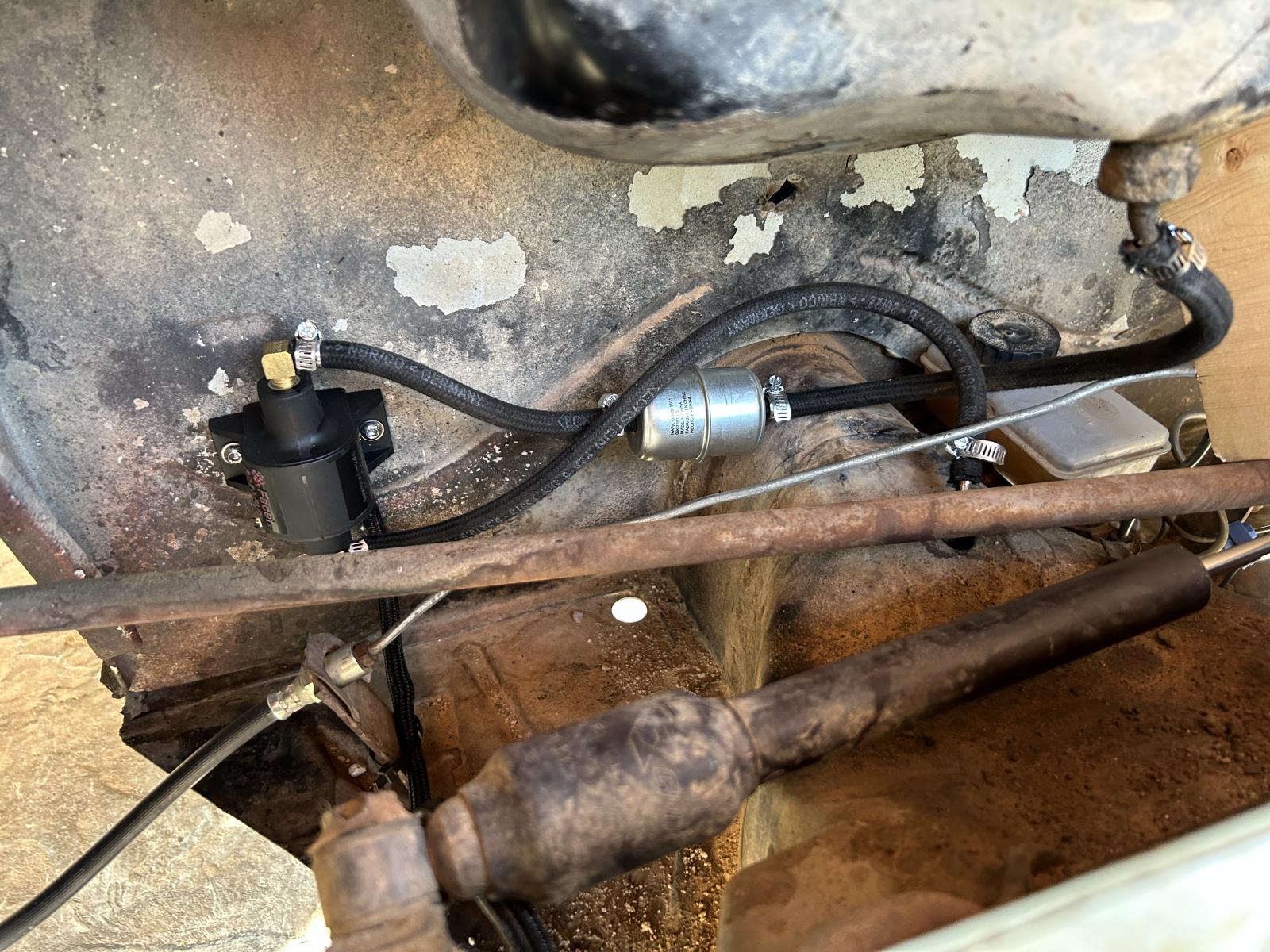

Thanks for all the tips. Tinkering is part of the fun, right 😂. But I think I solved it, I put an auxiliary electric fuel pump in. This is what a local with a baja who has owned a VW shop in town for 40 years recommended and uses on his Baja.
More pics and how I fumbled through it here: https://robonza.com/beetle/index.php/2024/05/25/auxiliary-fuel-pump-for-the-baja-bug/

I swapped to 90° elbows on the pump, swapped in the metal 3031 filter and shortened the hoses. The beetle has been great on the two drives since then.
I changed the oil, added MOA and cleaned the strainer.

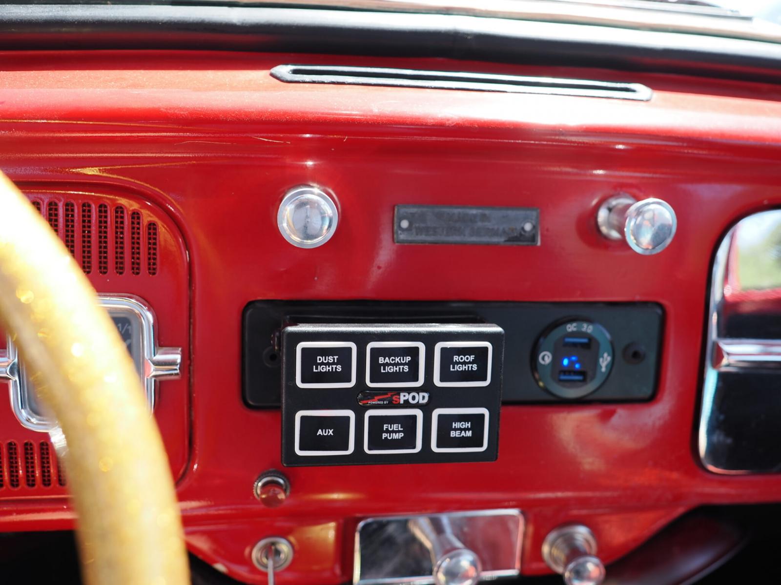

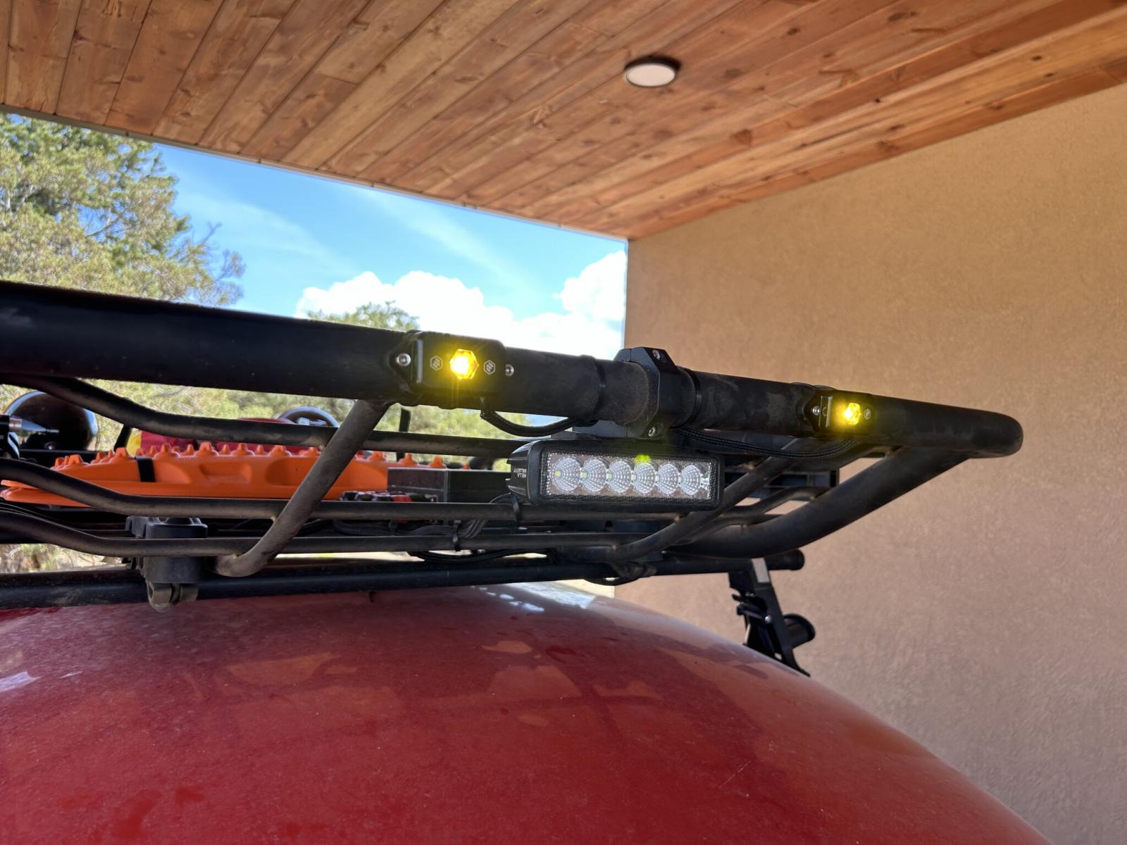

I also added led rock lights on my roof basket to act as emergency flashers. Since they are going through the spod I can run them fully on, flashing or strobe(super fast flash).

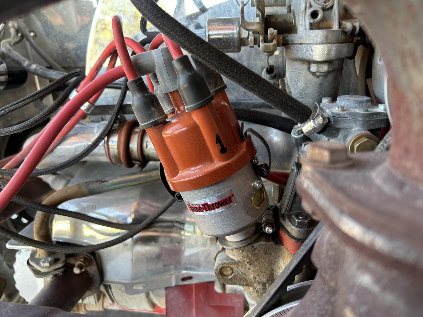

OK today I once again think I might have fixed the hot start issue, could it be a bad distributor? I had a no-name electronic distributor and a no name starter. I replaced them both. I put in a pertronix and a bosch starter. It sounds good to me. Short test drive was good, I need to drive a little further. But hopefully this fixed it. I mean... how many more things can I replace ! It sounds noticeably better now.

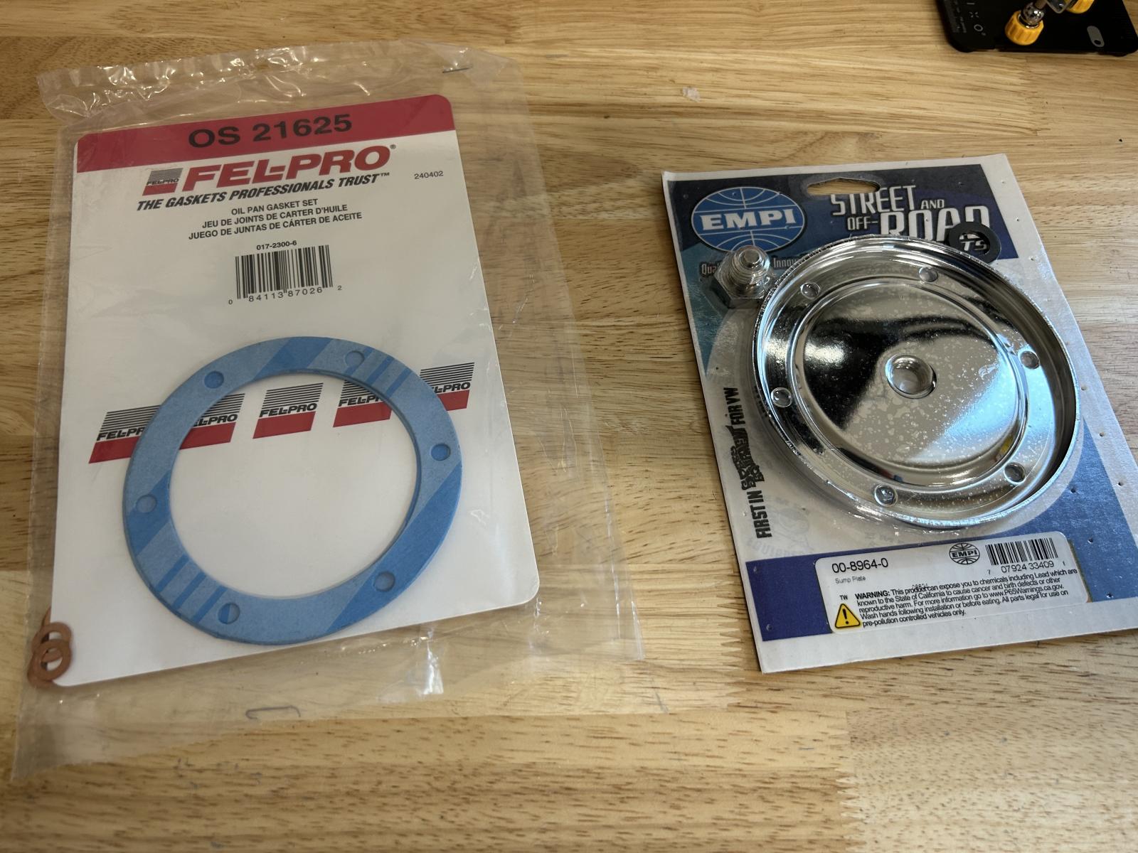

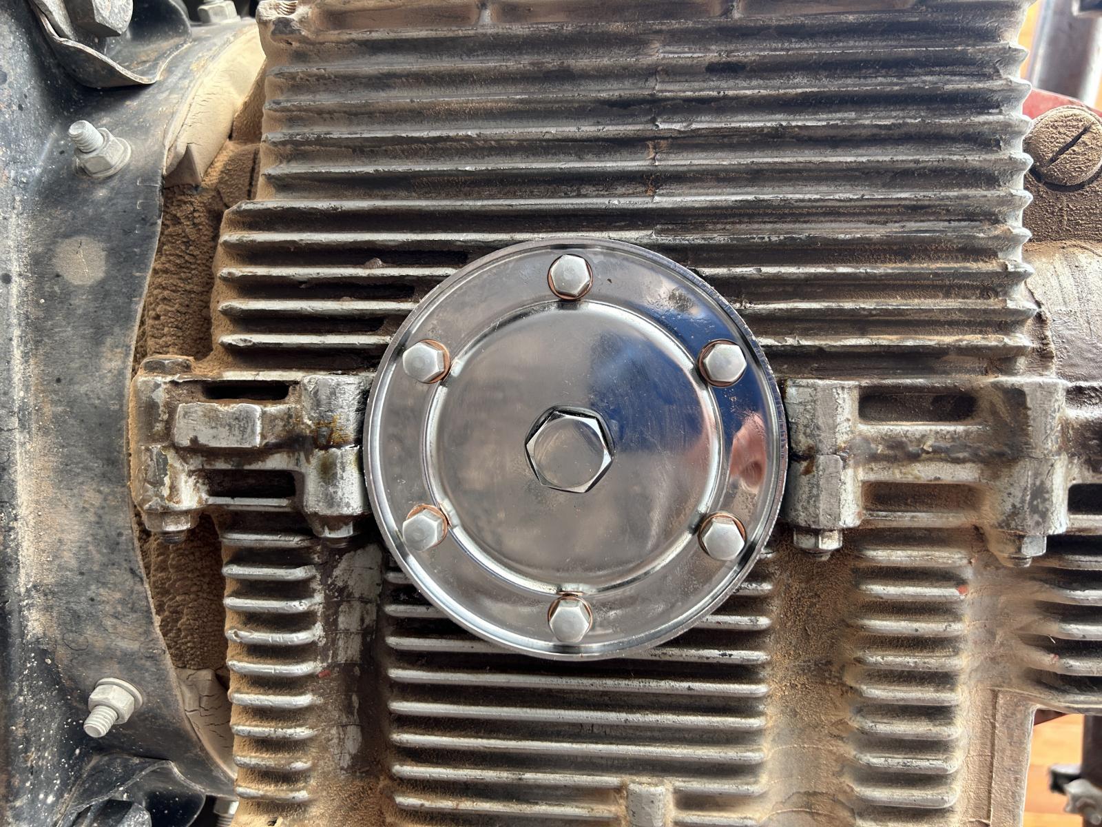

Had to change my oil again, when I put the sump plate back on 50 miles ago it developed a leak. It was warped from age and over tightening. I could have banged it straight, but honestly I didn’t feel like risking a leak still being present. So a new Empi plate and fel-pro gasket.
More pics here : https://robonza.com/beetle/index.php/2024/06/15/leaky-oil-sump-plate/

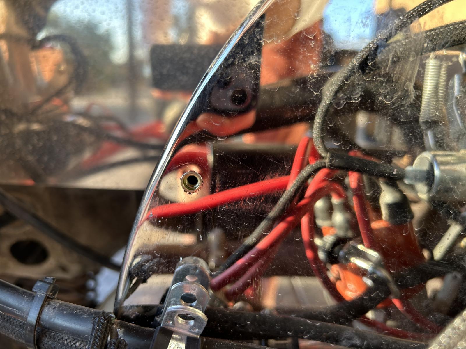

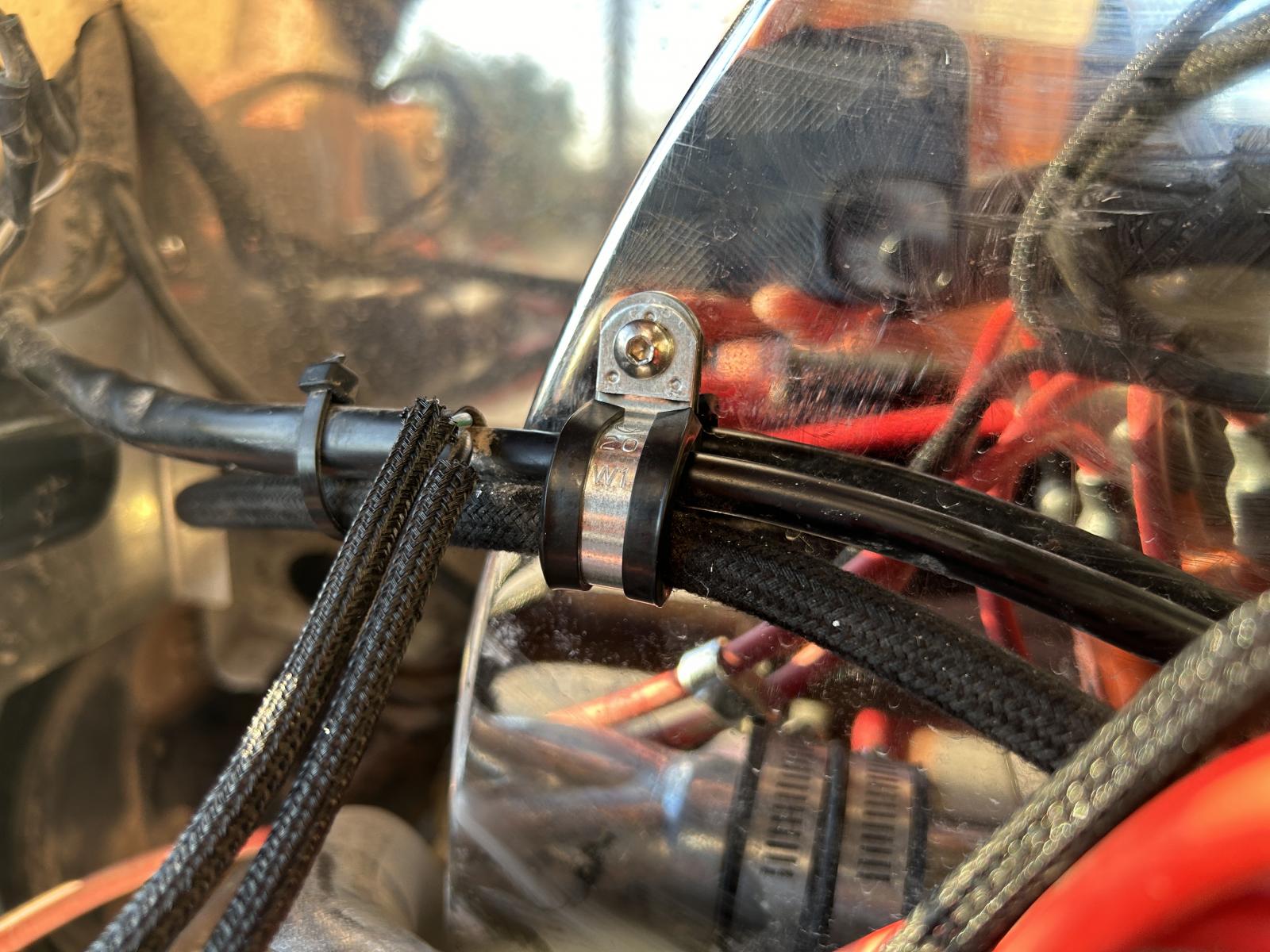

I put a little padded p-clamp on the fan shroud to keep the gas line away from heat sources. I used a nutzert to secure it.

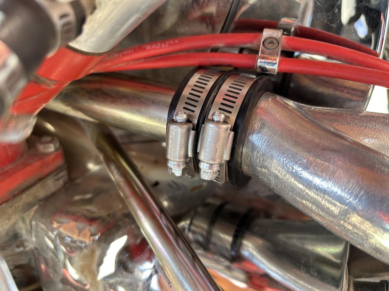

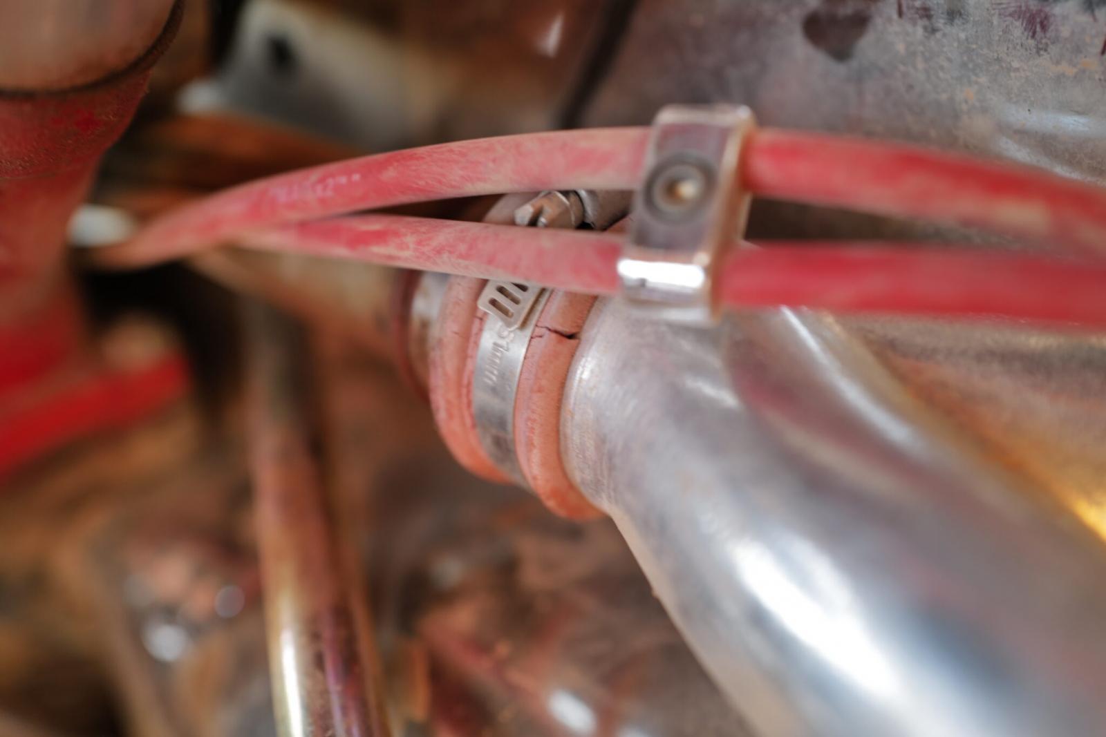

I also replaced my cracking intake boots with the ingenious EMPI split boots. So easy!
-Joe
