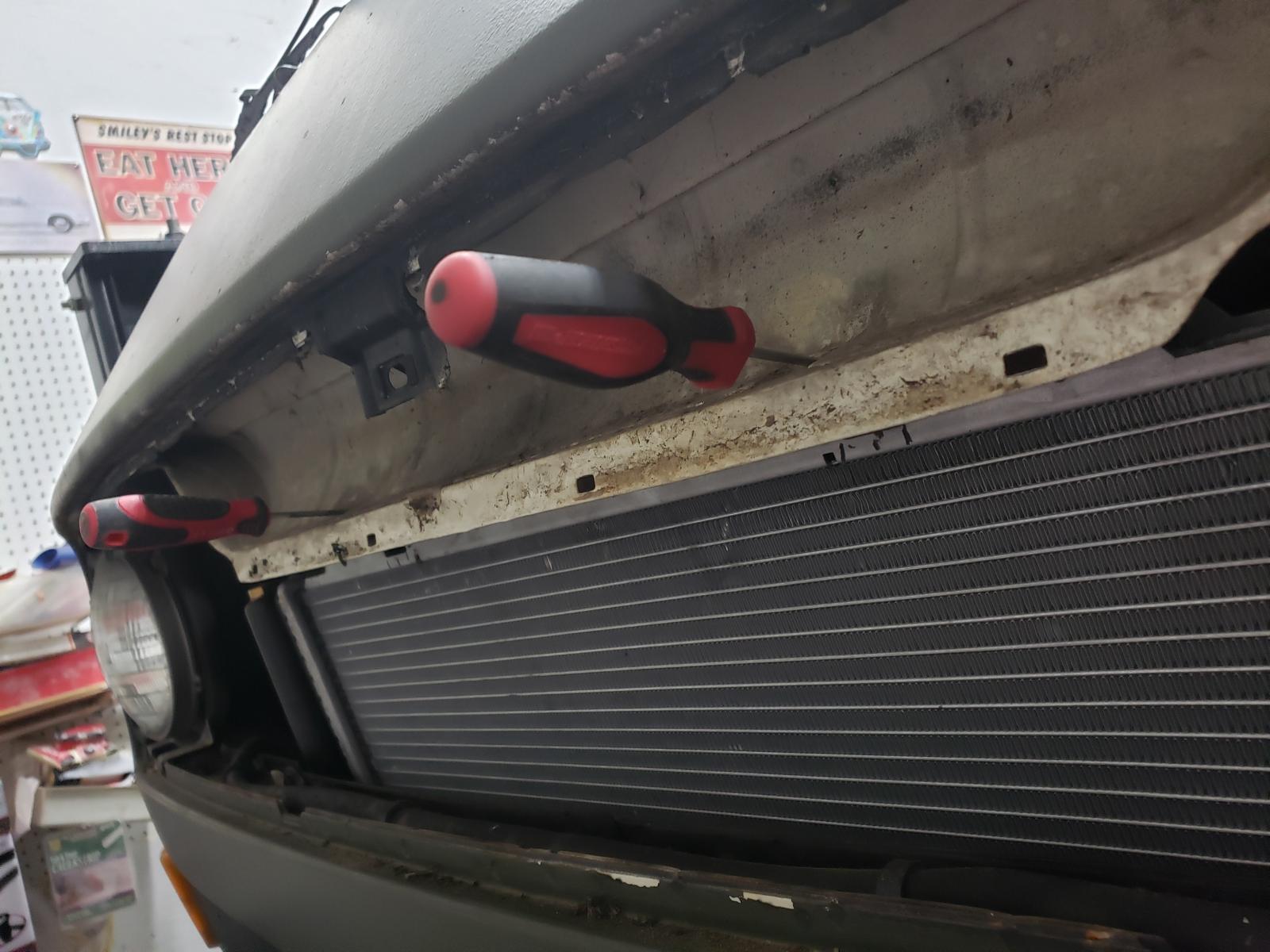

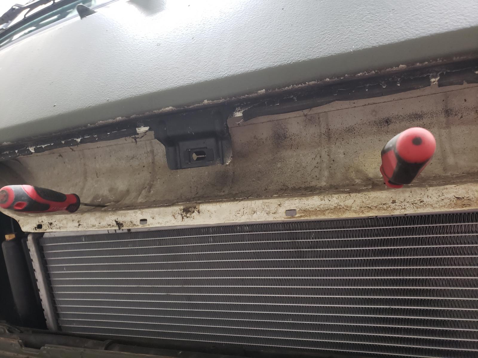

The original diesel radiator had mount s that are inboard of the later mounts. The pics with screwdrivers show the original mounting hole locations. I got a Behr radiator from GoWesty. The upper channel had slots already cut into the front side of the channel right where the diesel mounts go. I took some aluminum strap material and made a couple brackets that form to the upper channel and go through the slots. I then drilled holes in the back side of the channel and bolted the new brackets to the radiator.
[img]https://www.thesamba.com/vw/gallery/p
ix/2229348.jpg[/img]
