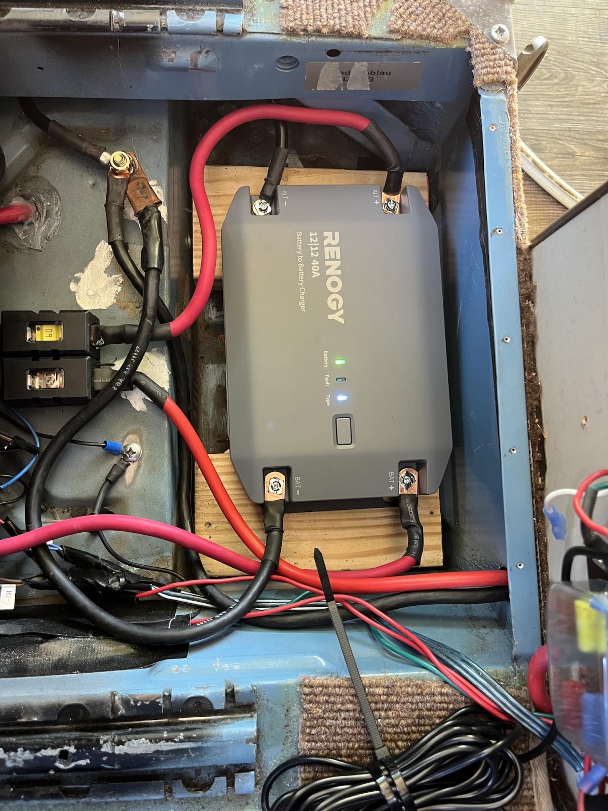

Just wanted to update everyone on this situation. I received the new Renogy DC-DC charger and installed it today. As I mentioned, it doesn't have the D+ wire unless you have a smart alternator which obviously I don't . I watched it today and it will NOT start charging until it senses 13.5 volts coming from the alternator to the battery, only then will it begin to charge. When you shut off the car, it takes a bout 15-20 seconds or so for it to shut down. Not enough time to cause problems with the starter battery. It is a smaller form factor and uses extruded aluminum fins to dissipate heat rather that noisy fans.
Before
After
