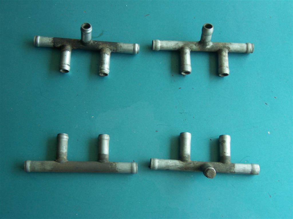

4 runners- paint is shot, and there is light surface rust on two Should I sand blast them?

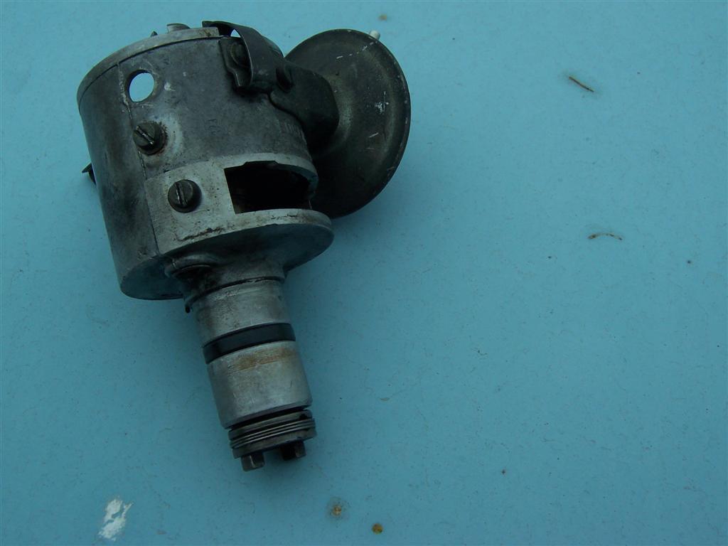

1 AG distributor
1 H (automatic) distributor

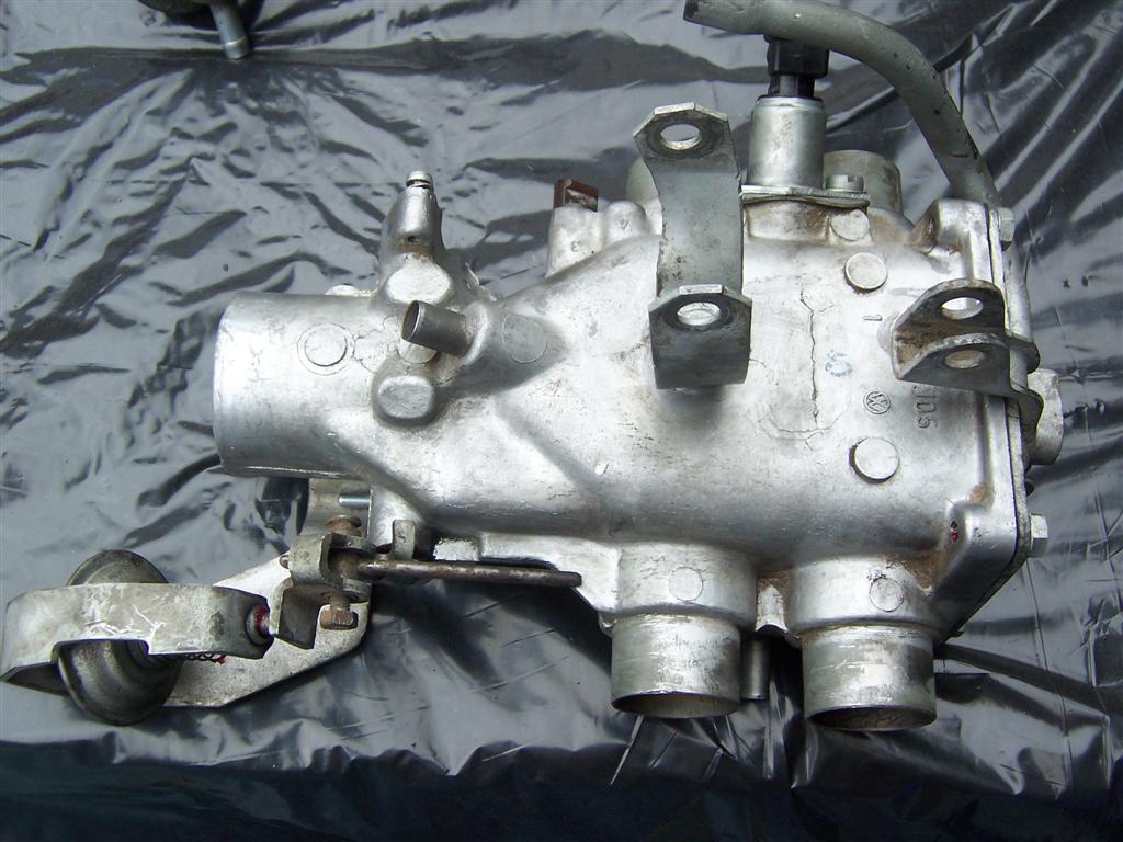

1 automatic transmission throttle body (the device between the runners), with a strange bracket and do hicky bolted on it that has a rod on the throttle that it works with
Are you talking about a black micro-switch attached to the left side of the unit? If so, then that's the kickdown switch for the automatic (also known as an utterly useless part stuck on so that you have something else to break and more wires strung around).

It is in a bracket, but it has no wires. Today I found one in the adds:
http://www.thesamba.com/vw/classifieds/detail.php?id=556598. What does it do? How does it work? I ask because I want to make sure it is set up right, for now it seems like it is doing nothing.

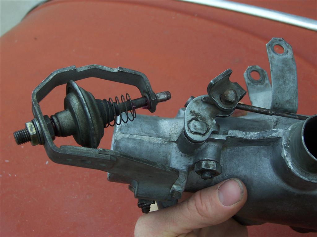

The modulator valve uses engine vacuum to regulate shift points. For example, your car should shift thru the gears faster on the flat than going up an incline.

Get us a picture of yours. The modulator is not mounted in a bracket. It is screwed into the trans. I think what you are describing is an anti-backfire valve on the very late cars only.
I have a box full of those. NOS. They do kind look like a modulator valve.

four fuel rails
4 runners- paint is shot, and there is light surface rust on two. Should I sand blast them?

that mystery bracket is what the acceleration spring is connected to to get its stretch, the mystery metal piece goes right behind the T.P.S., not sure what it does... I was told at one time but forgot. has a certain name.
i second the mystery bracket, it bolts where the AAR sits and is the spot for the return spring to hook to.
those two mystery switches with the 1 prong are thermo switches for the cold start system.

Thank you for the replies! Very Happy Very Happy So, any one know if the part on the throttle body is an anti-back fire device?

architect_7 wrote:
Going to take up a lot of band width doing it this way, but.
4 metal injector plates
Correct
3 plastic injector plates
correct
four fuel rails
correct. The 2 uppers are right side only. extra fitting goes to the cold start valve.
2 T.P.S.es- one 4 pin and one 5 pin
2 fuel pressure regulators
the one on the left is probably bad. not a good sign that the adjuster is screwed all the way in.
2 of an unknown, with a part number of 311 900 161C and 033 6003 008
Thermo switches for the cold start valve. One is T-3 the other I thnk is 914 Porsche {/b]
1 mystery bracket
[b]Throttle return spring anchor as others have said.
That is not an automatic throttle body, just a late 72/73 with the deceleration dampner
