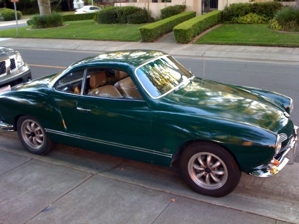

I made that mistake. I paid $2500 for mine and am additional $5500 into it now and my car was in better shape than the one you are looking at - not so much rust. Keep looking - offer $1000 and walk away if it is rejected. The motor is worth $1000 anyway. You may want a parts car if you find another 1970 "Fat Chick".
Here is my 1970:

Stonesrock- Very nice KG. Love to see that you're driving it in the snow! So apparently it can be done!
