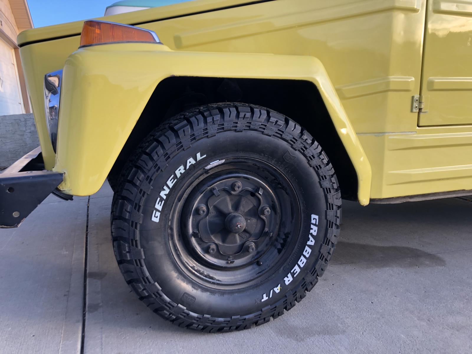

I'm running General Grabber 27x8.50R14 tires. I personally think they have just the right look and amount of aggressive tread to them, and I like the way they ride. The price is also really good from a lot of the online retailers. I got mine from blackcircles.ca for around $100 CAD each shipped.
