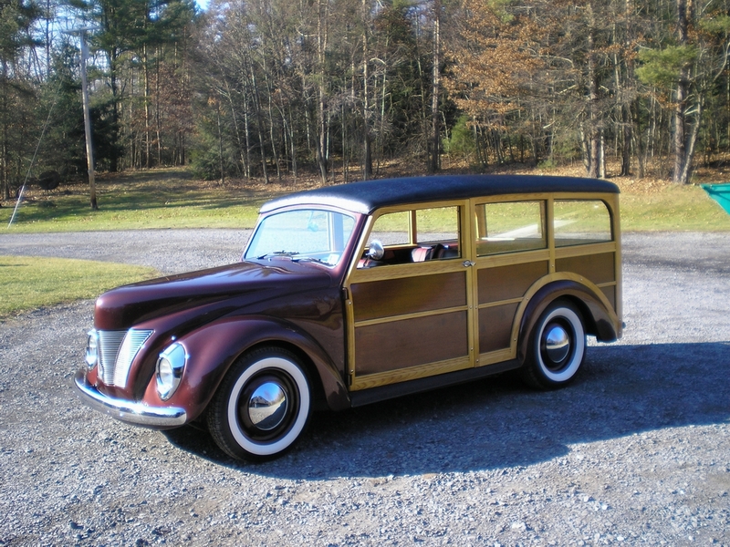

OK - Screw it - here's the idea.....A buddy gave me inspiration by building a nostalgia type bug gasser recently. So look at a later super without a front bumper - its actually has the 39-40 Ford/40 Willys vibe. Was pondering building a 3/4 40 Willys Gasser (nose up, white wall slicks - the whole 60's gasser look) but turning the bug into a coupe is hard to make look right.
BUT I really loved the look of the 40 Ford Sedan....And a chopped bug has that look. So doing a Super with a chop may be the answer....And I have the 74 Super (and a 40 Ford style hood)and the baja..

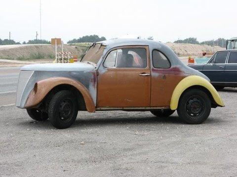

PostPosted: Sun Nov 27, 2016 11:06 pm    Post subject: Re: Anybody replace roof/windshield/dash on late super with Standard Reply with quote
Something like this? You would be better off starting with a standard.

Almost every "coupe" I have seen looks wrong.. The door/rear window always looks cobbled. (Yeah I know, coming from a guy that is going to mate a super and standard. Laughing ) Original idea was to build a "Stone Woods Cook" Swindler pseudo clone, but there is no way to get the grill to look right and the coupe mod issue totally killed it.

What led to this is seeing my buddy's "nostalgia VW gasser" and throwing a set of wagon wheels and tires from a baja on the super to be able to roll it around. The nose up and big ass tires hanging out the rear fenders along with the curved fender bottoms look so cool. Found a glass 40 Ford hood and set it on... Cool

I agree, that front door wasn't well thought out. A little work there would go a long way to achieve that Gasser Ford/Willies look your aiming for.
Also, if you start with a standard Beetle, I think it would be easier to rework the front fenders to roll under than to reconfigure the windshield and cowl. You might even be able to use super fenders and only need to rework the apron. Also, I'd think using a ball joint beam would give that front straight axle look better than the MacPherson front of a Super. You could just jused raised spindles to raise it up a few more inches.

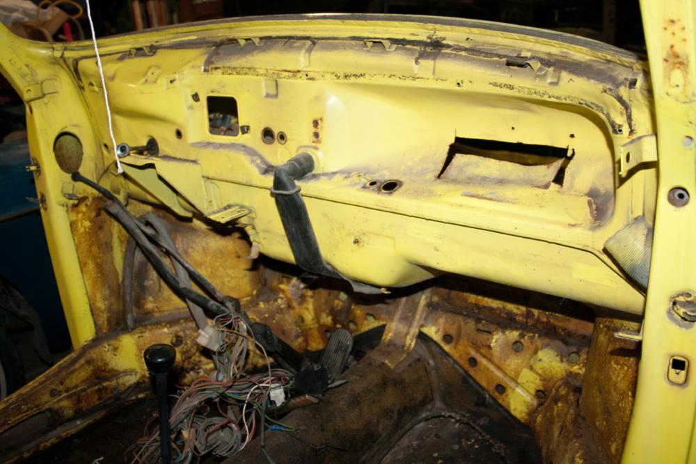

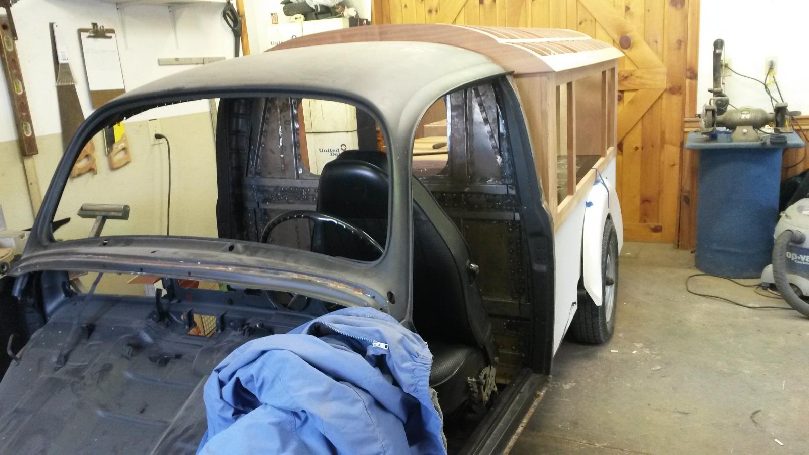

Well - I did this a few years ago - was a vert
Am building this now
The big blue Bentley has complete teardown of a body. And yeah - I use a lot of cardboard and thin plywood for mock ups. But I do a lot of work on paper first.
Both cars are, so to speak disposable. I mean, what is a 61 Baja body that needs door bottoms, heater channels, firewall and is missing a rear quarter worth, let alone a 74 Super with engine fire, hacked repairs etc.
Like I said - I dont cut up anything nice. And seriously, I build resto-mods, cal-looks, stocks and buggies for my wife and me as well as customers. I like the challenge of something different. And the cars I build tend to be pretty popular - Which doesnt always mean a lot Laughing There's some cars that attract folks that I think are hideous. Shocked Well - it will be a while before I actually start building it - still doing a thought experiment and seeing if I can do this...and if it will work - proportions need to be right. Have been wanting to chop a top though...would give me an excuse. Cool
Maybe do a blend of the two Ford/Willis , if sedaned, and get rid of the back side windows completely and round the door corner--will look less bug-like though, good or bad lol .
I've thought the front end of a Super without the bumper had that vibe about it too.
