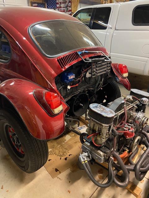

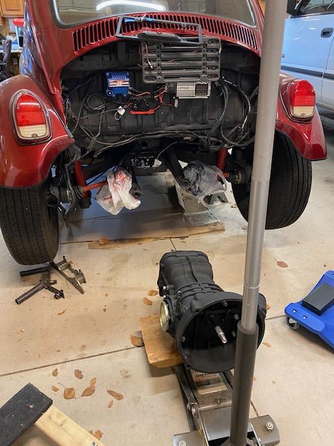

Over the winter I had my transaxle rebuilt by Rancho (to a Freeway Flyer) and I had a Stage II clutch installed on my engine by Red-E in SLC, UT. I put everything back together and for ~month worth of driving, it's been shifting okay. I only say "okay" because down shifting from 3rd to 2nd, to 1st has been stiff. Ex. Even from a dead start, I've have to shift to 3rd, and then 2nd, and then 1st, before moving forward.
I called Rancho and they said that was normal and that the shifting would get smoother with more miles.
I've probably put about ~100 miles on the rebuilt trans and new clutch.
Today I went for a drive and noticed that shifting was getting progressively harder, very quickly. It ultimately got to the point where it wouldn't go into any gears without a bit of a struggle. (And I got to utilize my tow bar again to get her home.) This happened fast, in one drive of ~10 miles total.
So, right now, sitting with engine off, not pushing in the clutch, I can cycle through all the gears 1-4 and reverse, up and down, no problem. Very smooth. Same scenario, engine off, with clutch pushed down, again, I can cycle through all gears 1-4 and reverse, up and down, with no problem.
However, once I start up the engine, push in the clutch, I can not shift into any forward gear or reverse. It feels like everything is just blocked. It won't shift at all.
Does anyone have any thoughts on what might have happened? Is there a clutch adjustment that I should try? Any thoughts or suggestions greatly appreciated.

Did you check your transmission mount is intact and torqued correctly?
The rubber block can detach from the metal holder so it looks ok but os not functioning, this caused my gearbox to sit out of line with the enngine driveshaft so I could not engage gear!
I thought my gearbox was destroyed but it was just that rubber block broke pff a 20 dollar fix bit 2 days work!
One day to pull the engine/trans and another day to pit it all back again.
Correct clutch adjustment is cricial also.

While the trans is out just test you can turn the drive shaft output ,change through the gears and see the axles turn as they should, need a helper woth this, of gearbox os faulty ypu should feel this!

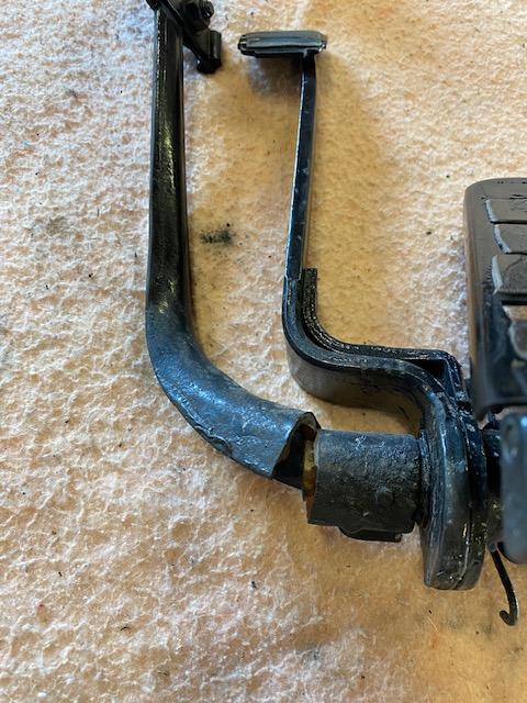

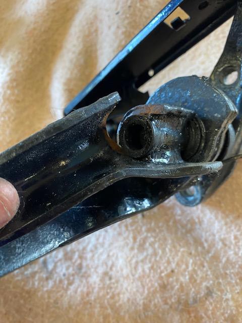

For anyone in the future who is researching, trying to figure out why their car stopped shifting and thinks it might be that the clutch cable is not set correctly...
You will ALSO want to take a flashlight and inspect your clutch pedal arm for damage or cracks. Turns out that after I readjusted my clutch, within the next couple of times I drove my car again my clutch pedal arm separated from the assembly, i.e. the metal cracked and broke. This may not be your issue, but, for me, I had to replace the pedal assembly and now everything is working well again.

Mine did the same rip, tear, and bend in the same location. Fix'd it with a weld:
Take a look at buggy builder joescoolcustoms superb clutch pedal arm fix:
https://www.thesamba.com/vw/forum/viewtopic.php?p=9337946&highlight=pedal+weld#9337946

The clutch pedals on my 1970 and 1971 VWs also cracked like that, and had no rust on them (Arizona).
