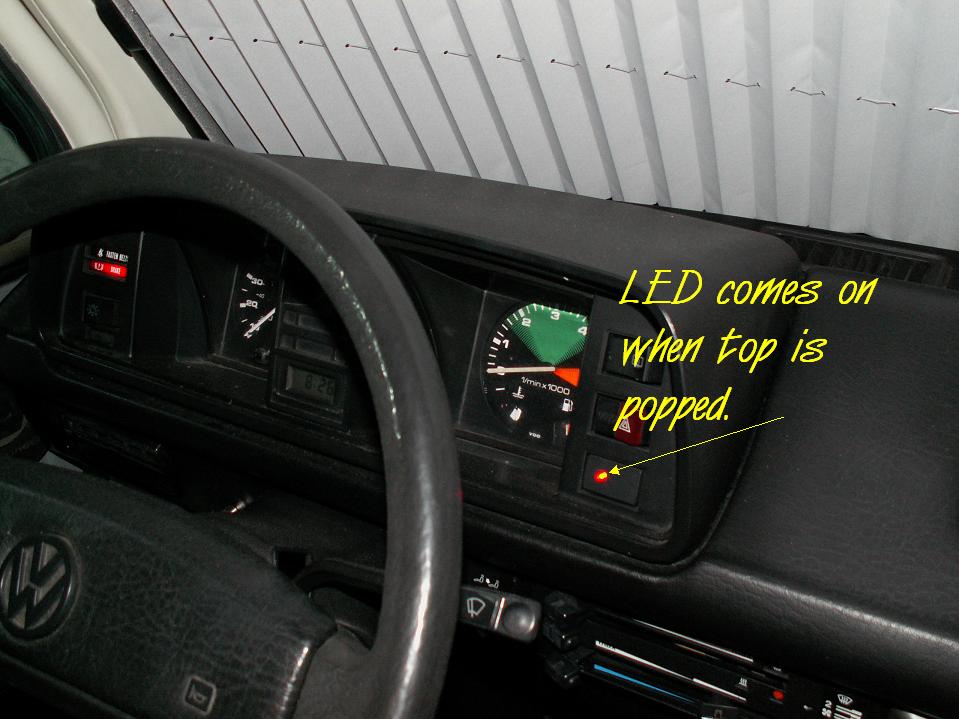

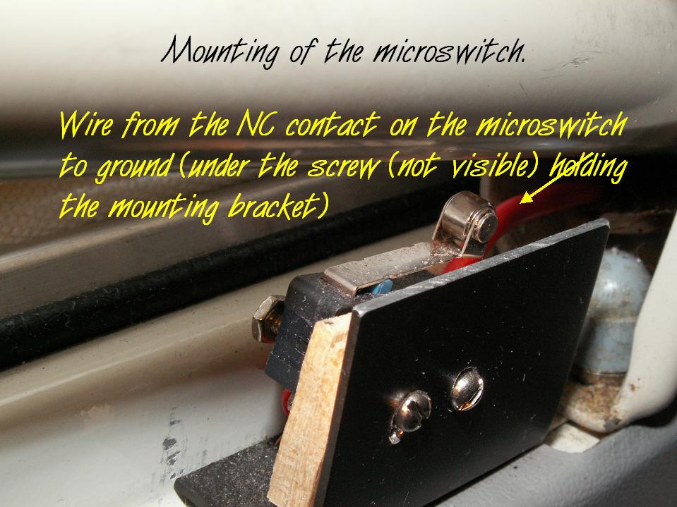

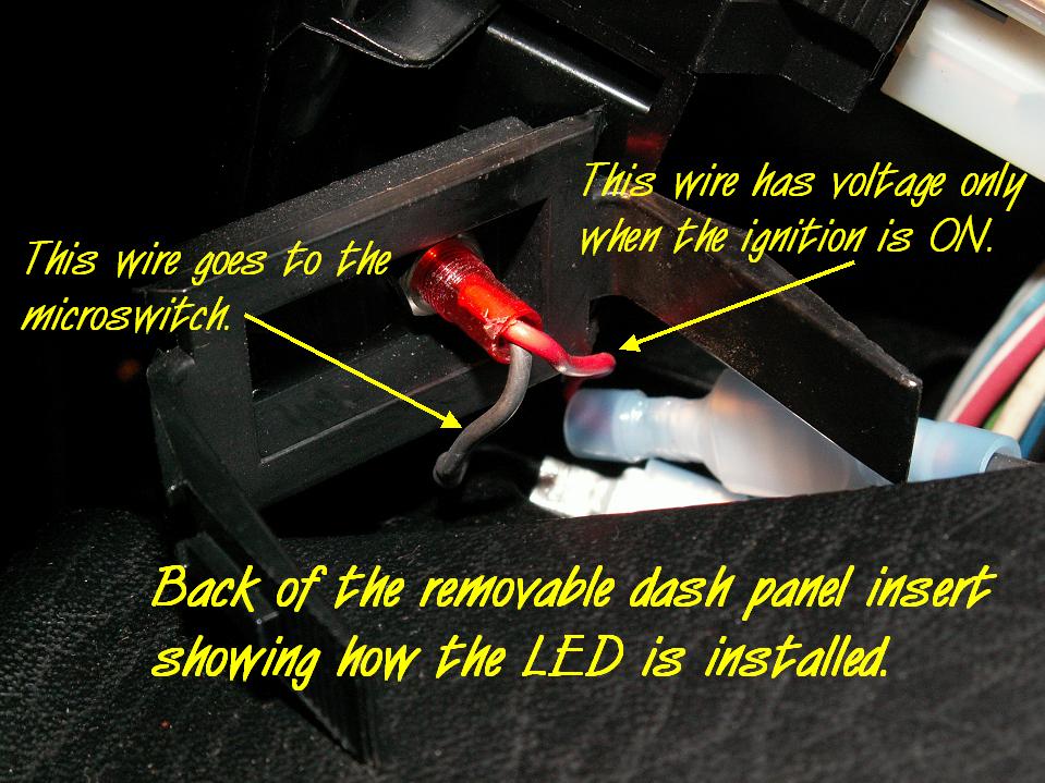

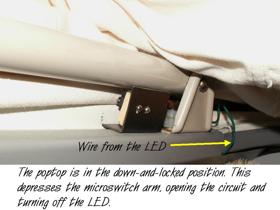

Yes, I put in a microswitch to activate a red LED on the dash if the top is up and the ignition is on.
I pulled the cover off the instrument cluster and found a wire that was hot only when the ignition was on. Don't remember which one it was, but I can look later. That went to the appropriate lead on a Radio Shack red LED (don't remember the part number, but can find that later too). Then ran a wire from the other lead on the LED under the floor mat, behind the driver seat, up the molding on the aft side of the driver door opening to where I mounted the microswitch and connected it to the common terminal on the microswitch. The microswitch, from Radio Shack, has both normally-open and normally-closed contacts. I used the normally-closed (NC) contact and connected it to ground using a nearby screw that holds part of the tent-support hardware. (NC means that if the microswitch is in its free state, the switch will conduct electricity.) I will make a photo later showing how I mounted it.
So, if the top is up and the ignition is on, current flows from the hot wire in the dash, through the LED, and through the microswitch to ground, thereby completing the circuit and lighting the LED.
I'll see if I can post photos in the next couple of days. It's too late tonight.

I have the photos of the poptop warning light installaton. For sake of completeness, I will repeat part of what I wrote earlier.
So, here are the photos:
