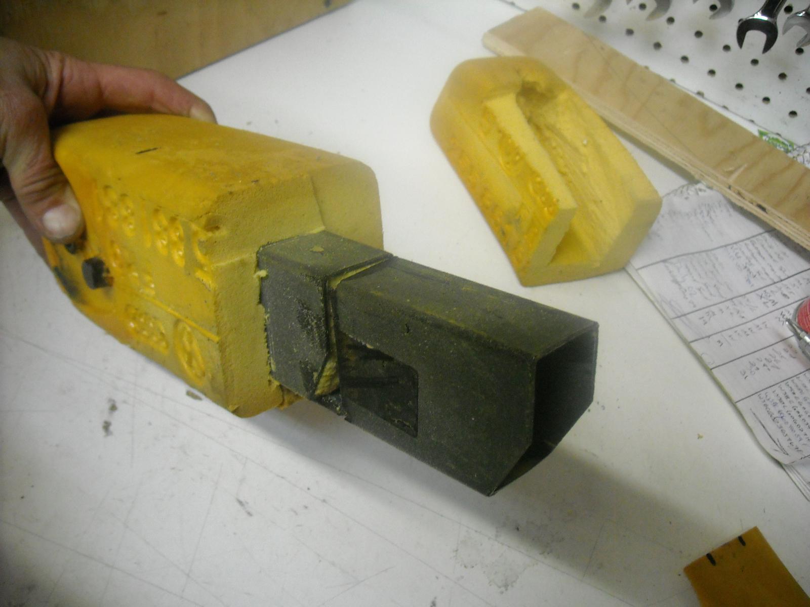

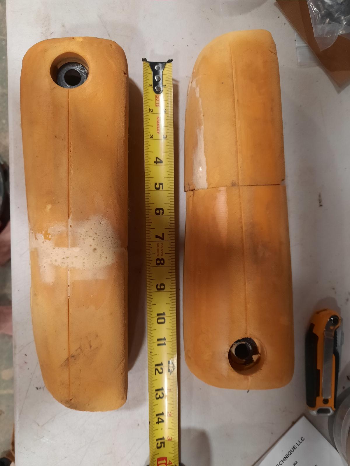

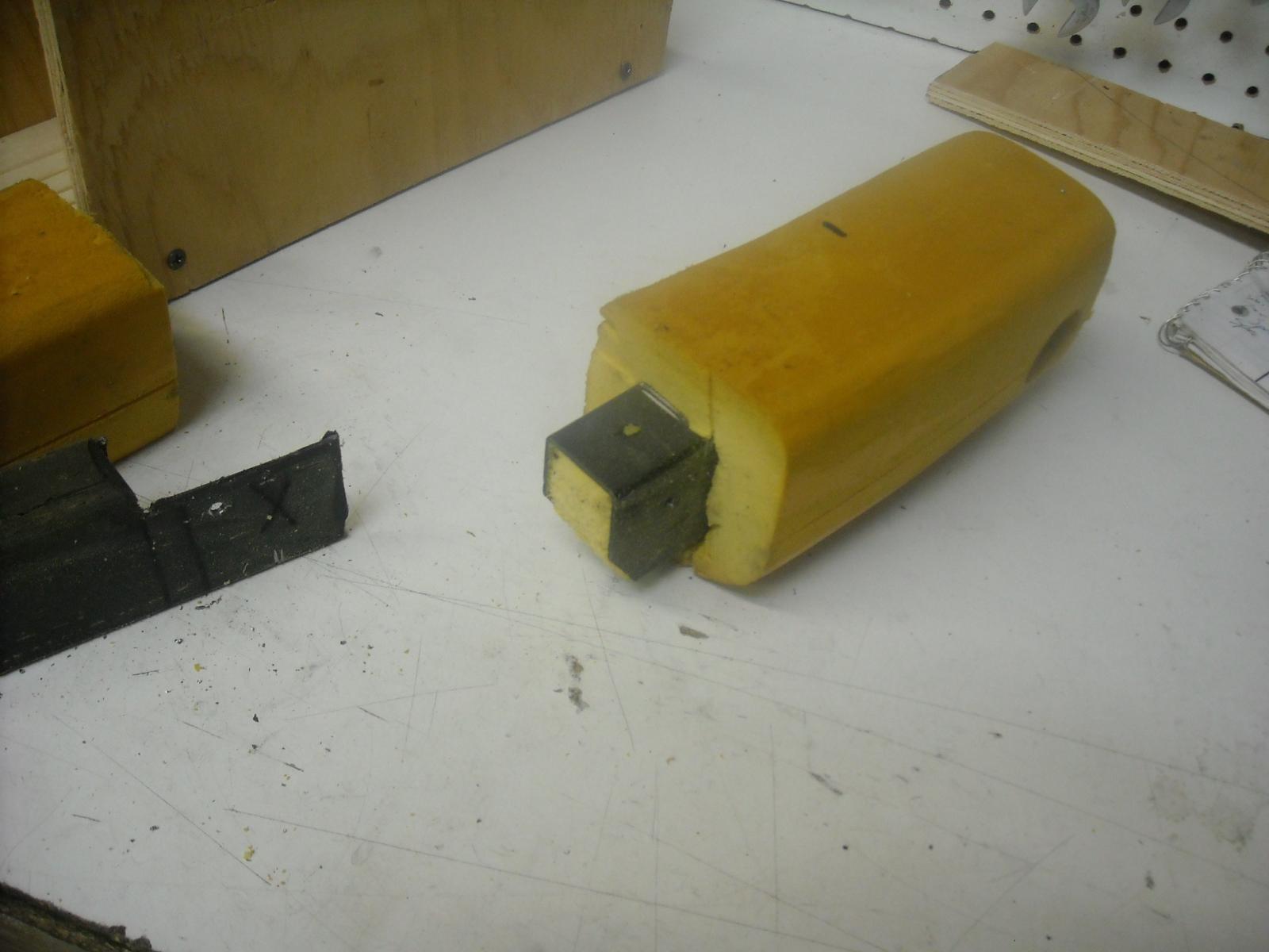

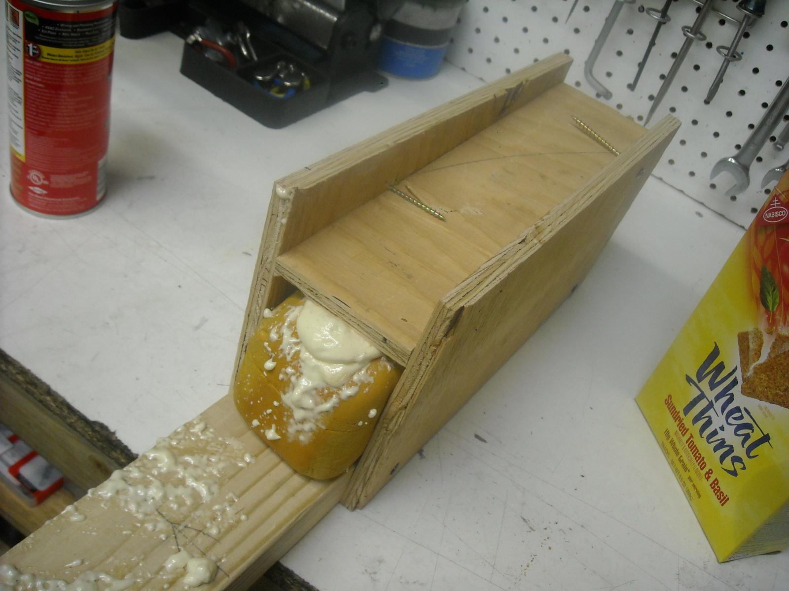

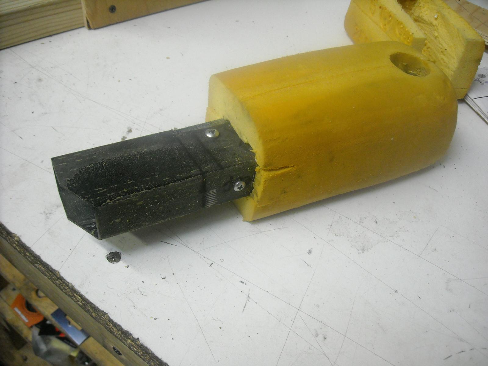

Years ago I extended my non-adjustable armrests using two sets. I still have them sitting around, uncovered. I had always intended to have Sewfine cover them for me but was waiting till I had a fabric choice. I did have them cover a set of adjustables for me, using some original fabric from a cushion cover and one of their Vanagon vinyls and they came out beautiful. Let me know if your interested in the arm rests, I'd sell them cheap. I'll dig them out a post a picture of the finished product. Here are some pictures how I did it, maybe not the correct sequence thou.

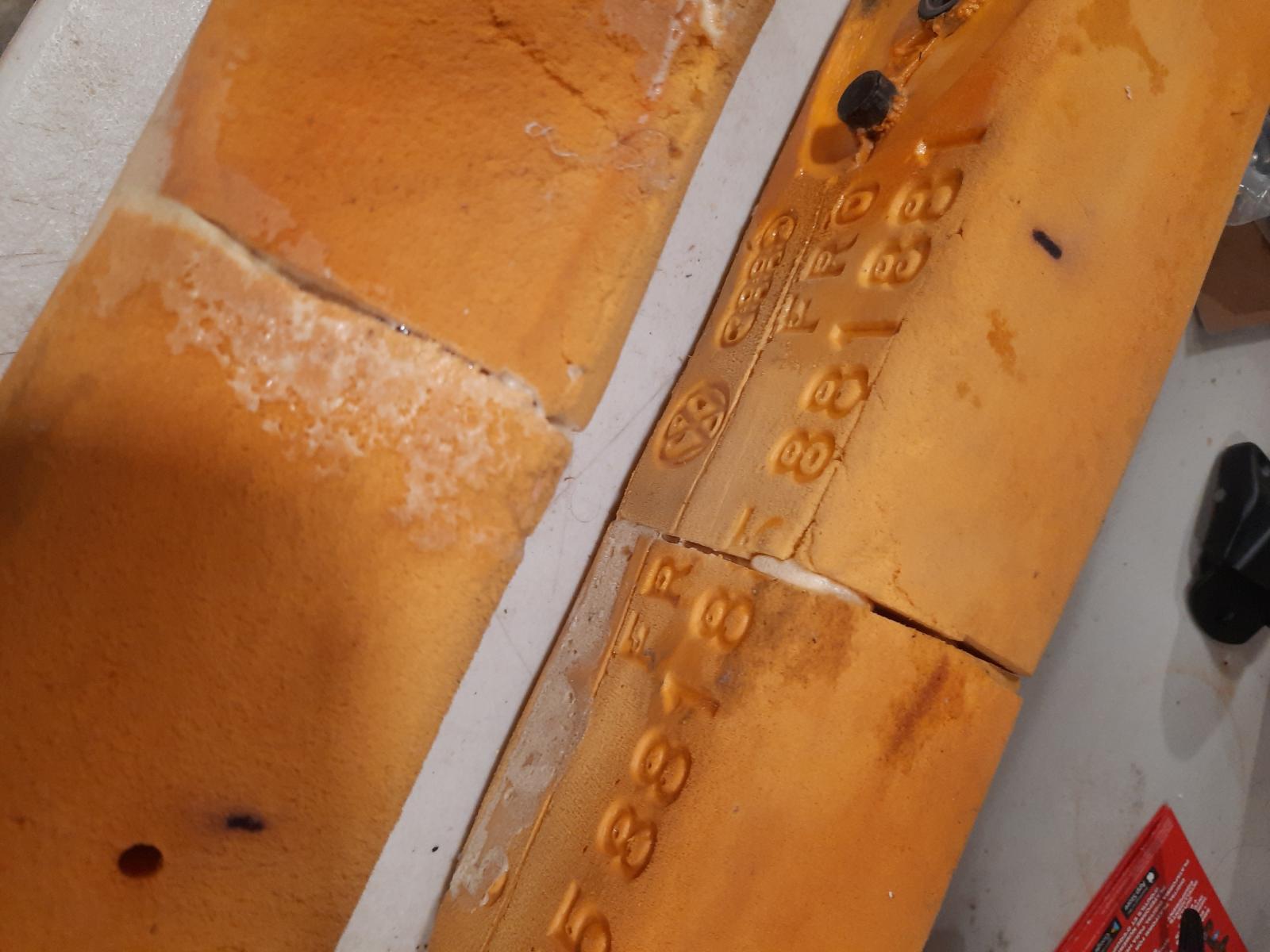

Looks like they came just over 12". The spray foam worked well, I think I used sandpaper to smooth it out. I got the sections lined up pretty good, maybe a little lippage, but I'd imagine to use some padding on the tops at least. Then there is the adjustable arm rest cover by Sewfine.
