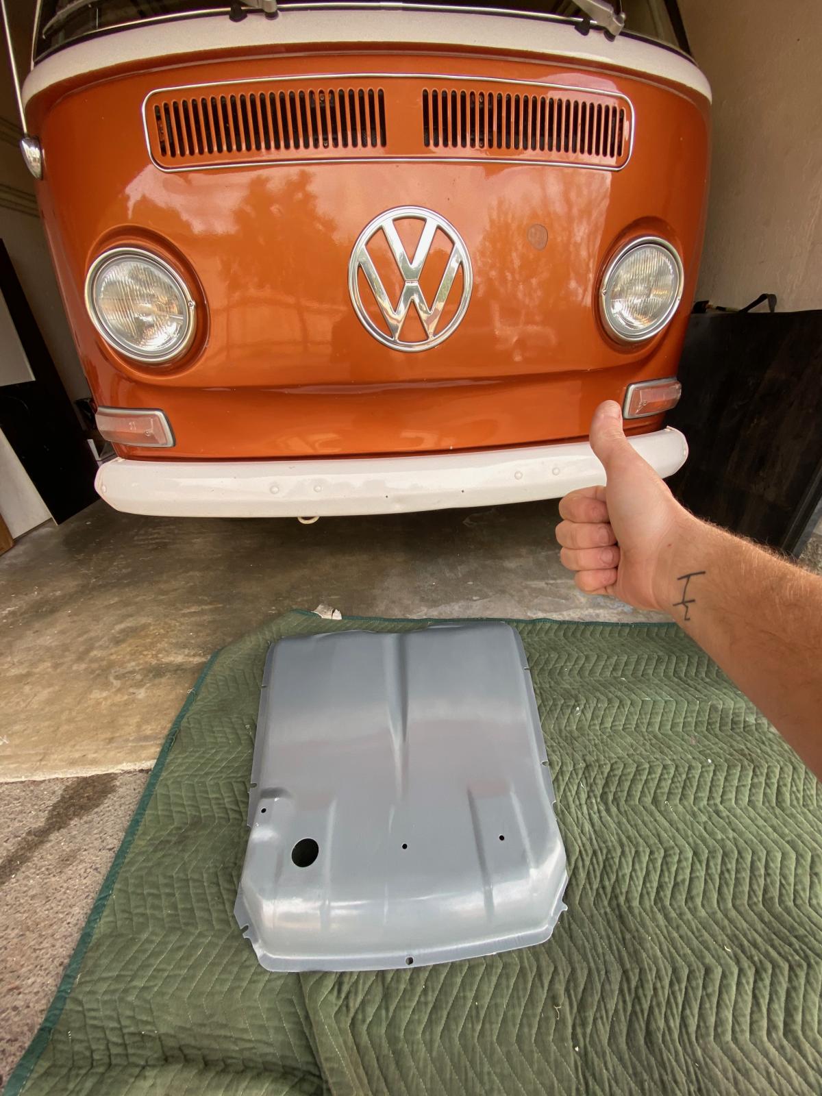

as stated by the prior post, splash pan
photo by Airschooled of 1969 splash pan
