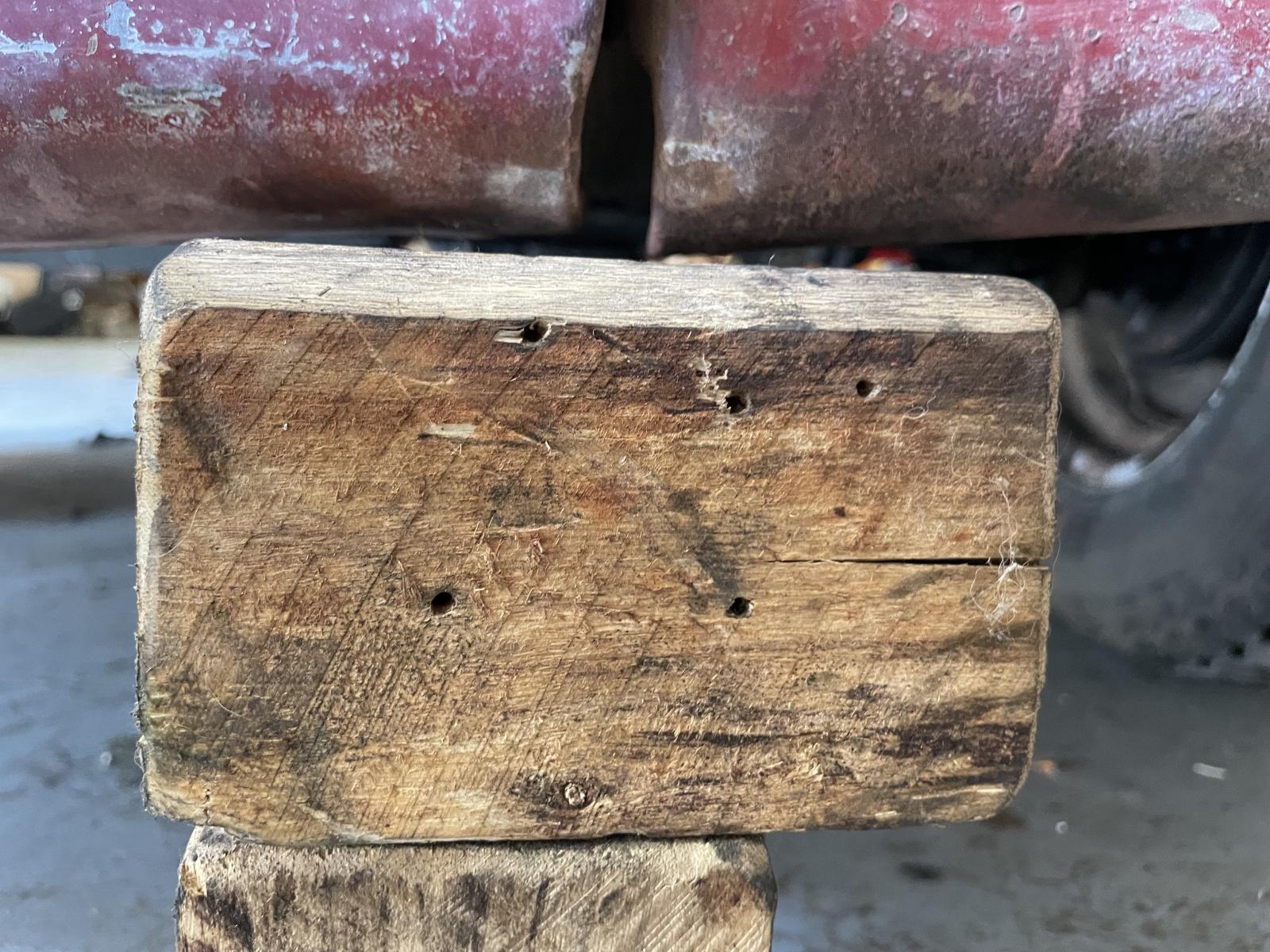

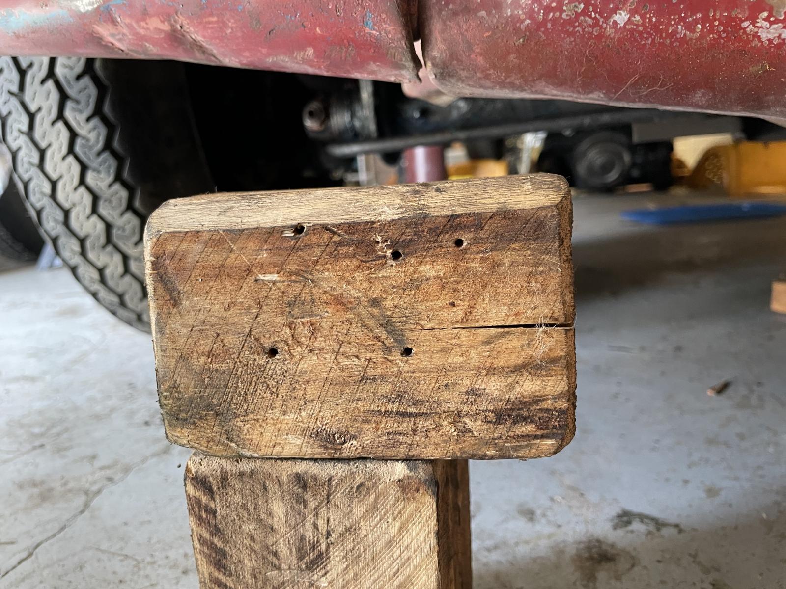

Seeking advice how to straiten a tweaked nose, preferably without expensive tools. Wink Of course if such is required, then save up and get it, unless can borrow.
Only forward of the spare tire bulkhead, sans quarter panel behind the fender, is affected. When I had the fuel tank out, everything measured fine.
Thanks in advance. Very Happy

My question is how to proceed with the repair, especially where to pull or push. I been thinking on it for almost six years, at least three thinking how to straiten with a ram. Now has gotten more complex seeing the impact was at a downward angle.
