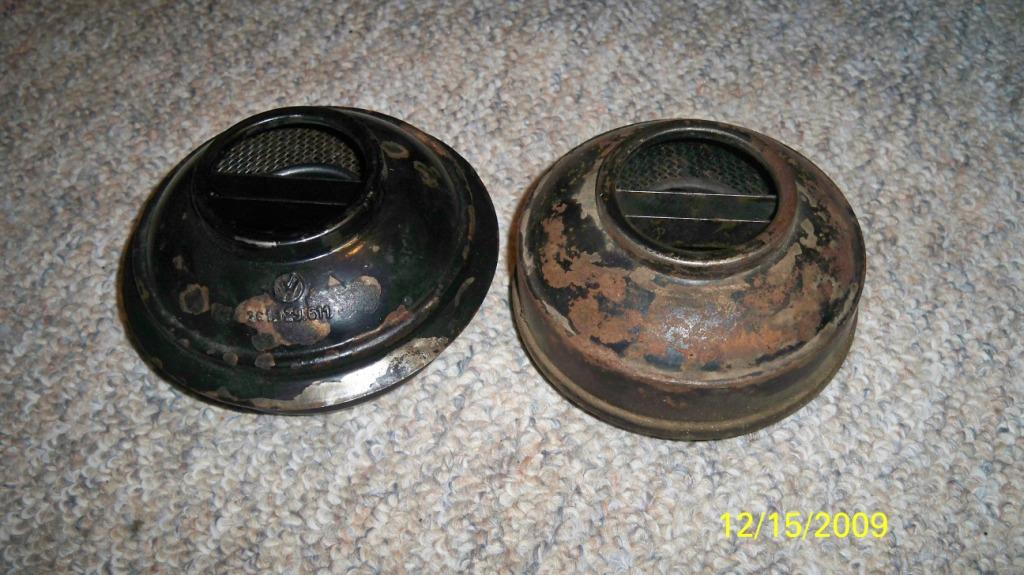

2 different styles too, one like the pic everett posted and one like this
an the other like this
see the round pressings compared to the straight ones?
shiny paint doesnt make it worth any more

I have a round pressings with N° 26A.08.25
And KNECHT L8 603
I'm not 100% sure that it's OG from 25hp dated 03.1953 but 99% sure Wink

that looks more like the one in the pic, the wingnut ones could be wrong

I think wingnut is good Wink
Any idea about the straight ones are for ? year ? model ? Any ref or N°?

I don't know the year to year changes on these but from what I have seen, the round pressings are earlier as they all have a 26A part # and not a 211 part #.
I have seen the "3-spoke" style with both 29A and 211 part #s.
26A:
211:
These both have the 3-spoke style bowl

thats interesting ev, both my ones have the 261-129-611 part number on them, and they are one of each.
bith are missing the retainer clip, but not hard to get one on there to secure it.
