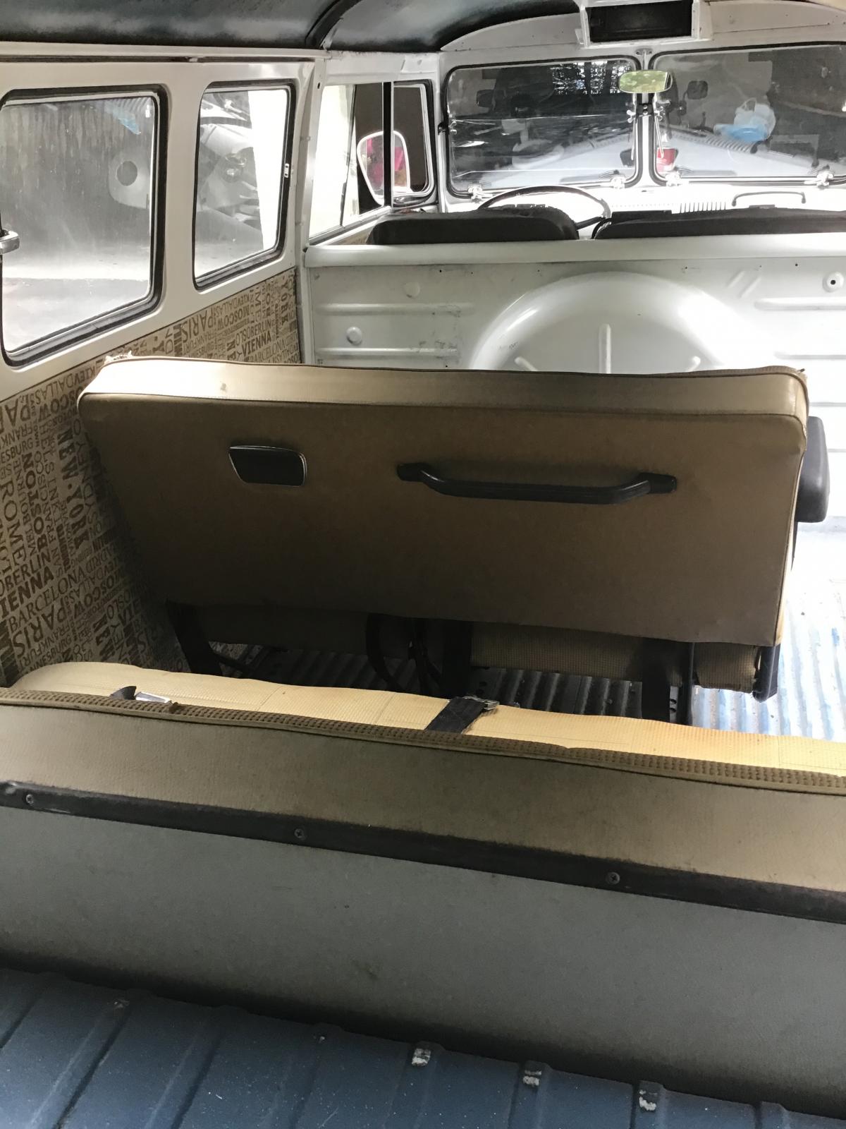

Getting ready to order seat covers(custom) from Sewfine for my wifes 13W deluxe. The fronts are the original 2/3 seats. However the rears are Craigslist bargains that I think??? came from 2 different Baywindows. Can anyone tell from these pics the yr ranges of Baywindows or perhaps Splitty that I need to specify b4 I order?

Yes seat covers will matter on the year. Bay window rear seats are more narrow than split and middle seats are way different than split. Both of your rear seats look 69-71 style. 68 middle looks the same except the armrest mount.

As you can see from the following pic the rear seat is narrow! Had to add some washers to the L-bracket.
