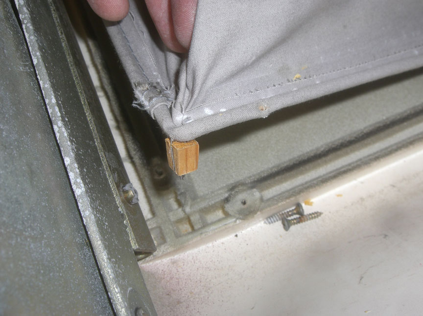

I removed the poptop from the van and flipped it upside-down because I have an overhead crane. Without a crane, removing the top would be an EASY job to do with 2 or 3 helpers, it does not weigh much (~100 lbs?). There are only ten M6 screws holding the fibreglas top on the van. After all the bottom tent screws are removed, it only takes ten more minutes to remove the whole fibreglas top.
Remove/re-installing the canvas on the upside-down top was just so easy, and easy to do it perfect..... that I would NEVER try to do it overhead (on the vehicle). I am certain that in trying to do it 'on the van' you'd lose a bunch of screws. There are a LOT of screws holding the fabric, and two different sizes!

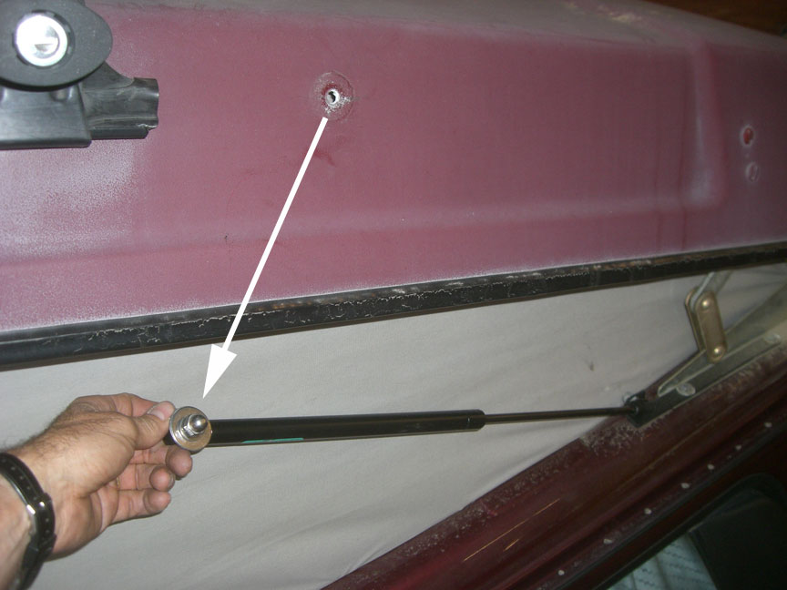

Started by removing my current most favorite upgrade, the 'jackbombay air assist' kit. I've only been driving Westies for 10 years, but I've always had cargo on top, and 10 years was too long to go without this simple enhancement. http://www.thesamba.com/vw/classifieds/detail.php?id=578890
Of the six bolts at the rear hinges, remove FOUR of the bolts, leaving the middle 2 bolts in place. Then go to the front struts and remove plastic caps and loosen the nuts, leaving the nuts on a few threads. Then lower the top.
Tie these springloaded supports like this. Be sure they are securely tied, and the tie-wire cannot slip down the shaft and let it go. The spring force is not very high, but would knock some teeth out if it hit you at full speed. On Limbobus, they describe using plastic zip-ties, which seemed to be sufficient, but at some point let go and hit a guy in the head!!!

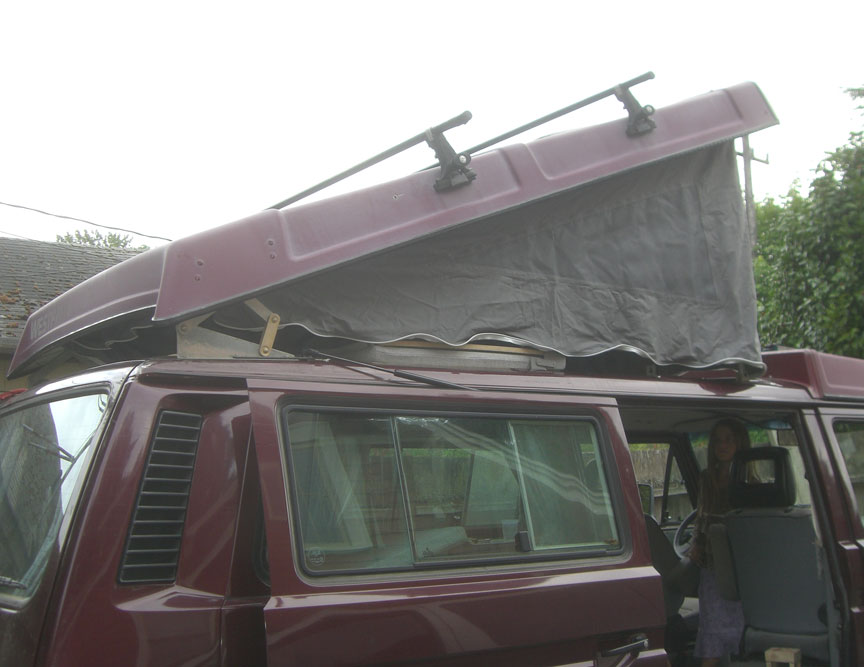

Then remove the 4 front nuts. Have help to angle the poptop up to gain access to the remaining 2 bolts in at the rear hinges. Remove those, and lift the top off the van. I read somehwere on the internet (vanagonauts?) that one guy can stand inside the van, walking it rearward while others are at the rear of the van, walking it off. But I used an overhead crane.

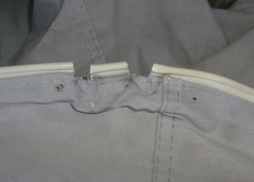

Here is a photo of the corner. Notice the 'cuts' in the beading at each segmented corner.
Here is a photo of the OLD corner removed. Notice the 'cuts' in the beading. I did not pre-cut my beading because I did not know where the corners would end up. I cut out the beading with a knife as I formed it to the corner (during assembly).

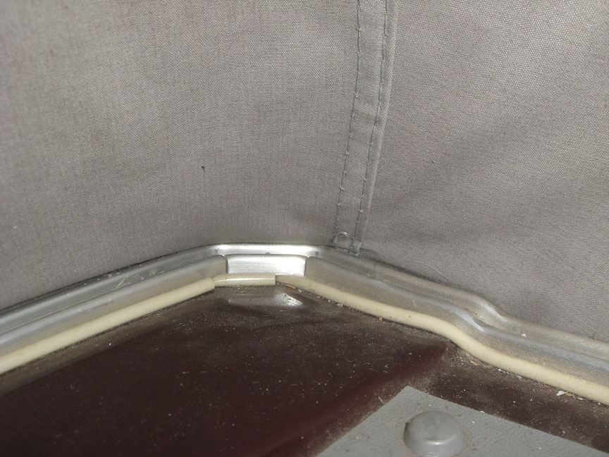

Here it is at the 3 hours point. Ready to start screwing the bottom beading of the tent which took another 2.5 hours.
This 1/4" drive air tool cost $12 at harbor freight, and was very useful to get into the corners. It doesn't spin very fast, and I did not lose a single screw.
Finished!!
