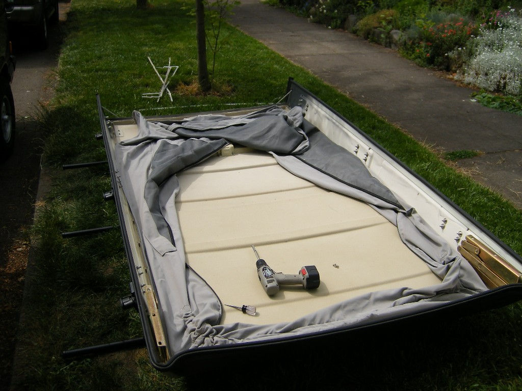

PostPosted: Thu Jun 04, 2009 9:06 am    Post subject: Reply with quote
I didn't take my pop-top off and it took about 4 hours. I just unbolted one front pole at a time and slipped the canvas through. I did the canvas to the top first, then the bottom. I marked the middle of the canvas and started screwing to the front corners, then toward the back, doing each side equally until I met at the middle of the back of the pop-top. Its a bit tight in the back lying down on the bed board but it goes on easy enough. The hard part is the front bottom corners but if you use a ice pick or a all to line up the holes you will have no problem. I used a battery screwdriver, on stuck screws I used a standard driver, I lost no screws, just don't rush. Oh yeah may sure you take the upper mattresses out.

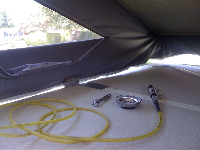

PostPosted: Tue Jun 08, 2010 12:59 pm    Post subject: Reply with quote
Yo Sodo! Thanks for the tip about using a pneumatic 1/4 inch driver. Worked like a charm when tackling those hard to reach corners. In most cases, the screw itself is perfectly able to pierce the tent welting strip and find the hole. Still, you might want to keep an awl around. Once or twice I had to sink a screw threw a few layers of fabric, like at a seam (a beach).
Also, a must have item is (are) two magnetic parts tray cup things. Very helpful in keeping the screws sorted and in one place.
I had a blast this weekend busting out this long overdue project. My tent was made and purchased in January of 2007. Sitting on a shelf in the garage since...
One thing I would have to caution folks about is how to keep those armatures retracted. Don't use duct/duck tape. It heated up in the sun and failed, allowing a rather violent spring-loaded whammo. Use wire like Sodo did, or strong velcro straps. Live and learn, eh?
This new "original" tent is SNUG. The fabric feels a bit thin for my liking, but I guess if if were any thicker it wouldn't stretch as well. It's also a bit darker than stock -- a bit like what you see on newer Eurovans.
On the subject of stretching, I approached the installation by attaching the front, then the rear, then the sides. I did this for both the upper and lower. I think I was perhaps a bit overly enthusiastic when stretching the front and rear. That left the slides almost slack. That slack is GONE when the top is popped tho'. Next time I'll take it easy on the "stretch to fit" idea. It's not necessary to stretch these things that much to get them in right.
Kinda like Sodo here, I think I'd be happier with something synthetic and more weather resistant. If the GoWesty acrylic bomber ones are this easy to install, then I'd say go for it!
I've heard other folks ponder why they aren't made of materials found in backpacking tents, and sewn with as many features -- pockets for example. I kind of agree with that. The good news is that I have my old tent, which is in relatively good shape, to use as a template. THinking of sending it over to some folks I know at Sierra Designs and seeing if they can dupe one up -- hmmm...
Anyway, here's the finished product. I enjoyed the process a lot. If any of you locals here in the SF bay area need a hand doing yours just let me know. Happy to come help. It's far less tricky than you probably think it is....
Later!
