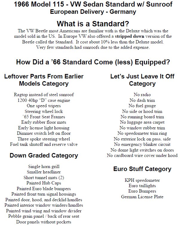

Here is a list I made a while back about some of the differences between a 66 Deluxe and Standard.
The car has been completely disassembled and most of the correct parts have been obtained... So now let the fun begin!

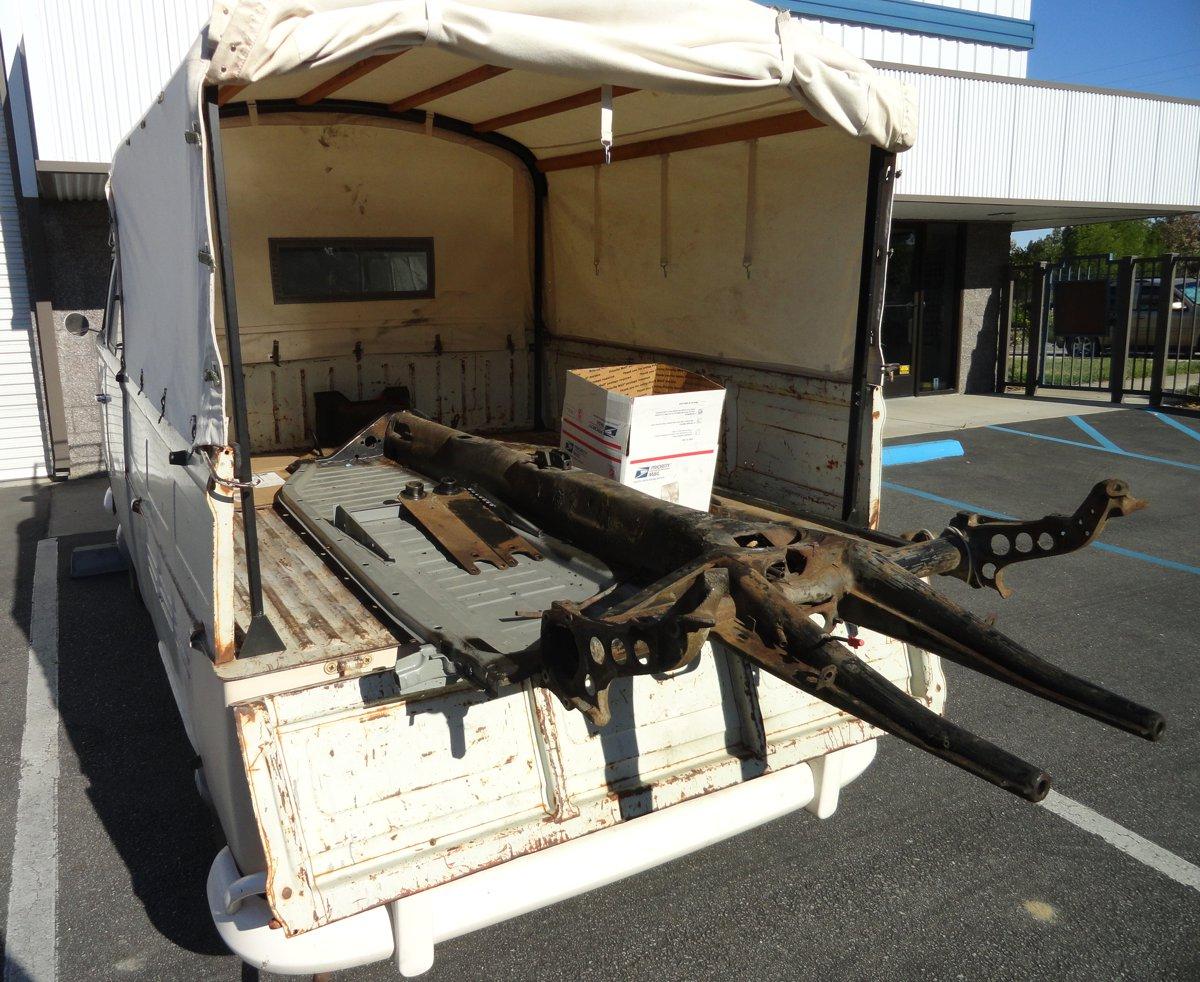

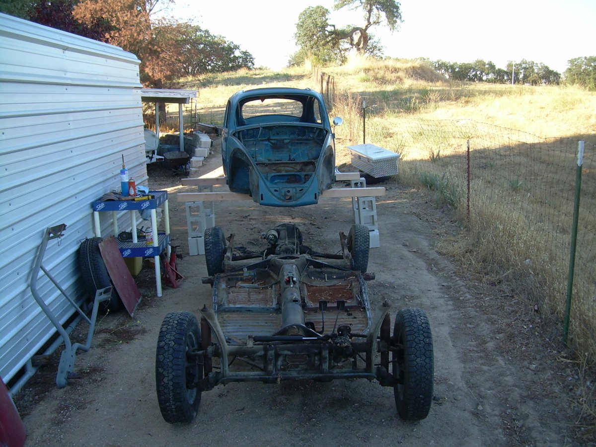

Pan/Body separation day. Went OK, didn't lose any bolts in the heater channels.
Here is the nasty drivers side pan I had to replace. It had a piece welded over the top, everything had big holes.
Test fitting the WolfsburgWest pan half. It fit PERFECTLY with no trimming and the holes lined up with the body right on.

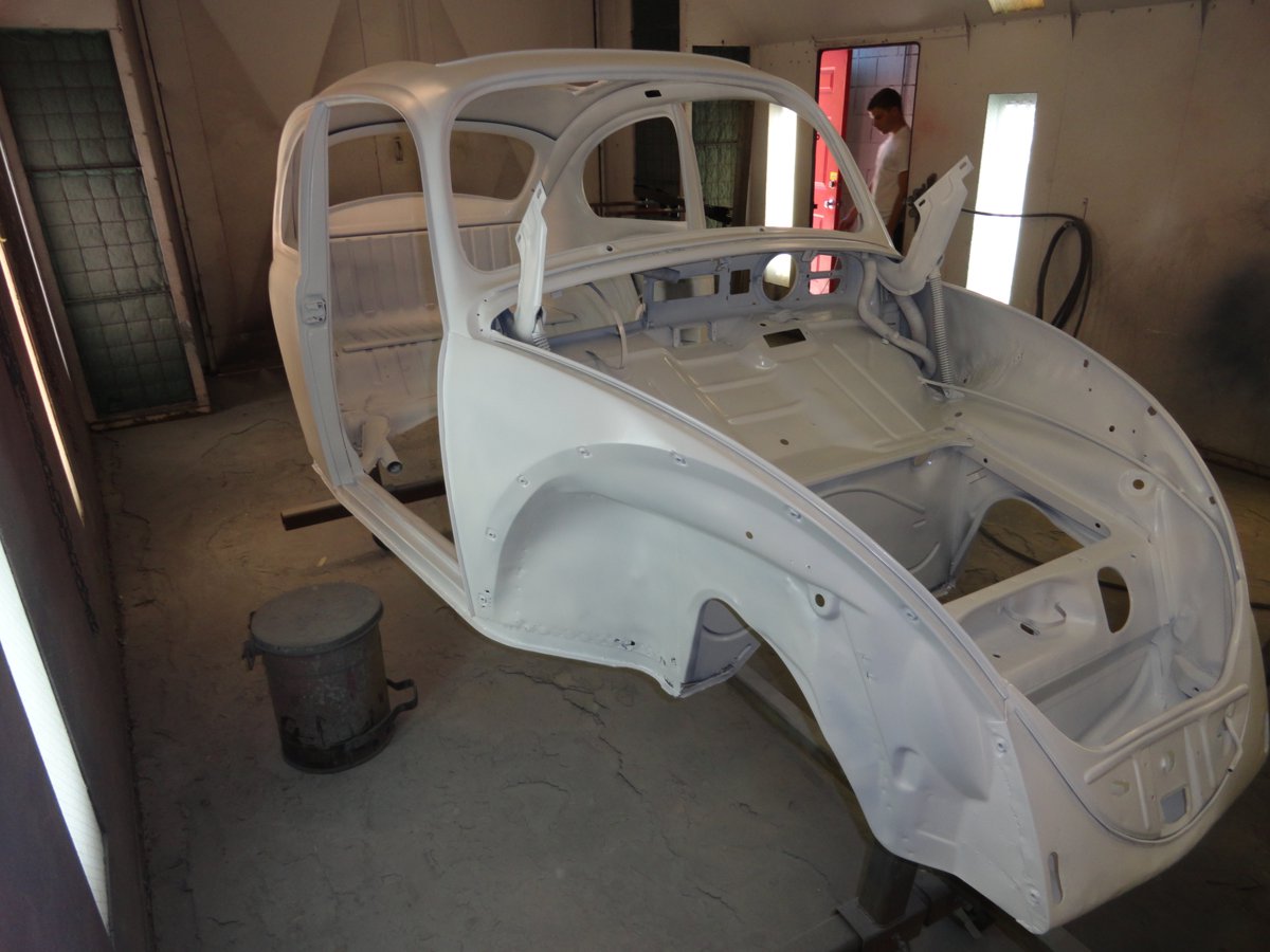

The body shop welded in the pan and then I brought it home to get the chassis ready to go.
The body is on the dolly (it has attachments to roll it) and is at the paint shop. We'll put this on a truck and take it to get media/sand blasted.

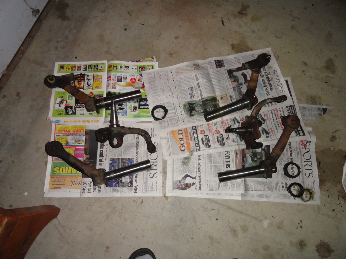

As soon as I got the pan home I tore into the front beam. I need to replace the ball joints and seals.
That's all for now.

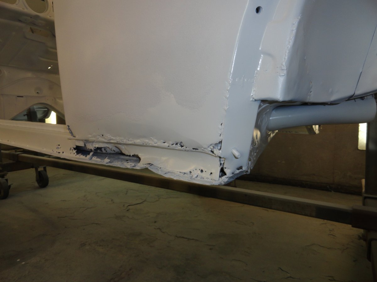

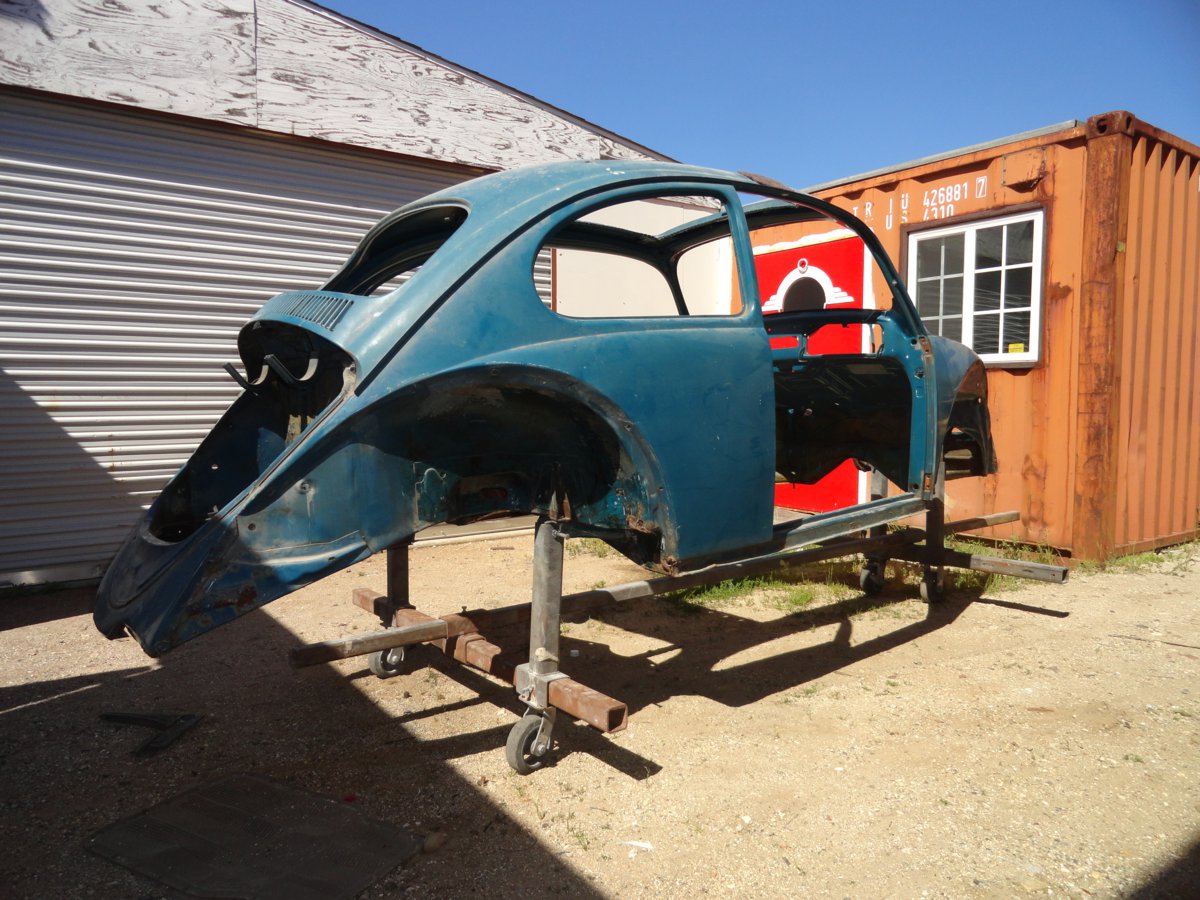

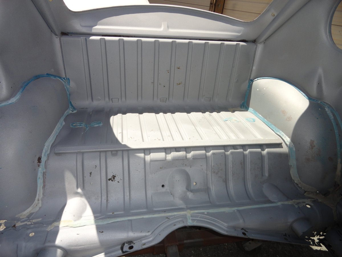

PostPosted: Thu May 10, 2012 7:31 pm    Post subject: Reply with quote

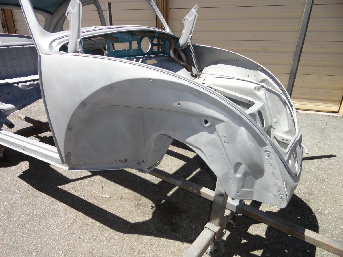

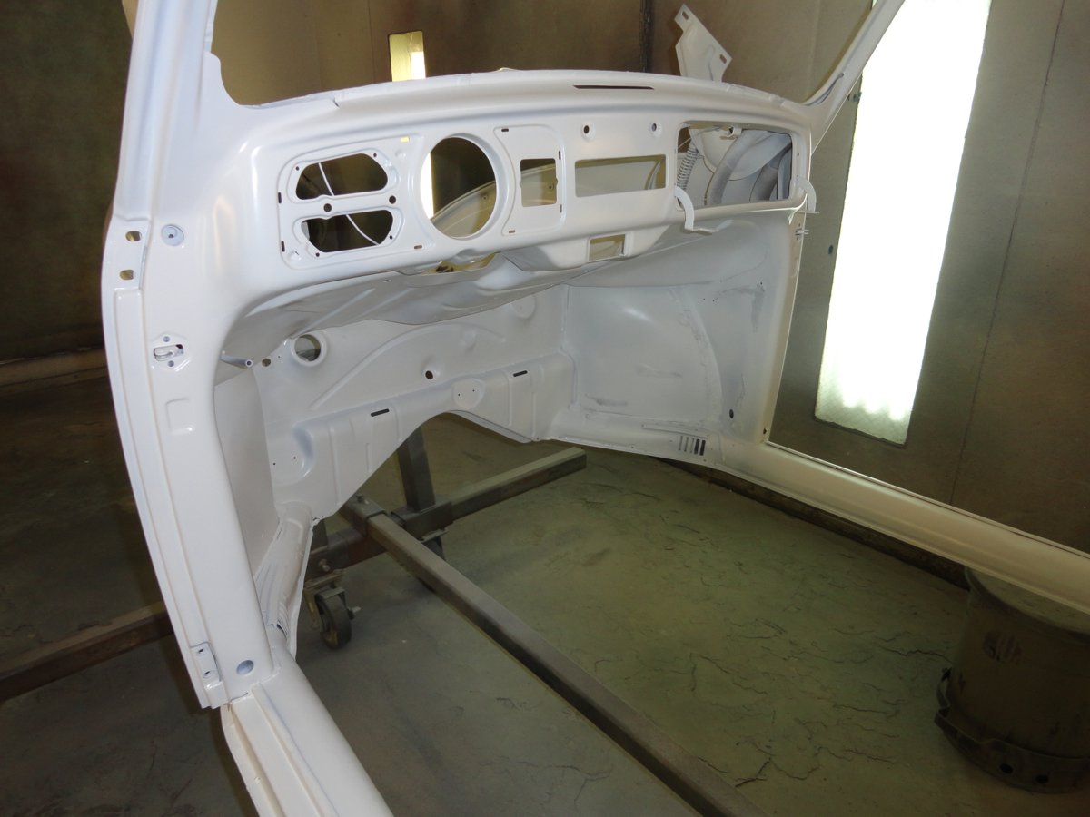

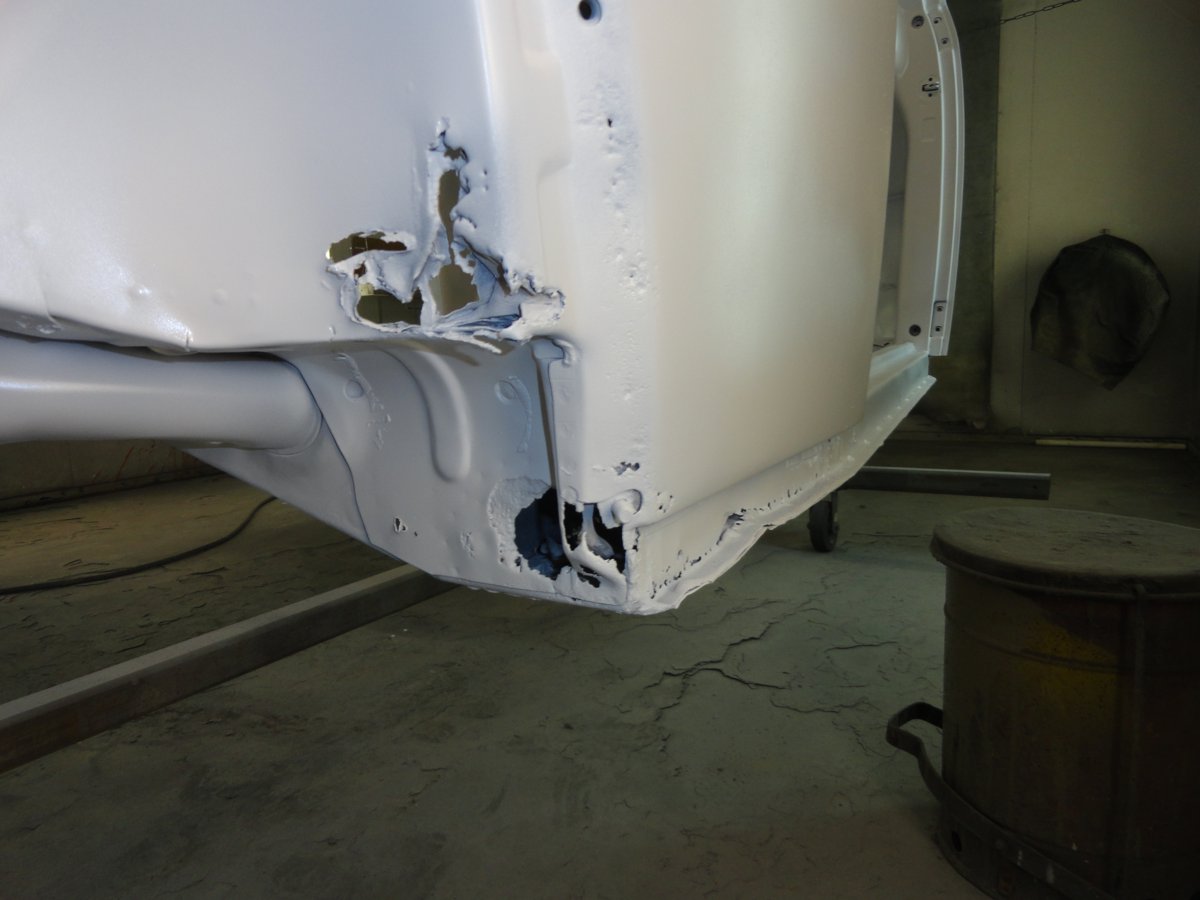

The car came back from the blaster today. It got both the sand and soda treatment. We took all the paint off from top to bottom. No real surprises, just a lot of rust that we knew was there. I'm not so sure this car doesn't have some Swiss heritage.
I'll be looking at some donor metal this weekend, hopefully I'll find something solid.
The luggage tray looked good but what is all that sunshine coming from the bottom right Crying or Very sad
Front clip looks good but the heater channels are toast.
Dash is in good shape and the A pillars are solid.
Clean metal top to bottom.
Looks like it needs a little pull on the drivers side.

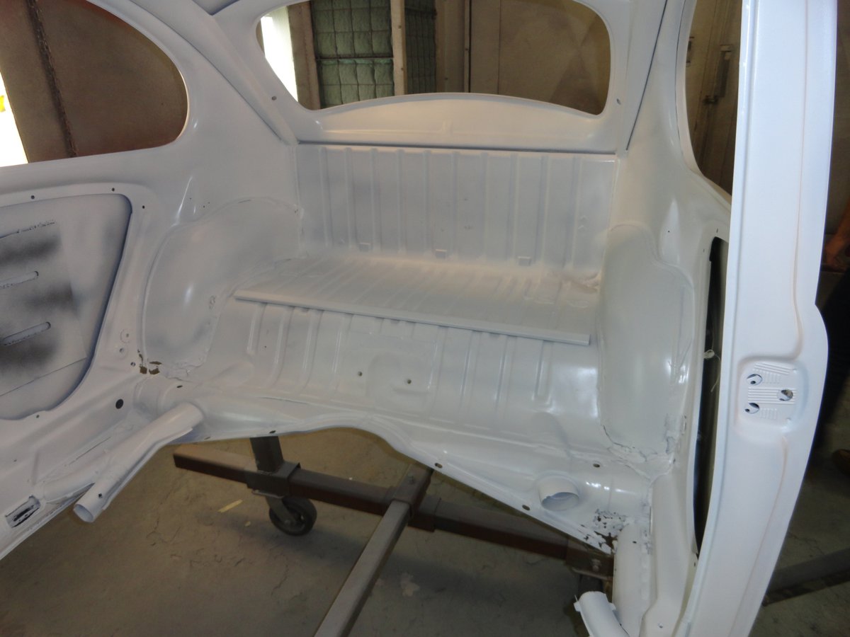

We got the epoxy primer on. Now it's time to look for the donor metal I need.

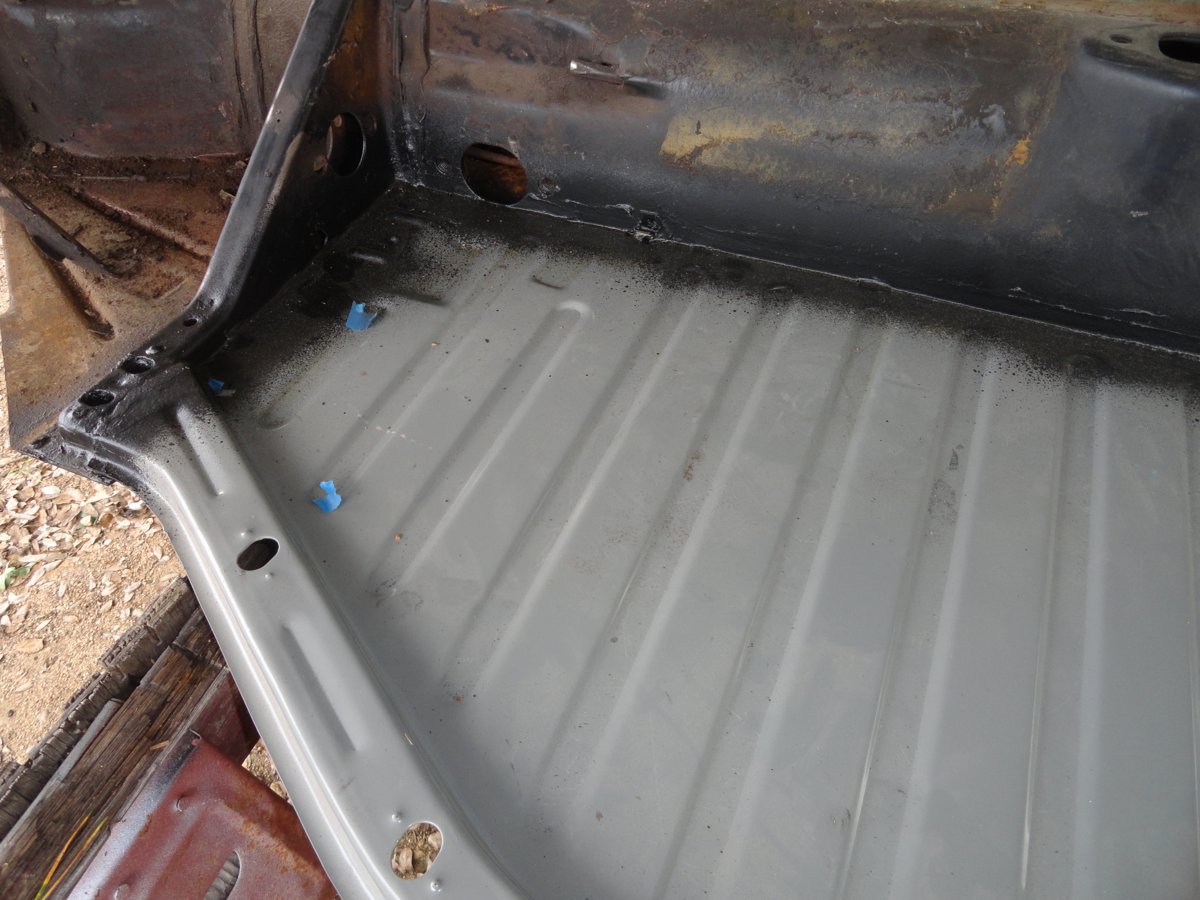

Oh boy. We are like twins!
Your passenger's side:
My driver's side before being fixed:

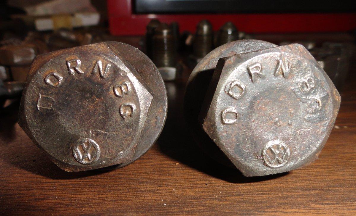

I got the pan ready to go to the powdercoater. While I'm waiting, today I wirewheeled all the original hardware.
The VW logo-ed tranny bolts are pretty cool. Cool

Want to make that hardware look brand new? Throw it all in a plastic jug and fill it with molasses and let it soak for a couple weeks......comes out shiny and clean. The mix is one part molasses and ten parts water. It may smell a little funky but its cheap, it works good and washes off with a plain old wire brush and water.
Yeah, the molasses trick works - even a two-night soak helps a ton. It's an old trick that hanging oil lantern refurbishers use. Makes an amazing difference!
