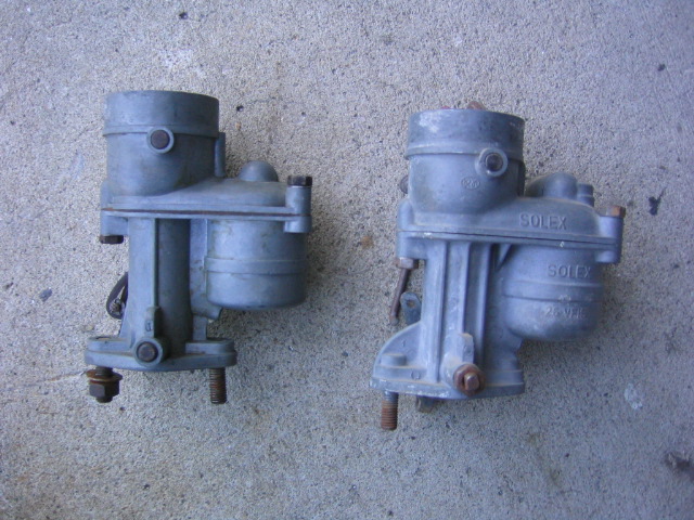

I've got a HuF carburetor on my '47 as well. Here's a pic of mine (Left side) next to a later Solex 26VFIS carb

PostPosted: Sun Aug 03, 2008 11:10 am    Post subject: carb Reply with quote
Great thanks Rareair, looks like I got lucky. One quick question about the linkage, is it the same as the solex, ie the same length and secured at the back in the same way ?

PostPosted: Sun Aug 03, 2008 2:42 pm    Post subject: Reply with quote
The linkage on mine is attachd with a series of springs, washers & a cotter pin

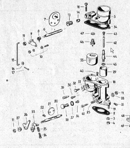

Ok cheers thats helpful info, anyone have a parts diagram for a 26VFI ?
Thanks
Kev
HeSa
Joined: January 15, 2007
Posts: 466
Location: FINLAND
HeSa is offline
PostPosted: Sun Aug 24, 2008 3:31 pm    Post subject: Reply with quote
Here are pictures from 46 and 49 parts books. The one from 49 looks like yours. Send me a pm with your email if you want bigger pictures.
