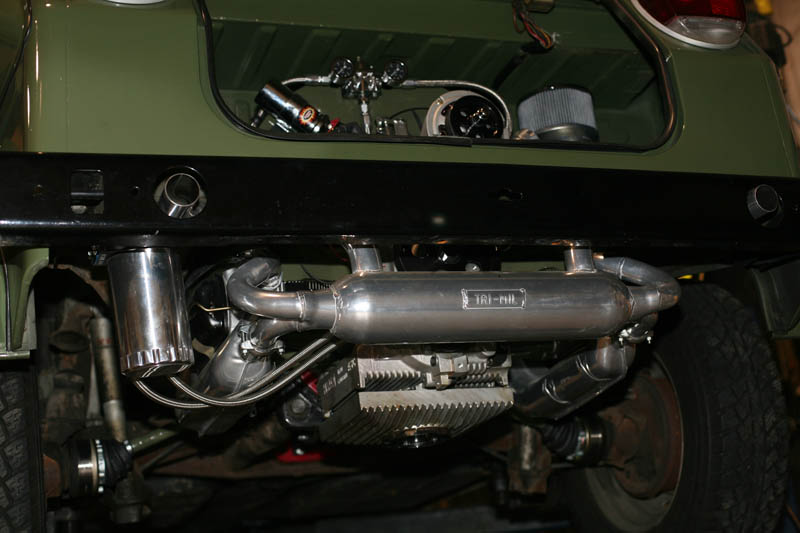

Here you can see my Tri-Mil exhaust is at the same height as the heater boxes. The bumper on the Thing is positioned at the middle of the engine case so the bottom of your engine is hanging below the bumper as well. Even with the addition of a sump and remote oil filter (about the same height as the outer CVs) I have never had any issues with clearance and have driven in the mud, over curbs, etc.
I think the only way you would have any clearance issues with the exhaust is if you lowered your Thing, and even then it would depend on the road and how the car was driven. Hope this helps.

You can find the Tri-Mil on eBay, here in the Samba classifieds or from ISP West Auto Parts. The ceramic coating on mine has started to rust through in very small areas, but it's holding up OK overall. I keep it garaged, but the humidity during the summer is pretty brutal.

Yeah, the Tri-Mil is a pretty loud set up. Not Harley loud, but close enough to irritate my neighbors when I'm leaving for a show early on a Sunday morning. Very Happy It's a deep loud. It doesn't sound like a typical VW and I kind of like it like that.
I went with the Tri-Mil for the performance. A stock muffler wasn't going to cut it with my set up. Performance has been good overall with that exhaust.
