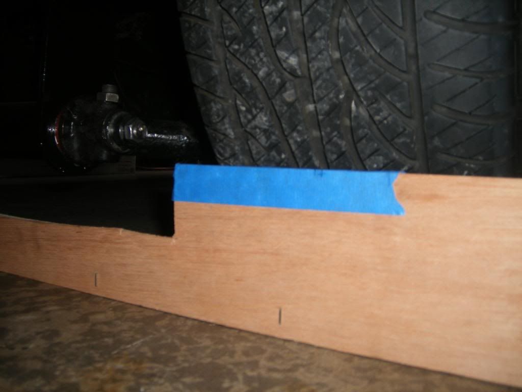

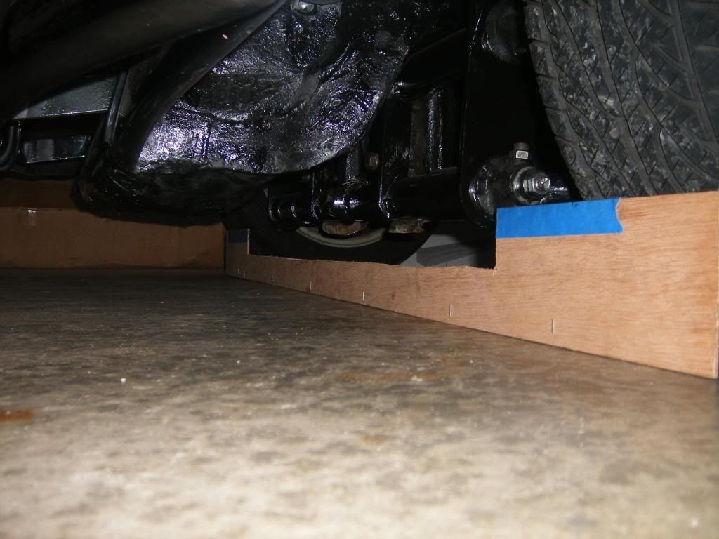

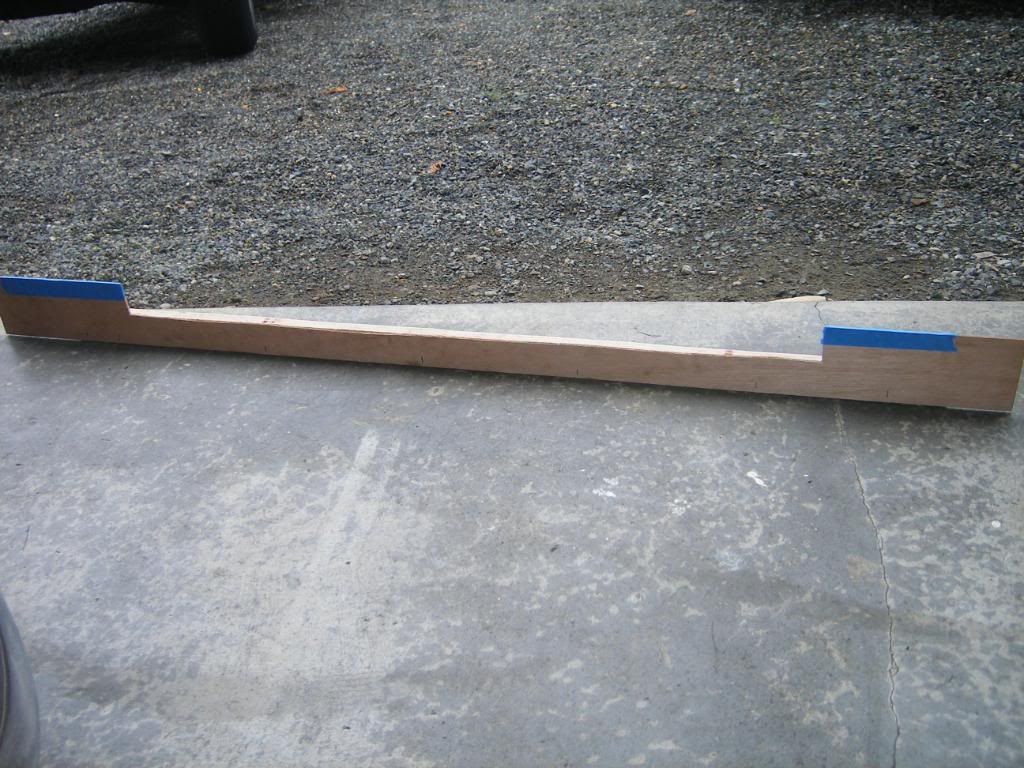

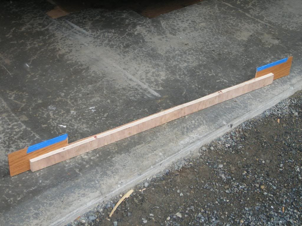

I use one long 2x2, the width of the car, with wood paneling attached to each end about the width of the tires and as tall as about halfway up the tires. I make a mark on both pieces of paneling next to a fixed spot on the rear of each tire. Then I move my contraption to the front of the tires and see where the marks are. I adjust accordingly. It's very easy actually, no strings no jack stands, no measureing tapes and no ramps. And it's all a one man opperation, I just have to go back and forth from each side of the car. I keep putting the contraption on the front and back of the tires until the marks are about 1/8 inch smaller on the front

This is what I was talking about two posts earlier. This is Version 1.0. Version 2.0 will have the two end sections a little taller so they go further up the tire, to make the measurements more precise.
Very good idea! Applause
The only thing I would change would be the height where the measurements are done, might be more accurate.

No worries, I'm not sure how high I want to make it though. If I go too high it will be very difficult to see the markings when it is placed on the rear of the tires.
