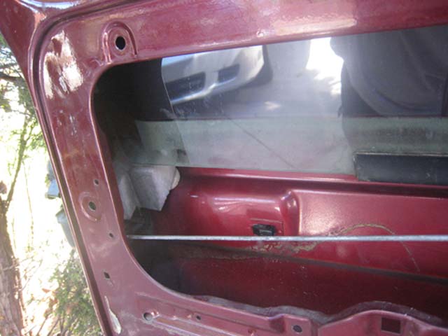

Hello guys! I took the door panel off today to see what s going on inside of my door since I ve had the same problem. I first inspected the u shaped metal channel where glass sits. rubber inside the metal was good looking and glass was fsitting firm inside of it but the metal channel assembly felt a little loose from the guide rail. Next thing I inspected was the felt material (scraper?)in the window trim. it was all worn and I could see space between the glass and the scraper. It probably was never replaced before. I tried to replace the whole thing inside the window trim before but quit due to the expensive parts. So this is what I did to fix the problem today and it's rock solid now. Very Happy
Take the door inside panel off. If you feel around at the bottom of the door cavity you will probably find a 1"-2" square piece of felt. It should be glued back in place
mine was still in place but noticed pretty worn. Instead replacing it, I just peeled it off from the door, put 3M double sided taped (1/16" thick) on the back of the old felt piece , and put back on where it came off from. Now that felt piece is about 1/16 " thicker and gave a good contact on the rear side edge of the glass. That fixed about 50% of my problem. The window didn't move back and forth by itself anymore but I could move it back and forth with my hand easily. So the next thing I did was to give a good contact between the glass and the white foam which is glued on close to the felt piece to support the outer side of the window. I shoved two pieces of felt in the back of the foam to push out the foam towards me to compensate the worn loss. the foam was originally glued on to the door but I was still able to slide in the felt pieces.
After this, I WASN'T able to rock the window back and forth easily WITH my hands anymore. Cool
However, this fix was only good until the window was 2/3 up the way. As the widow closes more, the bottom portion of the glass leaves the white foam support and nothing is supporting it any more. Mad
so this is the fix to support the glass when the glass is up more than 2/3 way. I cut out a felt peice so that it fits tightly inside of the worn window trim. I fixed it. my window doesn't rock back and forth anymore no matter where the glass is located. Very Happy Very Happy
The felt piece should have been black but that was only color that I found from my tool shed. Laughing

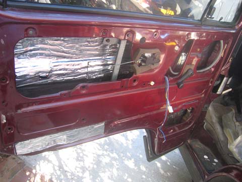

While at it I finished the sound deadning project on the door with raam mat and it really made the door feel solid.
