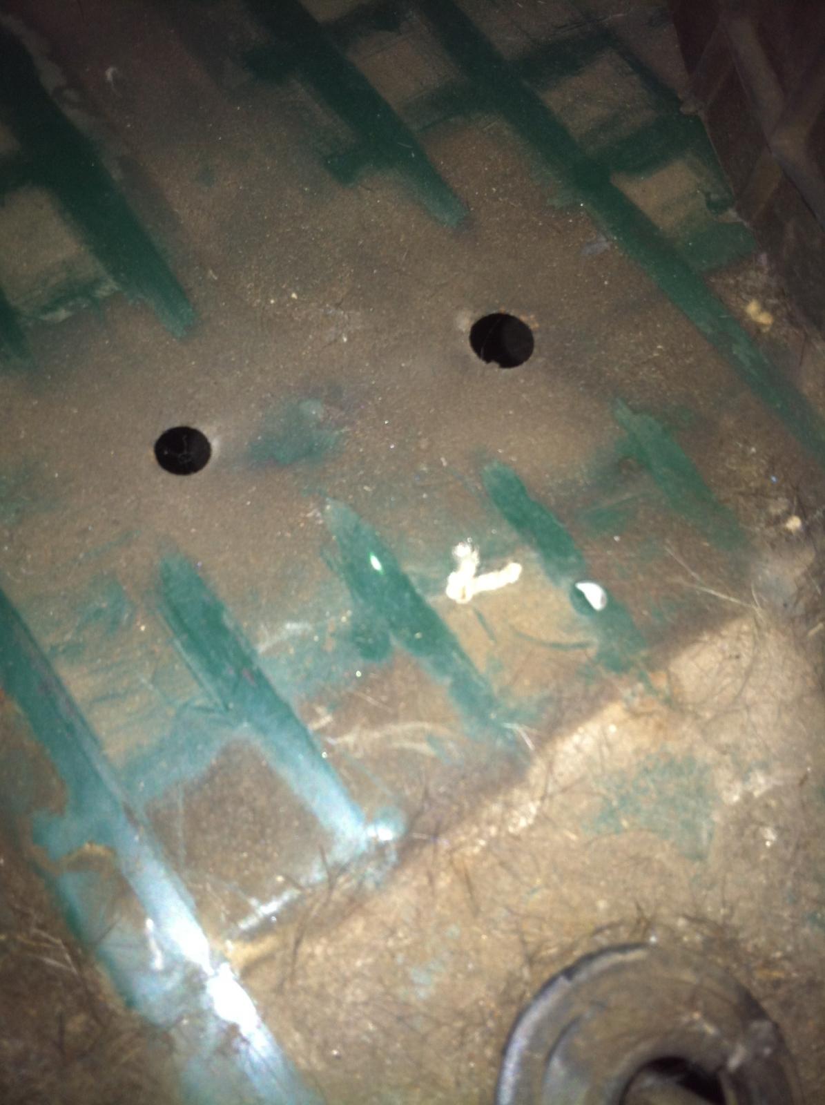

I read through all the previous post on this subject and still have some questions.
Is my spring broken? Does this spring actually provide pressure to push your pedal back up? Or is all the return provided by the spring on the carburetor?
I also have this a few other things on my floor that may be PO hacks.
here are pics.
In the first one I figured out I'm missing the retaining spring that holds the rod to the pedal, that I will order and replace.
This second pic is where I suspect the PO did some crazy brake light switch rigging I fixed the wiring in a previous post, but want to know what is supposed to go in the holes where this switch is. And what is that little white plastic thing coming through the floor as well?
This third pic shows the hole for the gas pedal stop, does any make these yet? I saw Busok made them, but think they are not selling these any more.
And the last picture is of the hing under the gas pedal. Trying to figure out if the little metal tab is broken or if that is the correct size? It doesn't seem to do anything. Perhaps it just keeps the pin from sliding out? But I can't seem to get the pin out anyways. Does the pedal also have a spring that sells at Bus Depot?
The whole reason I even have these questions is because, i just put dual empi carbs and my throttle cable is sticking. I had this problem before when ever I put the throttle cable guide tube all the way through the fan shroud, when I didn't push it all the way through the throttle cable moved more freely. Any suggestions on how to get cable to move more freely so my carbs will return to closed position fully.

Those two holes are for the accelerator pedal stop
http://m.ebay.com/itm/VW-Bay-Window-Bus-Accelerato...1074330371
I would service the pedal assembly and check the pedal linkage as well. Worn rust parts is your problem. You may also be able to get a stronger return spring for your carbs

Wolfsburg west has a complete package to fix all of that.. Might as well take the time and replace the worn parts. You can replace everything from the pedal back to the throttle linkage for around $30 or less.. The pedal pin looks pretty crusty.
The pedal return spring looks the right size, it's just not in the right spot.
