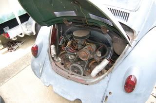

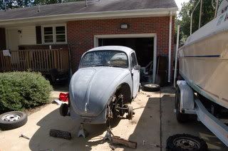

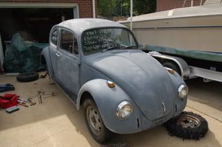

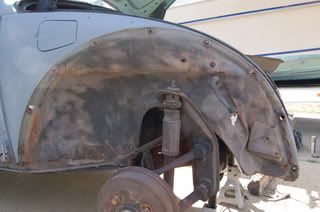

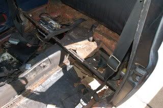

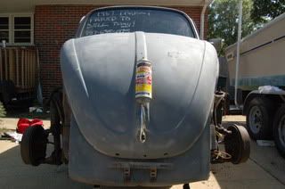

made a little progress today. got all the fenders off and assesed the cancer. its a little worse than i was hoping for but i'm not looking for a show winner. it took some work but i got all the bolts for the body broken free. i'll lift the body next weekend and get ready for the pans. i'll probably end up doing heater channels the rear deck and the rear apron aswell. it dosent look like much but its the only project i could afford and i cant wait to get a little deeper into it. here are some pics. let me know what you all think.
pb blaster is my friend!!
i also found out the car was built in january of 68. it still seems to have a good mix of the two years. how can i determine what size the motor is?

first nice ride doesnt look that bad those refenders look to be 67or older the engine you need to look for the engine code its under the generator stand it should have a letter first then numbers i have replaced my heater chanels and door posts and pans with the body on its not that bad Very Happy Laughing

I like that you have the older tail lights, nice.
As far as the size of the engine you can't really find out without tearing it apart and measuring. You can tell though if it's single port or dual port. single port has a one piece intake manifold and dual port has a 3 piece with rubber boots. Stock for your car is a 1500SP (single port)
Also you can check the case # to see when it wasfirst made.

nope, you need to get '68 body pieces, you can tell because the slots for the bumper mounts are on the fender and not the body.
