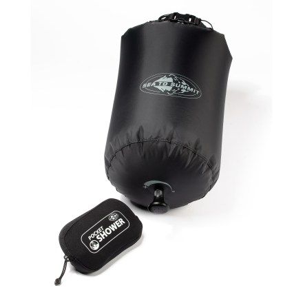

Im interested in this version of a shower:
http://www.rei.com/product/758045
It looks much more compact, and might have a big mouth on top, easier to pour hot water into.

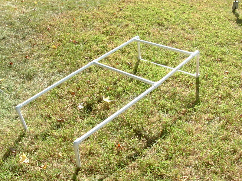

I posted some info on this about a month ago. I built a PVC frame that rests on the upper bunk on one side and the metal roof in front of the pop top latch on the other.
A 6X10 blue plastic tarp serves as the shower curtain and attaches to the frame about 6 feet off of the ground and rests in the bottom of a plastic mortar tub from Lowe's.
For water I fill a 2 gallon pump sprayer half full with with water from the tank, and then boil a coffee pot full of water and pour that in there as well. The temperature is perfect and if you get a decent pump sprayer and pump it good you will get an entire shower in without re-pumping.
For the shower head I bought a replacement dishwashing spray nozzle which screwed directly into the wand of the sprayer with no leaks. The pump sprayer is placed on the stove sink counter on a piece of rubber.
Setup time for the shower enclosure is about 10 minutes - however, I get the water boiled before setting up so there is no chance of burning the camper down with the flame from the stove.
Also I have a bag from REI that holds my shampoo/soap etc that i hang from the cross member.
Would I use this setup if I were camping in the woods in solitude? Of course not. However, for the times I am in an organized campground I find it perfect as everything is contained inside the camper - no setting up a shower bag on the roof with tarps hanging down from the back and walking outside or climbing in thry the back hatch etc.. Just shower and get dressed - just like home.
