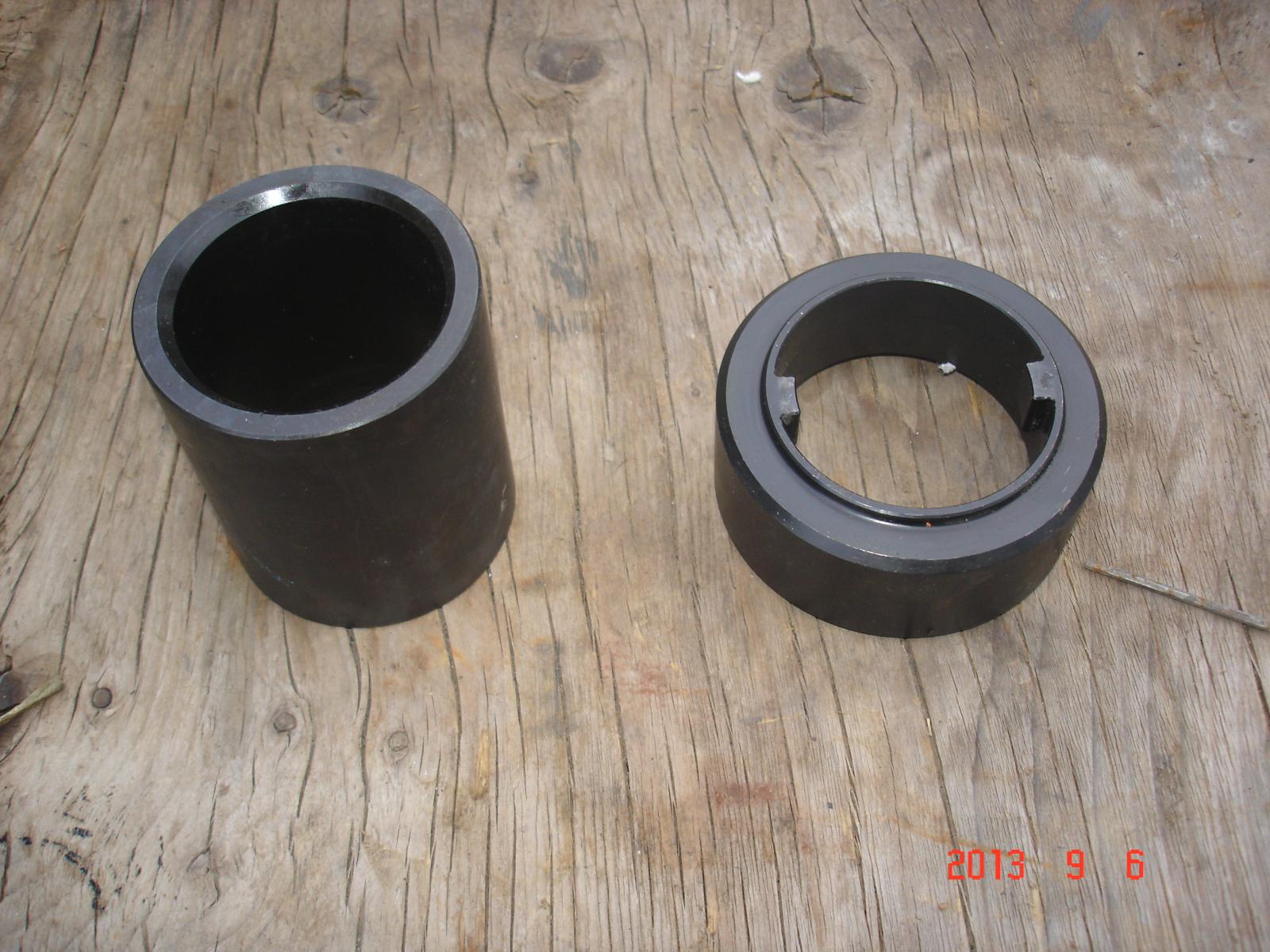

Ok well I got my vw459/1/2 today and they worked awesome but I also need vw471 which is the peening tool. http://vw.snapon.com/SpecialToolsDetail.aspx?type=Tools&ItemId=11190008 I did however notice that one of my ball joints was not peened on the bottom when removing it and it pushed out easier then the peened ones and might have been replaced at some point and that the shaft of the ball joint was too high and higher then the VW tool and I needed to add a metal washer at the top on each side under the metal plate I was using to push the . The removal was a piece of cake but installing them and supporting the bottom by a metal plate on both sides is not easy. One of my support bars moved slightly inward and slightly flattened the metal bottom ridge. I also tried to install a grease nipple and I don't recommend it on flat bottom ball joints. There is only 1mm of material and then the ball is tight to the cup so there is no room.

Does the 7249 work well with bus ball joints borninabus? Our shop has one of these for VW cars (bugs, Karmann Ghias, etc) and it works well, but we always thought that the bus ones were so much more heavy duty that the torsion arms had to be pulled out and it had to be done in a hydraulic press. If that c-press works then that would speed things up significantly.

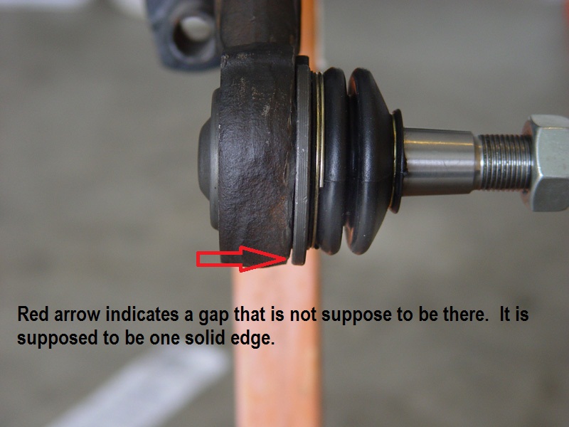

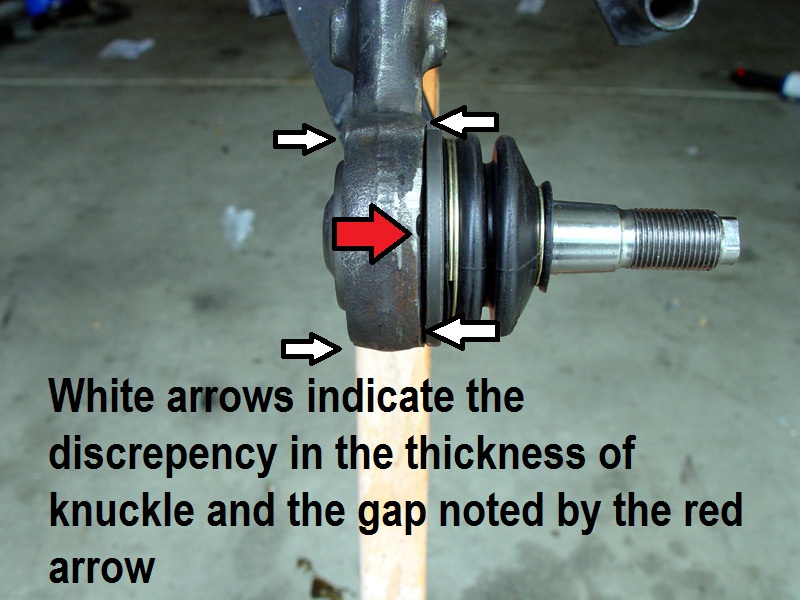

PostPosted: Fri Sep 06, 2013 11:16 pm    Post subject: Re: Pressing in ball joints-Busted two collars Reply with quote
shiningstar76 wrote:
I bought VW 459, and got them out just fine. But I broke one ball joint collar installing the first, then added a lot of heat and went easy on the second, and ruined that one too. How are these pressed in without destroying the ball joint collar?????
I don't know how many times I've heard, "never put heat to your arms" and low and behold, the ball joints go in really easy. When these things are forged, these thing are made glowing white hot and applying heat to these things is just a matter of procedure. All you do is just heat them until their hot and then you press the ball joints in. You should see what some joker did to two of my arms when he tried to install ball joints into two arms I gave him.

you will never need heat to press the ball joints into the arm. sometimes a little heat helps in getting them out.
in the original post the OP was not pressing them in properly at first so thought he needed something (heat) to get the joint to seat all the way home. the joints press into the arms with relative ease.

i agree, i have used a little heat to remove them, never to install. GeorgeO...that really sucks.
depending on the company, i have seen the knurl way too big, as if they were oversized. the fix was to put them in a lathe and turn them .001 or so.
i forget when the interference fit is suppose to be. fwiw, i have never peened them either. never had an issue. if they were pressed in the other way around, i could see doing it, but the knuckle pretty much won't allow them to slide out.
Let me rephrase that: A little heat to remove them is a matter of procedure. I stand corrected.
