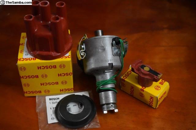

Here's the one that came with your car:
Autositck: https://www.vwnos.com/043-905-205-j
Manual https://www.vwnos.com/043-905-205-h

I sell the 043905205H distributor that was used on 1975-79 bug with either tested good original vacuum canister or a Genuine NOS vacuum canister.
You can see them here- https://www.sparxwerks.com/s/search?q=205H
