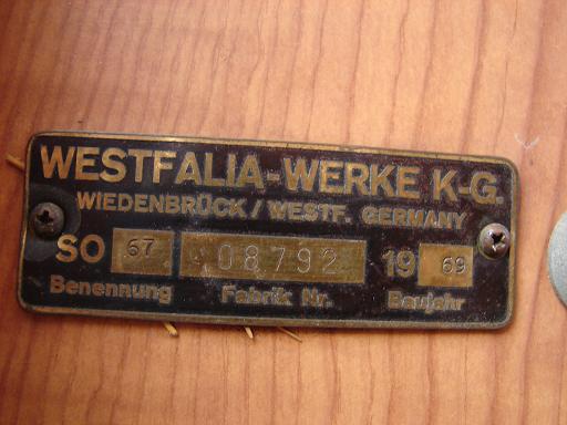

PostPosted: Wed Oct 22, 2008 5:26 pm    Post subject: SO-67 Reply with quote
When I was growing up we had a 69 Westy and I remember that the sink/icebox had a top/sink that was made out of a white plastic material that turned yellow pretty bad (and this was when it was only 15 years old). The table top of the 69 also swung out onto a triangle-shaped prop.

'69 SO67 Westfalia; a 1970 would have a steel top for the sink/icebox, with a white flip down table.
