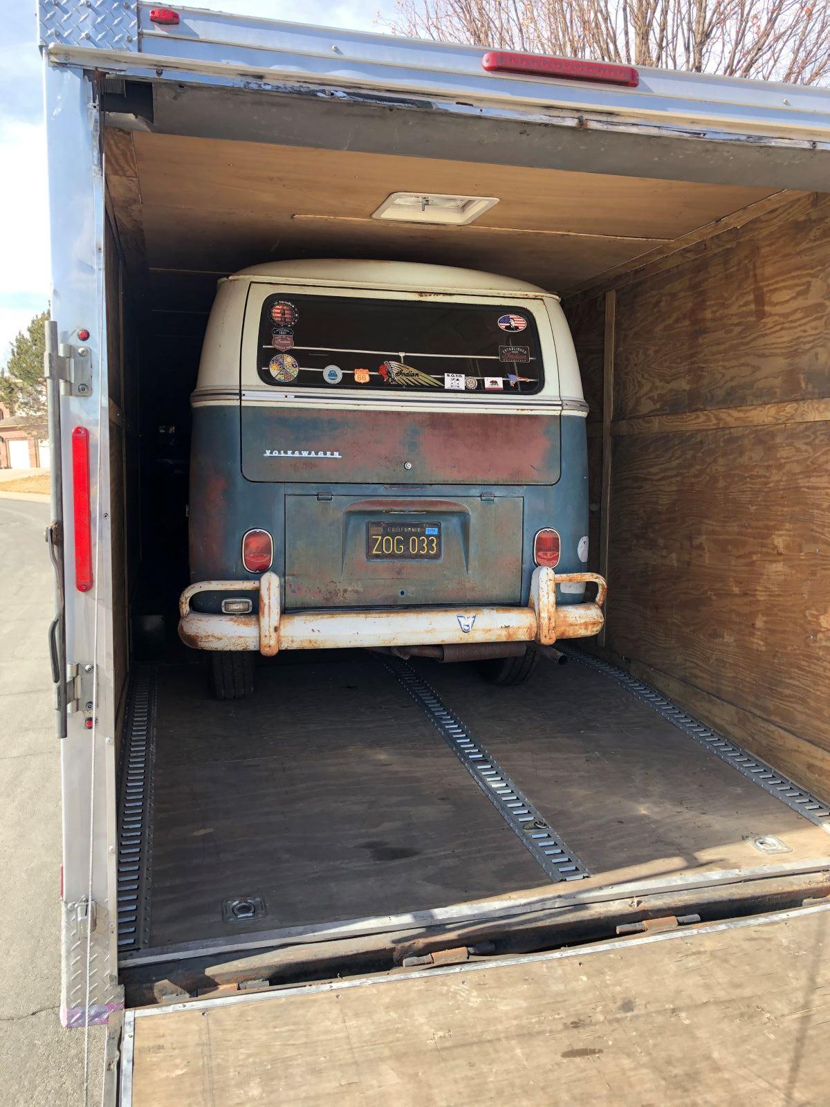

So right before all of this went down, I picked up a new deluxe. Turns out it was heaven sent, since I've had quite a bit of time to work on it...
I got it here on thesamba, and had a little help from Everett to clarify a few m-code options (Thank you again). I really wanted a deluxe walk through, so I bought it at the end of February and took delivery March 6th. Since then I've been doing working on it daily and it's coming along. (I'm documenting it all, and probably already have several hundred pics)
I'm the third owner, the first for 35 years, the second for the last 20, and then me. I plan on keeping it, it's exactly what I've been looking for.
I found it was delivered new in the Bay area to Ely VW and that's where it spent it's whole life prior to me getting it to Colorado.

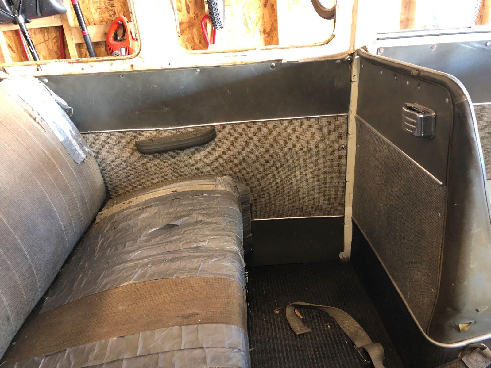

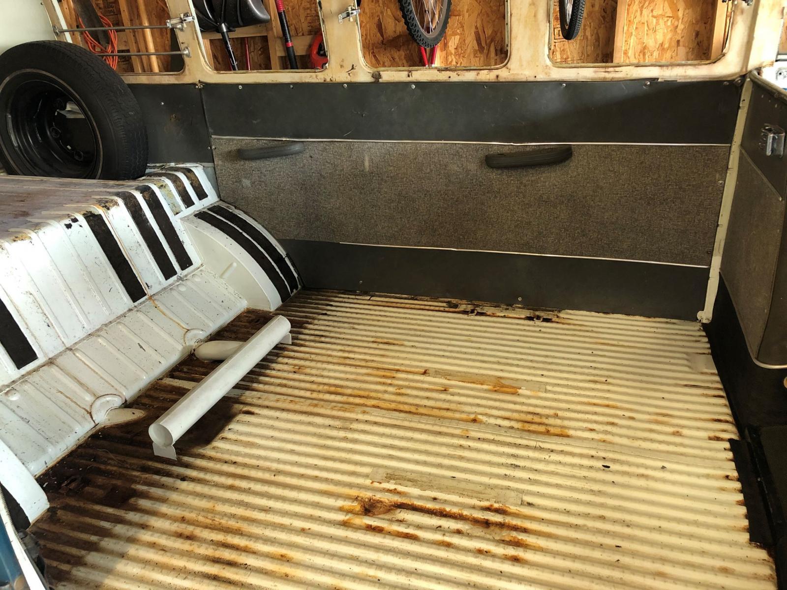

Interior was super complete, original headliner although not very flexible..

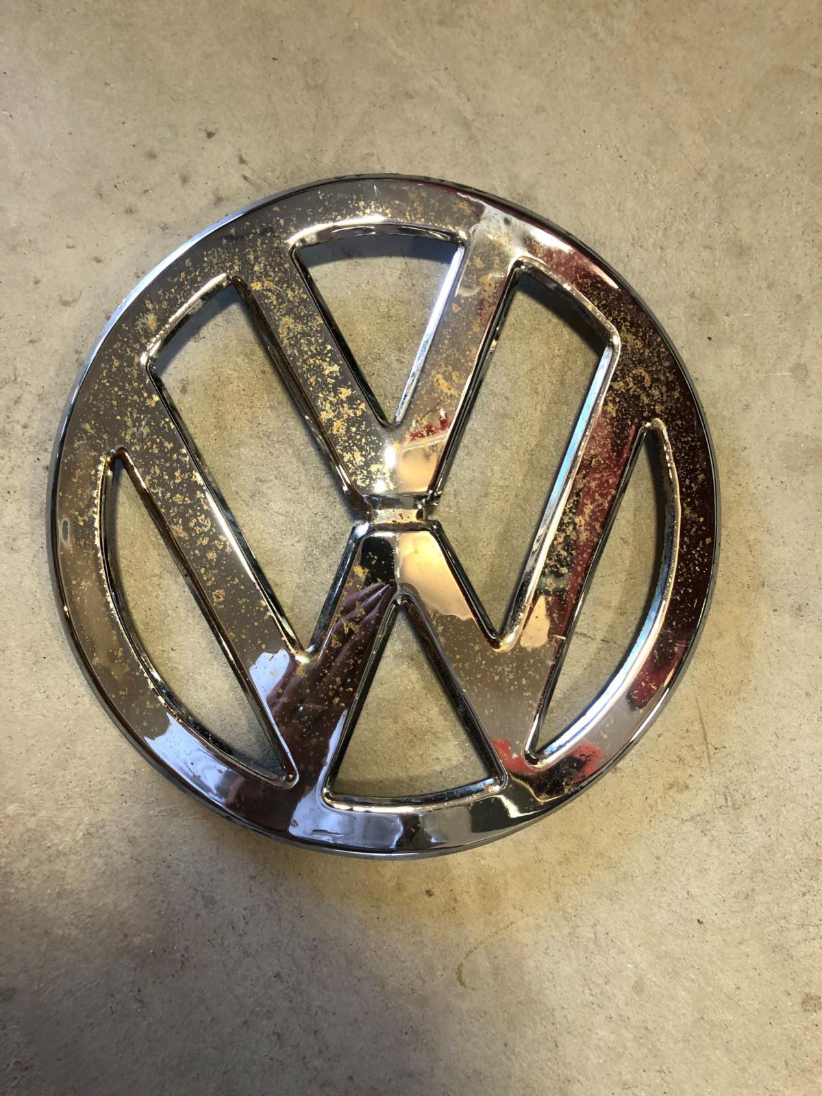

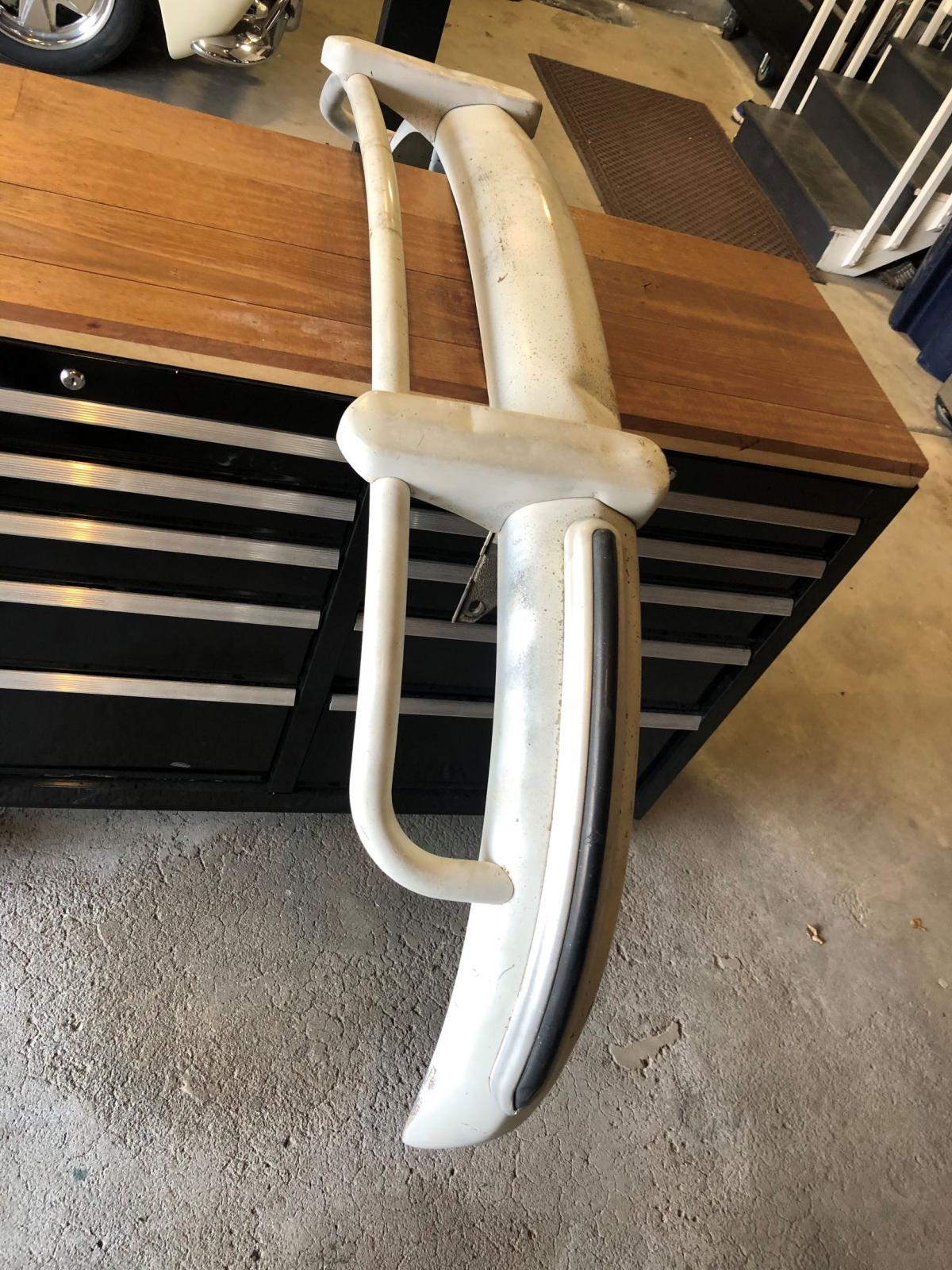

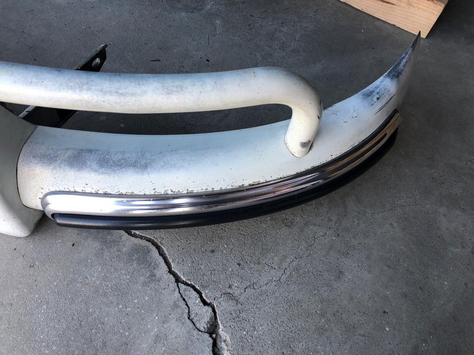

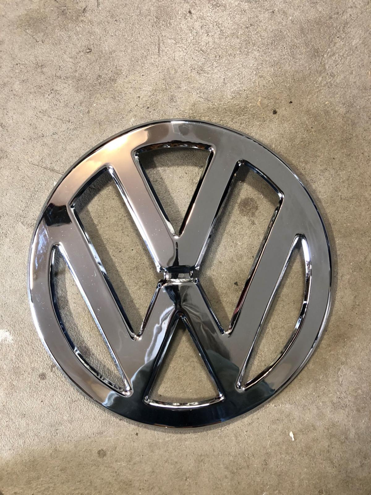

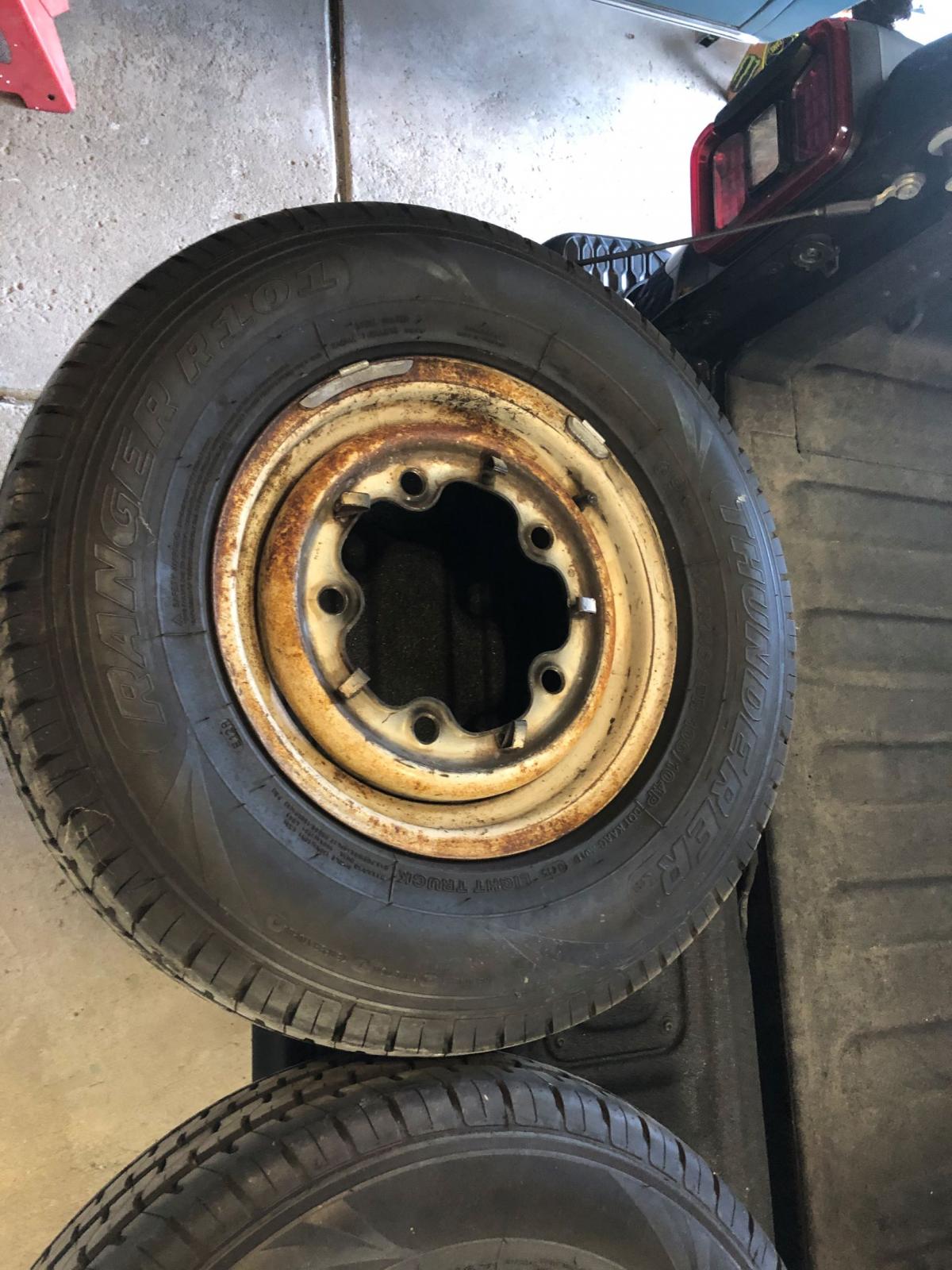

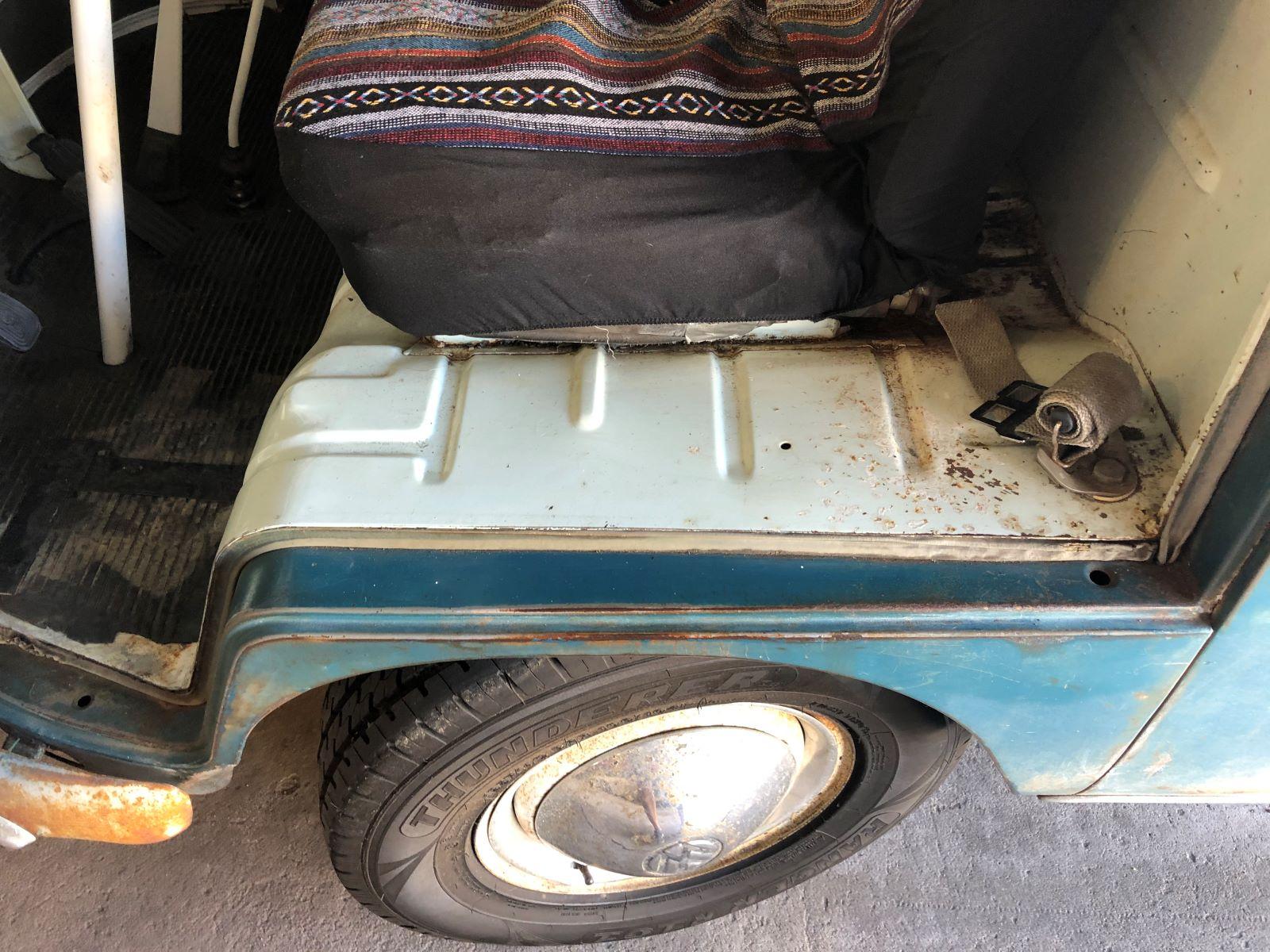

I'm going to jump waayyy ahead in where I'm at to share a paint restoration technique that I've used for years, but I haven't seen talked about here much. By soaking painted or chrome metals in Oxalic acid and water for about 24 hrs, it removes much of the rust.
I did this to the bumpers, the front vw sign, wheels, and pop outs to bring the original paint back.

PostPosted: Fri Apr 17, 2020 2:14 pm    Post subject: Re: New purchase to me, 1965 21 deluxe, semi-build thread Reply with quote
Beauty!
What rust is there to fix? Wink
Looks like a polish/wax detail and some seat covers are the ticket. Very Happy

Wow, those came out great.
What sort of ratio of acid:water do you do?

PostPosted: Fri Apr 17, 2020 5:02 pm    Post subject: Re: New purchase to me, 1965 21 deluxe, semi-build thread Reply with quote
Not much, I used about a cup for the kid pool in the bumper pic. A couple of table spoons in a normal plastic storage sized bin.
Basically I washed all of the parts first with dish soap and water-remove dirt and grease.
Soaked the parts for 24 hrs. 48 for super bad if needed (I didn't go that long)
rinse and wash again.
Wax.
It doesn't hurt stickers, or whatever. Attacks rust pretty much only. I didn't take the deluxe bumper trim off-I left it all together, masked it off, and polished it. That way I didn't have to replace the original rubber within the molding.
look at the top of the water pic, you can see where the rust was removed, this was after maybe 8 hours.

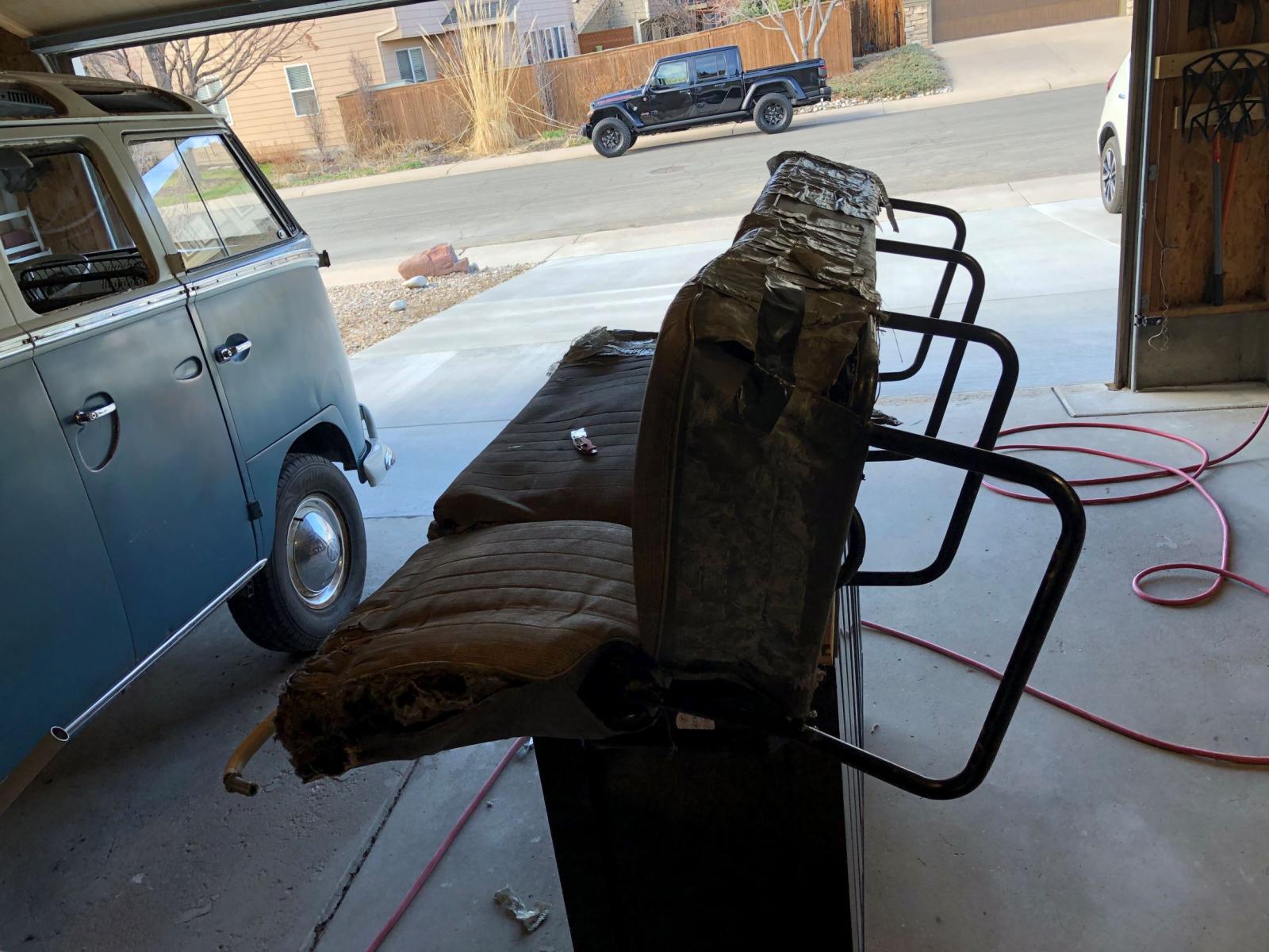

PostPosted: Sat Apr 18, 2020 6:14 pm    Post subject: Re: New purchase to me, 1965 21 deluxe, semi-build thread Reply with quote

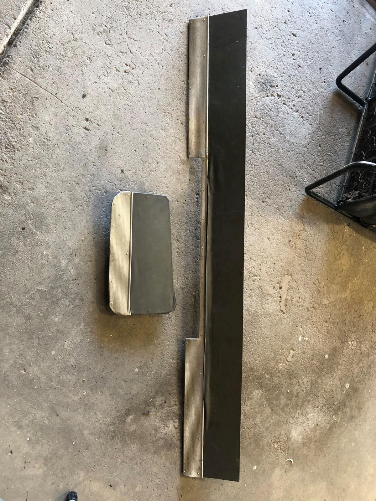

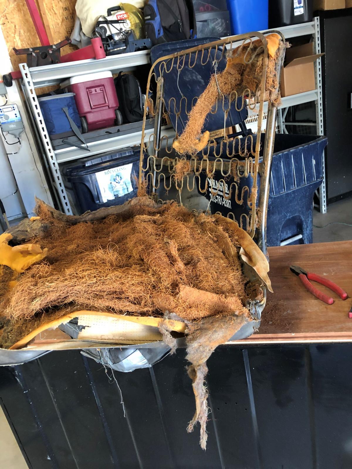

Interior torn down, all seats are excellent except the driver front. I was lucky enough to find another locally that was broken too, but had the parts I needed to fix and have one complete. Original seat upholstery was toast.
