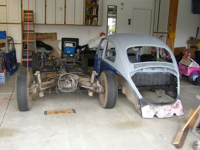

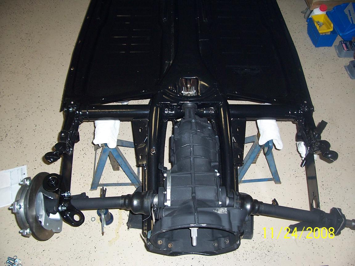

Here is photos of the difference in length between a long axle (left) and a short axle (right):

If it was a 1970, it would have IRS and are not compatible with swingaxles.
The IRS uses CV joints and double jointed axles.
1969 and later Beetles/Ghia/Type III and 1968 Autostick Beetle/Ghia used the IRS transaxle.
Standard 1968 Beetles/Ghia/Type III and earlier used Swingaxle transaxle.
This is a Swingaxle design (axle pivots at at the tranny where the boot is), so when raised or lowered, you'll have positive/negative camber at the wheels/tires:
This is a IRS transaxle design (notice the axle is like double jointed), the wheels/tires stays perpendicular to the ground:

what do you use to paint the tranny black
werka
Joined: August 25, 2006
Posts: 1110
Location: Huntsville, AL
werka is offline
PostPosted: Mon Dec 01, 2008 9:48 am    Post subject: Reply with quote
How many spotless chassis's do you have Banzai KG?
Damn.
Banzai KG
Joined: April 10, 2004
Posts: 2992
Location: Sunnyvale, CA
Banzai KG is offline
PostPosted: Mon Dec 01, 2008 10:01 am    Post subject: Reply with quote
I have none spotless chassis.
Those pics I posted are from TheSamba Gallery, just did a "search" and pasted them here.
