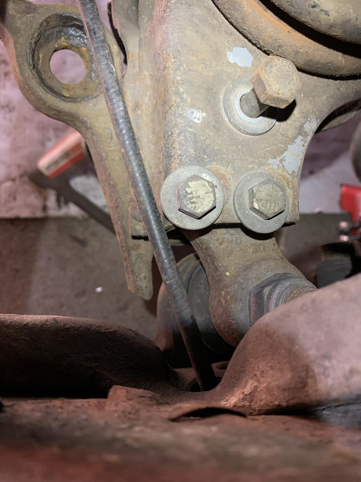

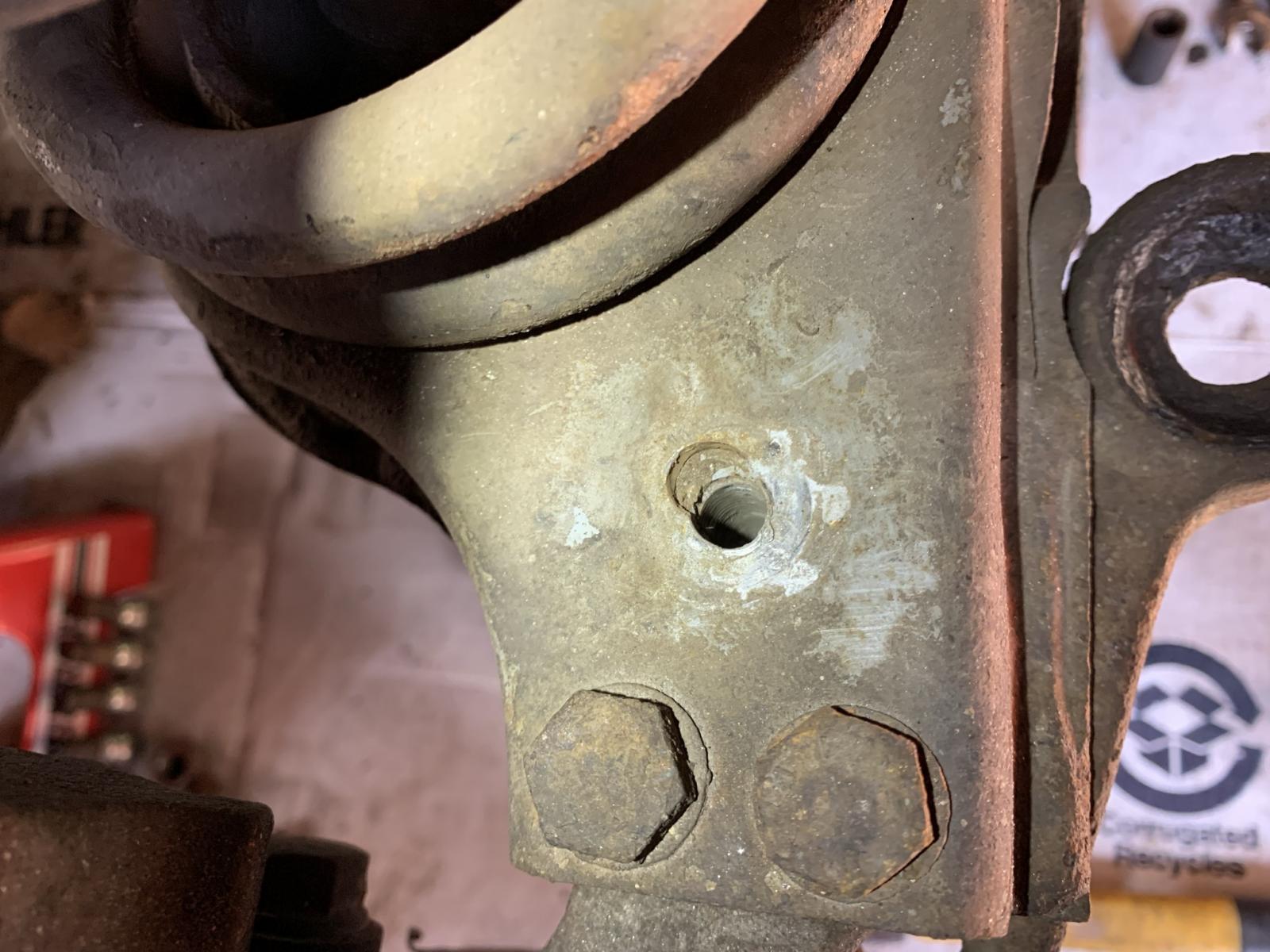

I'm finally getting around to doing some front suspension work on my '85 Westy (mfg date 09/84). I got the full Powerflex bushing kit from t3technique and began taking things apart, starting with the radius rods. I realized my van is one of the last with the old style radius rods that bolt to the bottom of the lower control arm with bolts going through the whole arm, so I started unbolting those. That's when I found trouble. Here's the passenger's side:
Notice it looks like someone drilled a new hole offset from the original location. The two bolts pictured look original, but the third bolt (removed) was different and installed upside down with the nut on top.
Things got worse on the driver's side. Check this out:

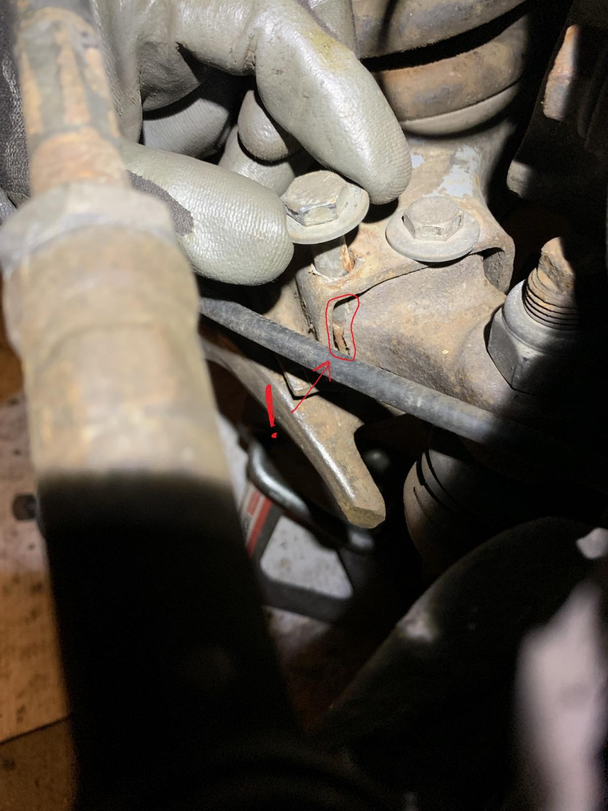

Small imperial (9/16") bolts with huge washers under them. Okay, maybe someone broke a bolt and replaced it with something they had lying around. But wait. Look from the side:
The forward bolt looks like it's slipping off the top surface! After unbolting the nut and hammering it upwards, I noticed something obvious I missed before:
The bolt is sticking through!
I'm trying to find the name of this part that receives the lower ball joint and bolts into the lower control arm. Please tell me if you know. The Bentley doesn't label it that I can see.
I'm not sure how I should proceed now. I'm worried if I take out the bolts (they're quite stuck) I won't get them back in and will not be able to reassembly anything until I can source new parts. But I'm not sure what I need to replace yet. I'm hoping the lower control arms can be welded, but that other part looks butchered.

AFAIK, those bolts holding rod to LCA never really need to be removed. Trying to turn the original rusted in place bolts can result in a head snapped off. BTDT. No fun. I'd guess the PO ran into the same issue.
The radius rod should eventually separate from lower control arms. I applied penetrating fluid and worked my way around the join with a cold chisel to help get the rods off arm. From the factory, the nuts on those bolts are an "always replace" item; they're lock nuts.
The Bentley diagram should show this part name but the part connecting lower ball joint to arm is called 'lower ball joint adaptor' IIRC. For sure the word "adaptor" is in description.
At minimum, get good used adaptors. If it was me, I'd find a parts van and try to get a good low price on radius rod, LCA, knuckle, remove those as "one piece" then install arms with adaptors.

Thank you, Neil and vanis13. I used the term "lower ball joint adapter" and found this VW parts page, which calls it a "ball joint retainer (lower)". Looks like I can buy a new left-side version for $57.60, so that's not too bad. I am surprised but somewhat relieved nobody had as strong a reaction as I did to the fact that the bolt is visible out the side of the ball joint retainer.

Wouldn't cost that much to rebuild. Looks like east coast rust has eaten that radius arm or badly drilled out bolt.

Though I'm an amateur wrench at best, and had less skills at that time, I found it "impossible" to drill out the broken remainder of factory bolts at adaptor. (can't recall if I tried using a drill press or not). It's possible a PO of your van ran into the same issue. To my eye, it appears that damaged hole is drilled too close to OD of adaptor. Another hole shown also appears to have been drilled off to one side of OE bolt metal.
Once you improve the front end, if the brakes are in good shape, you may find braking and handling of OE design to be ok. This is what I found. I have NOS SA brakes, used later spindles etc slated for that van, still in boxes.
