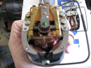

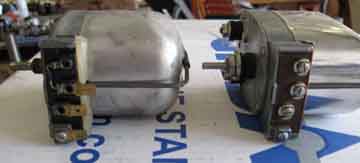

I am posting some pics of a 200 series rear window wiper motor that I pulled out of a car at pic and pull. The motor on the left is a lowlight 57 motor that I restored. These motors look to be a direct swap with a brush swap. The Volvo motor is a single speed 12 volt motor. You could pull the armature out of it for your conversion or swap the brush/ connector setup and bottom cover and be good to go with 12 volt. They had it listed for 21.00. They guy at the counter had a super beetle and thought he was an expert on bugs and charged me 9.00 for my "regulator"

It is not a straight bolt on. You need to remove the cap on your motor. Then you can do it two ways. take the Volvo motor cap off. remove the brushes. Take out the armature. Do the same thing to your motor and put the armature from the Volvo motor into your motor. The other way is harder and more work. You take the brushes and wire connector from your motor and put it on the Volvo motor. Then take your bottom cover from your motor and put it on the Volvo motor. If you want me to do it pm me and we can work somthing out. Its not too hard of job and your motor probably need new grease anyway.

If you are referring to the spring on the brushes, the one on your motor might work? I have not torn it apart yet.

I found mine on a 240. I looked at 740 but the motor was gone. I believe that they are on 200 series wagons. To clarify it again, it is the "rear" wiper motor. The one I removed was primo. They don't get banged around and so the top cover is like new.
