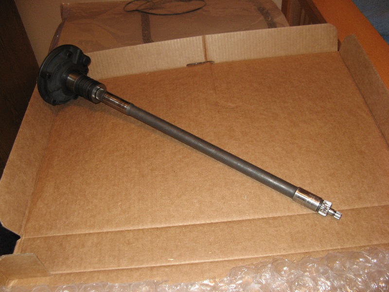

After putting on some new webers i found that my trans would not engage. i pulled the engine/trans and then separated them. I found that the innermost gear on the torque converter was chewed up but only at the end. I pulled the shaft and it looked fine. After researching it looks like the wrong rod was installed and thus is too short. (made for type three or 411/412?)
My first question is this, with the rod installed in the transmission should all three rods line up?- in length i mean. My pump shaft is shorter than the other two:
(looks like this, cross-section)
My second question is where i could find the right shaft... It seems like others on here have had problems locating one. Anybody have one or know where to get one? The correct length would be 21 11/16" I believe.

Your outer shaft (turbine shaft) should be 18". The inner shaft (pump shaft) is 21 11/16". When assembled the inner shaft extends beyond the outer by about 3/4".

Found the shaft...
I got it from Long enterprises
(707) 829- 1169 phone
Hours: Monday-Thursday 9-5 (Pacific Time)
I found them to be helpful and knowledgeable, but a bit pricey.
I guess beggars can't be choosers

PostPosted: Mon Jan 12, 2009 6:27 pm    Post subject: Reply with quote
And the sent the wrong part... Thanks so much Long enterprises. I cant believe after a 5 minute chat about the different lengths off 003 tranny pump shafts the actually sent me the wrong one. measuring 19 15/16". They are closed so i'll be calling them tommorow
