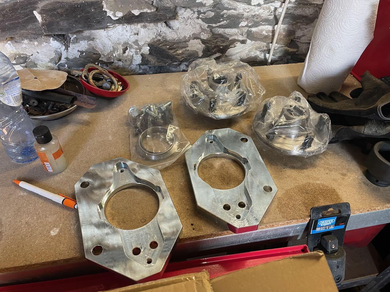

I need to swap the rear bearing carriers and install new inner and outer bearings. Bentley shows using special VW tool and a press... neither of which I have.
Can this be done in a sensible way without a press or should I just drop it to my local workshop?
(long story - the westie I have has Oettinger style rear disc conversion with internal drum parking brake but some components are damaged and sourcing replacements has proved impossible - so am swapping to Epytec rear brake conversion - but the rear bearing carriers have been modified to suit the (BMW?) backing plates used by Oettinger....
So, after sourcing some rear carrier (with the rare ABS sensor mount) I have to swap the whole thing out....)

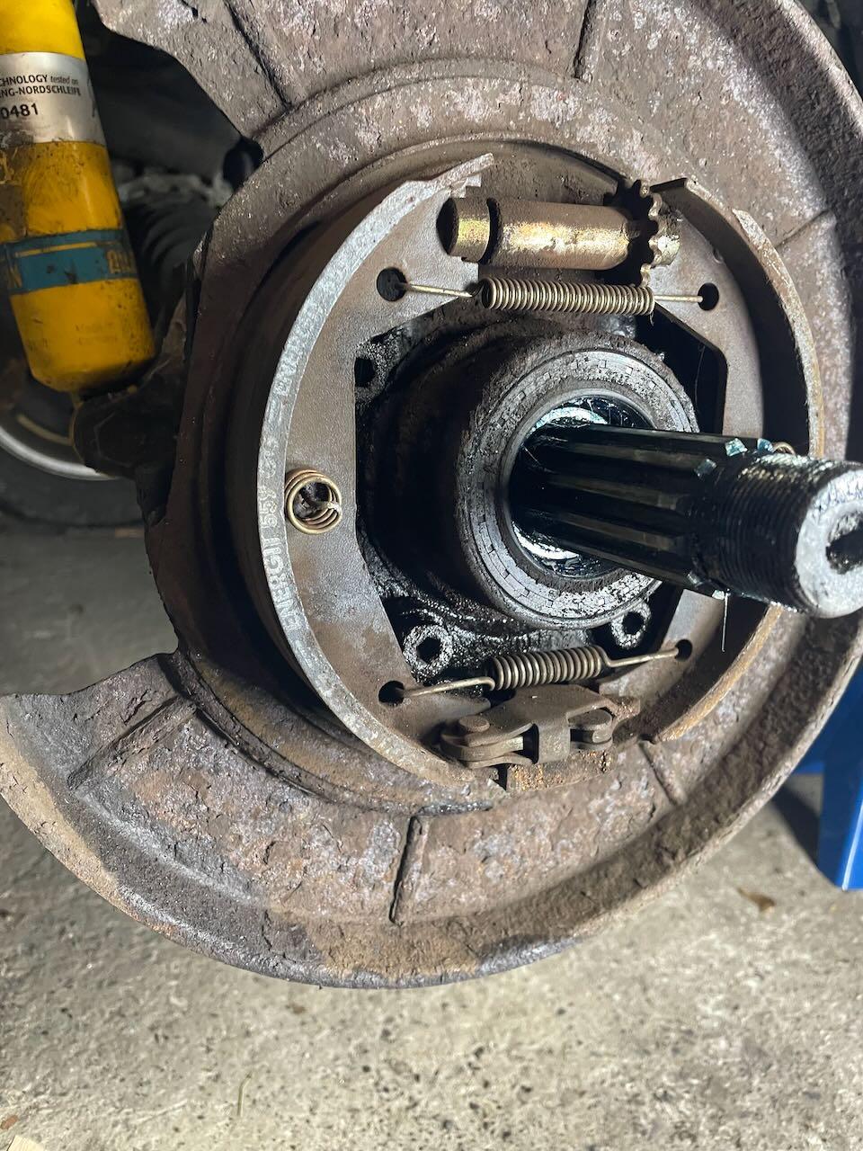

Now this is cool, first I've heard of this style rear brake.
Which parts are you having trouble sourcing?

Wow, thank you so much for posting pictures, I've been wanting to see that for 20 years!
The hub seems cast specifically for this set up! Interesting.

The rear brake set up uses an internal drum for parking brake and outer disc rotor, there is a 'foot' that the parking brake cable lever acts on that fractured and as a cast piece has been a pain to get repaired. Finding what the original parts were from has proved elusive, some appear to be BMW e12/e23 some others are almost mercedes w112/3 but I think that it was a smorgasbord of mix and match from multiple manufacturers. The whole deal was originally installed as part of a turbo upgrade by german tuner Tony Schick. The quality is very good - water air intercooler with front mount, front mount oil cooler, multiple pumps, big disc conversion, long range fuel tank etc but now it is time to move it into the 21st century....
