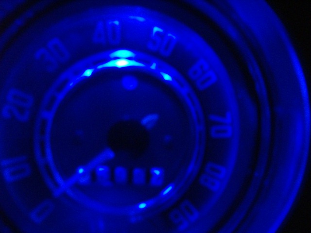

PostPosted: Sun Dec 28, 2008 1:40 pm    Post subject: Reply with quote
Here's a pic taken inside of a darkened garage. Long exposure and a little blurry, but you can see the results.
I plan on changing the others as well.

PostPosted: Sun Dec 28, 2008 4:17 pm    Post subject: Reply with quote
Nice, very impressive!

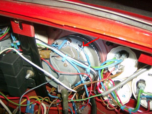

If you dont mind driling a few holes in the back of the speedo there is another option Laughing
I bought some blue led bulbs for my vdo gauges to match my radio (I like matching colors) they were quite an improvement from the regular bulbs. only problem was that then the speedo was white and not very bright. So when I redid the lenses for the signal,oil lights etc I added some leds. only problem was there were no led replacement bulbs for the stock bulb holder
I used standard 5mm leds that I bought off ebay (like 8 bux for 50 with correct resistors) at first I just put in one led where the stock bulb was, but the light wasn't distributed very evenly, so I ended up drilling holes around the back of the speedo and inserting some leds in, simply wiring them to where the stock bulb was wired. Im pretty happy with the results
Painting the inside white is a great idea, Ill have to do this next time I pull the speedo apart.
Sorry for the kinda blurry pics I dont have a super nice camera so taken pictures in the dark is kinda mediocre
