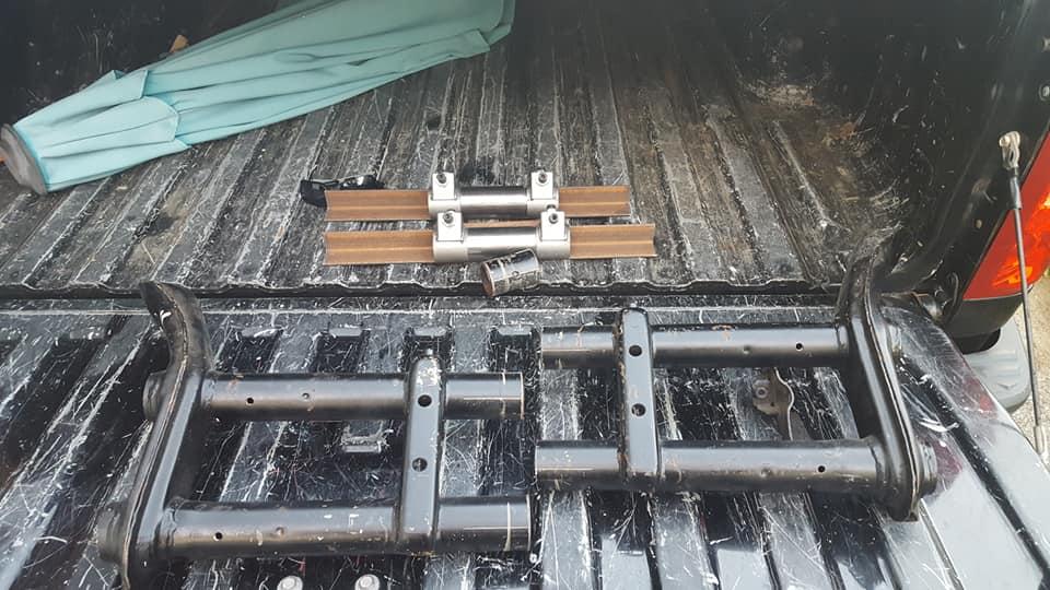

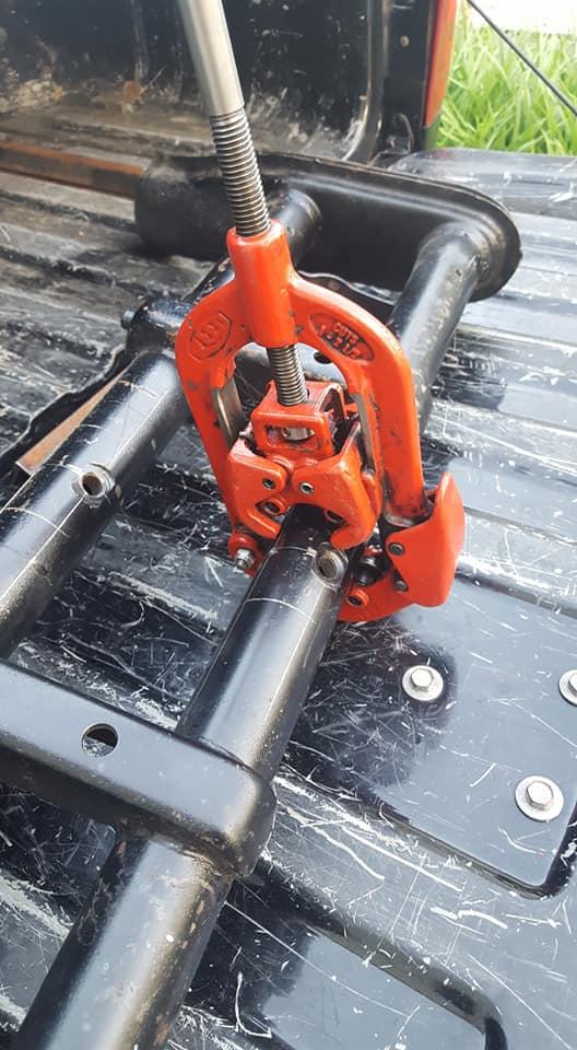

I built my own...
I haven't used it yet, but I used Thing spindles and arms. 4 adjusters and a little math to know where to cut... I also added solid stops "hook and pin" or something as to not blow out a ball joint. I made my own tie rod as well but I'll be changing then cuz I bought a center mount rack.

Did you pre-weld the adjusters to those short center sections, then weld those assy's between the beam tubes afterwards? Or are they just laid loose in those angle irons for these pics?
Also, once you shortened the leaf packs, and installed them into the new widened assembly, what's the best way to mark the springs for drilling the dimples so that the grub screws end up being exactly where you want them on the springs? It seems like if they're drilled too much one way or the other, then either the arm won't close in enough on the torsion seal, or it will compress the seal too tightly. There must be some ideal happy medium, it seems, for proper seal fitment.

Everything was just sitting there loose for a picture. When everything was welded together it was set up on a fixture table & TIG welded together. There are actually short pieces inside each end of each tube & adjuster, so the beam kind of sleeves over the short tubes adding strength to the joint.
As far as the dimples for the screws, I did some math at first for that. Then assembled everything, marked where to dimple the spring packs, & verified the locations for them. Dimpled them, put everything back together & it was perfect. (which was actually better than the 3 other original stock beams I measured out... Laughing ) Any little amount of deviation will not affect it much, as it is adjustable with the camber adjusters. That's probably why the original stock beams are not perfect... One of the first beams I rebuilt stock with drop spindles had the spring pack put in the lower tube backwards & the dimples didn't line up causing one side to be really tight up against the seal & the other side was away from the seal... That showed me how off they are from the factory, & you need to keep the right side with the right & left side with the left, & also the upper in the upper & lower in the lower.... This widened beam came out way better than stock & the seals would be the same, if I had seals on them... Instead I made Delrin bushings/sleeves for the arms instead of using the original seal, needle, & micarta bearings.
