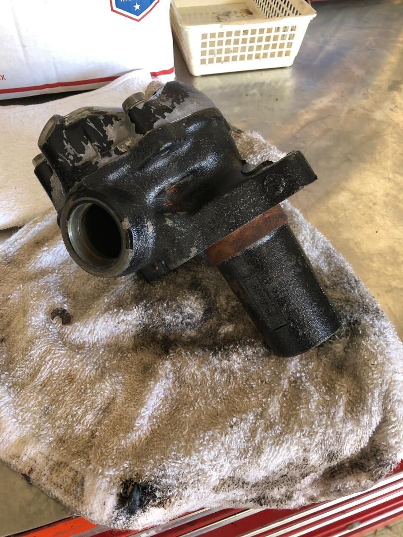

Posted: Thu Jul 25, 2024 1:29 pm Post subject: Re: Steering Box Seal Replacement |
Looking to replace the seals on my early bay steering box. The output seal has been leaking for a bit and wanted to remove the box, clean it, put in new seals and go the corn head grease route. Purchased this box in 2004 as a re-built from Wolfgang.
Looks like both my output and input seals are made of some copper or brass bushing, so I don't see a way to remove these to put in the new seals. I am thinking it is best to leave as-is and hope the corn head grease will not leak from the output seal.
Anyone know of a way to remove the bushing seals without full box disassembly? Or do folks agree to leave as-is and be optimistic the output seal won't leak again after changing to corn head grease?

| Standard rubber lip seals with a comparatively wide metal case. One way to get them out would be to drill a small hole in the metal, turn a sheet metal screw into the hole a couple of turns, and then pry on the screw with a nail bar. It can help to drill multiple holes so you can pry on multiple screws at once. |

Thanks guys, I'll drill and pry out with sheet metal screw or simiilar _________________ '70 Westy

Unless Wolfgang did some voodoo magic, replacing the seals is an easy task once the gearbox is opened up. Pop them out using a large screwdriver or similar tool. You should disassemble and check the bearings. Clean and lube them.
New seals are available on eBay or Amazon once you get the dimensions. They are not VW specific _________________ Lead Mechanic: San Diego Air and Space Museum

Regarding my picture above. See the worm gear? It has ball bearings on either end. The other arm has the peg. It has a double tappers roller bearing. These things jam up after many years. You can pretty easily clean and lube these bearings. Then fill the gearbox with whatever magical lube you can dream up. If the bearings are seized up from old lube, it will cause wear to the peg and result in galling or/and a flat spot. _________________ Lead Mechanic: San Diego Air and Space Museum
