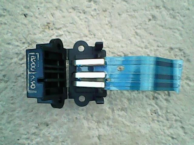

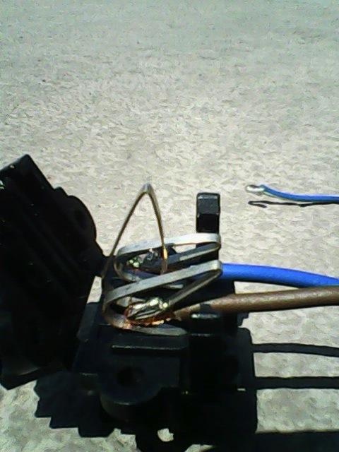

youremyboyblue
Joined: December 01, 2009
Posts: 38
Location: whereever my tdi syncro will take me!
youremyboyblue is offline
PostPosted: Sun Jul 28, 2013 5:35 pm    Post subject: Reply with quote
Hope this helps ...
