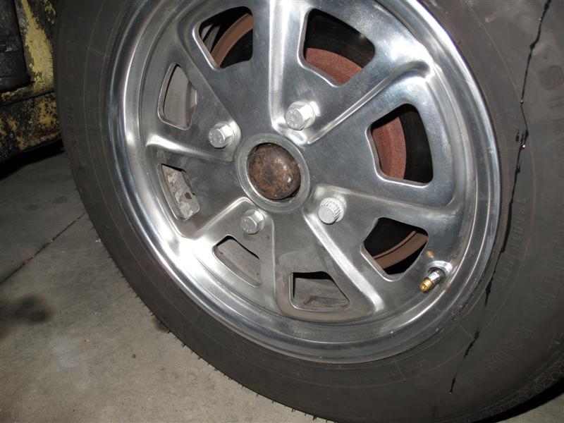

PostPosted: Thu Feb 05, 2009 11:47 pm    Post subject: Mounted "RAD" Bolts on 2 Liter Porsche Reply with quote
Here's a couple pic of my new bolts mounted up.
I also got the plastic covers that are not on.
I'm very happy with these products.
I also got to meet the owner of RAD USA and got to chat with him some.
RAD used to be an OEM supplier to Mercedes.
They make the highest quality wheel hardware that I found on the net. Where else can you get class 10.9 wheel hardware? I don't have any ties with RAD. I just want to let you guys know what I found after all of my research.

PostPosted: Fri Feb 06, 2009 3:41 am    Post subject: Reply with quote
Good work. Atleast you researched and know the difference. The RADs are good OE quality metal. People often put undersized ball seats on Porsche wheels and it's just dangerous. I sell the lugs below to 914'ers. I had to have them made because no one would make lugs with the full specs, plus chrome. I added a sidewall to the seats and a finishing lip.
The blank section in the threads is not critical. It's just Porsche's way of being gentle on your bolt holes. People often go really cheap on bolts with undersized ball seats and then torque them to 80/90lbs on alloy rims.
Note that Porsche lugs also came in 25mm IF you were running the plain steel wheels. The metallurgy is also different on the 25mm lugs because they were for steel wheels. Porsche parts and specs are often like Bosch parts. They cost a little more but it's more than worth it.

Glenn wrote:
Porsche bolts, part number 914 361 315 01, are 38mm long while Vw bolts are 25mm long.
This pick was A big help to! seeing the too lug bolts side by side so I could see the ball seats are the same.. Thanks
