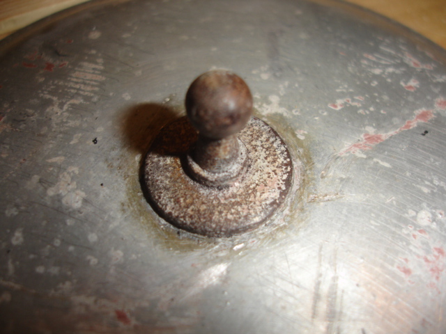

Getting down to the details.....anyone have pictures of an original exterior mirror? Does the mirror have a part number stamped on the ball as the later mirrors do? I am specifically interested in 55 BD, but interested in earlier examples as well.

No part #'s on the pin/base. I would take pictures of the ones I have, but I suck at zooming with a camera.

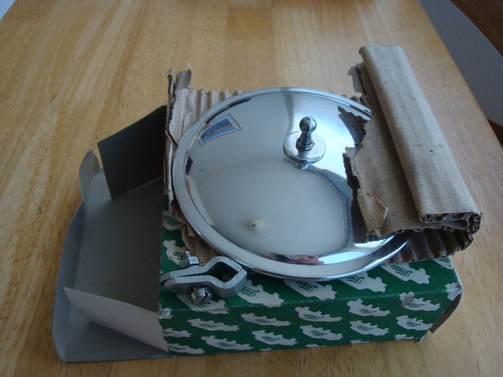

My NOS Barndoor mirror for my Deluxe was made by Freese,and has no logo or part numbers at all,the outer edge is very flat and I am told by all those that know the correct Barndoor parts,that this is the correct one!!!!
Also the mirror arm clamp is different to the later clamp,I think all Wolfsburg buses used the same clamp,they are alot sharper in the shape that goes onto the mirror arm....

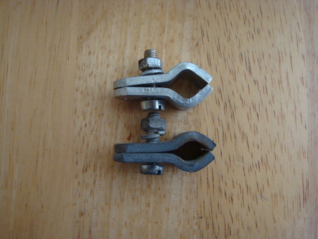

What is the difference in clamps? I looked at 3 early number-free mirrors and they look the same. I am still searching for other clamps in my parts. Any photos of the early clamps?

If I can remember, I will take a picture. But they are bent differently? Bent in more. Kinda like Linda's booty? Does this make sense?

Here's what came off my 55......
So which is correct? I have some NOS clamps as well.....need to pull those out tomorrow to add to the confusion.

Ok, here's what's came with the 55 BD
How long did the large lip continue???

Yo Doug! As far as I know, what Everett Barnes lll posted, those are BD clamps. Most unmolested BD's have those style of clamps. I saw a BD in Sweden and one in Poland, both wear beat down like Linda's Booty, but they both had the mirror arms, clamps and mirrors. Both had those clamps. And other og BD's have those clamps as well. But, you know how VW utilized what ever they had!!

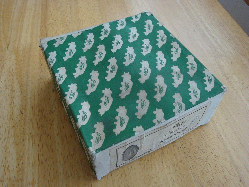

Recent purchase of an NOS Frese mirror. This is considered by most to be the correct Barndoor-style mirror
http://www.thesamba.com/vw/forum/album_page.php?pic_id=519980
http://www.thesamba.com/vw/forum/album_page.php?pic_id=519979
http://www.thesamba.com/vw/forum/album_page.php?pic_id=519978
http://www.thesamba.com/vw/forum/album_page.php?pic_id=519977
The above is the Frese clamp versus a later standard Bus mirror clamp. Note sharper bends, as discussed earlier in this thread.

I thought I would jump in here with some printed info.
The first 2 pics are from Happich catalogs. The first pic is from a 1953 catalog. Note there is no 'dome' shape to the back of the mirror.
The 2nd pic is from a 1956 catalog, note the newer shape.
The next pics are from a 1952 Frese catalog. The refer to the VW Transporter as a VW Schnell Laster.....don't know why they did that because the DKW was a Schnell-Laster.
Note they list the mirror diameter as 105mm, and the part number is different to the Frese part number on the box above.
The Frese catalog doesn't show any pics of this mirror.
I also have an NOS mirror, not sure what year it is though. No part numbers on it.
