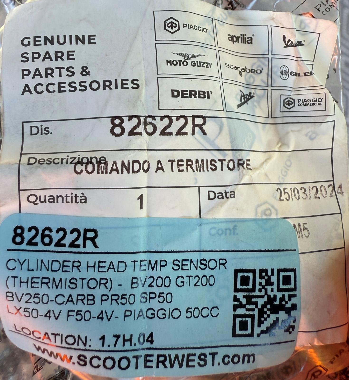

Of all sources... would you believe VESPA?!
I can't swear the temp range and values are identical, but some report having success using this part.
I like the connector instead of the Bosch pigtail, since it lets you use a regular socket.
Plus the brass may not corrode as quickly.
And a steal at $20 shipped!
https://www.scooterwest.com/cylinder-head-temperat...RDa9Sf8o97

Actually....that should work. It may not be spot on when in the middle ranges between cold and fully warmed up....but at cold and warmed up it should work fine.
This site has the values in C°.
https://www.pedparts.co.uk/product/505/piaggio-eng...85adf_qYki
It's negative coefficient so it's workable.
68°F= 2500 ohm
104°F = 1300 ohm
167°F = 380 ohm
212°F= 100 ohm
There is a question as to how much the resistance rises as it gets colder than 68° and how m7ch it drops when it gets over 212°.

I just ordered two of these.
Has anyone tried this in any VW FI application? And if so, how many miles?
The Bus Depot one I put in lasted about 5k miles when it failed on our way home from a weekend getaway today. I had an old one that had been rattling around in my tool box for 20 years....it's had tools thrown on it, sure it was rained on several times. Put it in, and the bus ran great...idles better now than it has since I put the engine in 4k miles ago. I had another used spare (bus depot) and I've got another new one in a box at home. Like everyone else, tired of these things failing. Suppose I could put a potentiometer in it, and manually adjust, but it would be nice to find one that works.

I received the Vespa temp sensors in the mail yesterday and installed them that evening. Took it for a test drive, and around town it was ok, but hard acceleration or cruising above 55 mph caused bucking. Might have been able to dial it out with the AFM, but not that desperate yet.
I used thicker wire (believe it was 14 or 16 gauge) for the pigtail than was expected, not sure if that would have impacted my results vs using something like 20 or 22 gauge.
I might try a thinner gauge pigtail, but right now, I would say my initial reaction is that this won't work for buses.

It's just a resistor. It happens to vary over temperature. At the lowest resistance (hottest), the ECU doesn't weigh the reading much, so I doubt it is the source of your bucking. In the few cases where the hot resistance gave too much leaning, a fixed-value resistor has been spliced in series to bias it up a bit.
