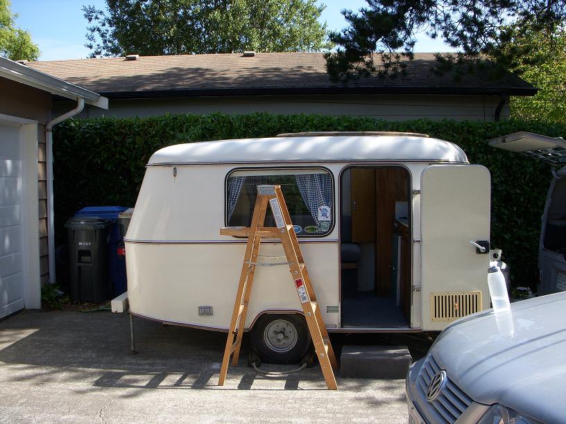

Here's a quick pic of mine to help kick it off:
If somebody will post up model year production info, changes etc...that would be extremely helpful.

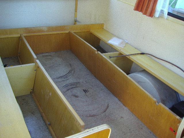

Been working on my Puck and even hitched her up for the 1st time in about 2 to 3 years and tested her towing. Getting it ready for camping this year. Bearing job seemed to do the job. I did not drive super far but no signs of grease coming out anymore. I have a feeling past owner just did not seat the seal proper and it was on the outside of the axle hub instead of inside. Anyway, so far so good.
Gave the Puck it first bath in like 25 years. Was last registered 1979 by past owner and the guy that sold it to me on behalf of the PO wife I think just hosed it down and clean pigeon poo off it <grin>
Need to paint my 10" rims and get her mounted on those soon. I am riding the little 8" wheels and tires that the previous owner put on there. They are basically new but I wanted stock 10" so that is what will happen.
Removed propane tank and hoping local propane place will replace whatever is needed on it so I can use it again. I need to sand that down also and paint it.

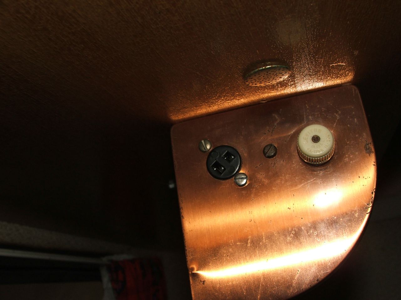

Tinkered with inside lights. Back one works, front one does not. New bulb did not help. Will tinker more later.
Lots more to do but it is usable now. Need to do pop top material sometime and some body work to remove scraps and some dents if I want it to look real purty.

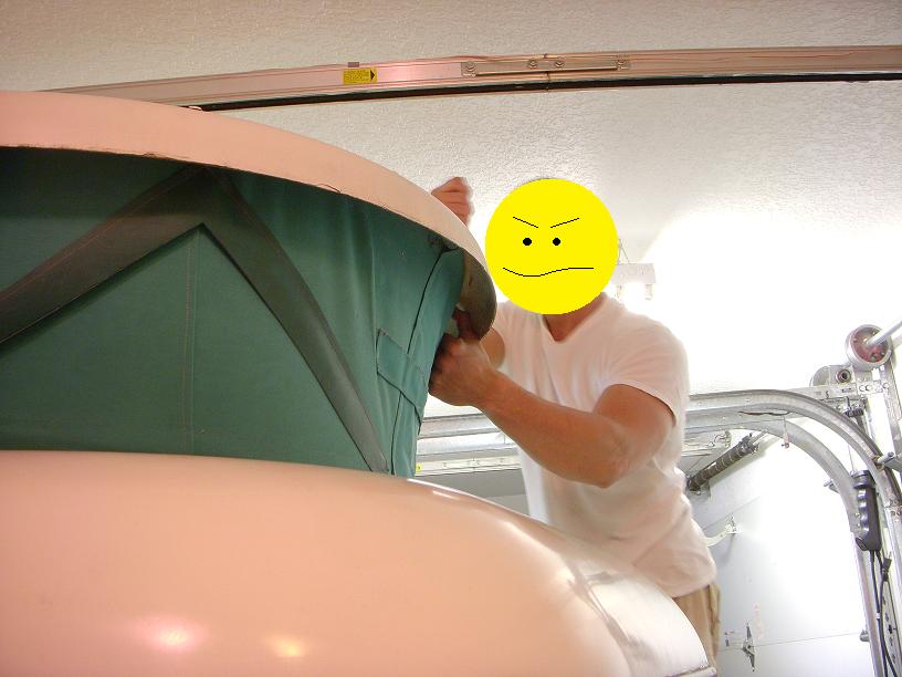

When are you going to do the pop top canvas? Just to cover what I told you via pm:
I will say that the top is no fun if you plan on replacing the material. We went with a Sunbrella material, very durable. My wife is into sewing so she did all the measuring and cutting. A tip from her would be to get enough extra material just incase, not too much, but maybe a foot extra or so. The biggest tip I have is to MARK the front of the dome and the frame with FRONT & BACK! Trust me on this! Ours is currently backwards and when popped up it looks like it's leaning forward a little. Also mark which hinges are front and back. They look the same but ours has a slightly different angle to them.
Top off:
Brittle insulation under the headliner material
New waterproof material from local boat/canvas place: (will work on my cutting ability Laughing )
The reason my wife suggest adding some extra material to your calculations, note the extra patch on the front: (added note, she still did a great job Wink )
finished product: we'll fix the reversal issue this spring

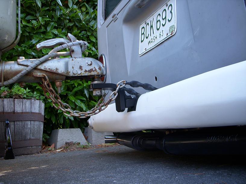

Here are some pix of my hitch set up. Since my bus is a little low I decided to cut through the bumper and have a receiver style hitch. My bumper was/is roasted anyway so I didn't mind a little cutting. I know, I'm a hack. Wink
boxed in bumper brackets, receiver style hitch set up. yes the weakest link is still where the set up mounts to the bus, but this is definitely strong enough for a 660lb. puck. I added tape around the hole to finish it off for now, until I fab a plug for when I'm not towing.

PostPosted: Thu Mar 19, 2009 8:24 pm    Post subject: Reply with quote
Any of you Puck owners have this small black outlet on the side of you rear light? Maybe some special 12v DC outlet. Looks like it has 2 prongs. The opposite side has the 110v outlet so I wonder how and what could connect to this left side? Some special 12v goodies. Wonder what kind of adapter would work on this?
